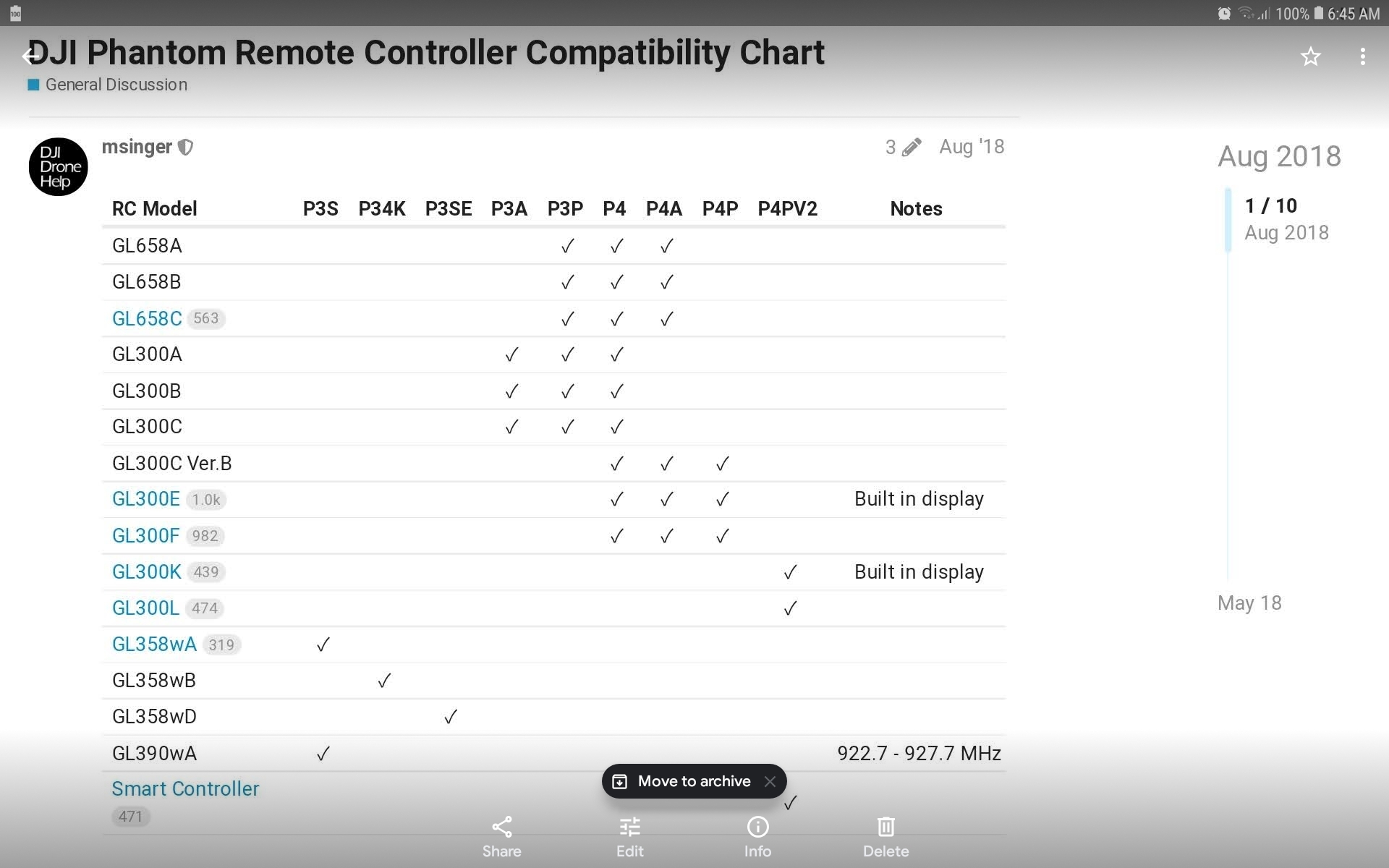

Gentlemen, I need some assistance from the brains trust. Recently put my P4PV2 into the deck and it’s on its way to be repaired. My question is can I connect the 300L to a P4PA+. I tried several times today with no success. Your assistance is appreciated
Regards
OK OK, I should have known better. Need an F model not an L.
Regards
Here's a chart for future
