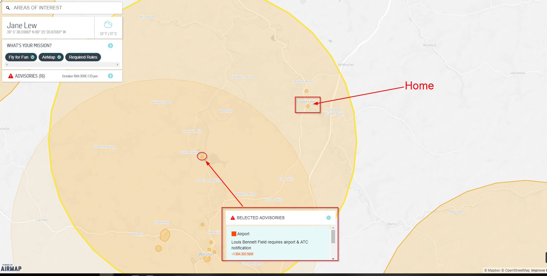

so below screenshot shows my home area, and then an advisory about an airport, the airport it is saying has been closed for prob 15 years, there has not been a plane housed on it or landed on it in that amount of time, there never was landing lights, or even ATC at this airport
I called the number on the advisory and they confirmed that the airport is officially closed, so am i good to fly here without calling anyone else?
also, there is a hospital located further southwest that has a landing pad for Healthnet helicopter to come in and out of (this is not there homebase)
also, lets say that this was being used, does everyone call everyday to let them know that they are going to be flying there drone?
You tried to call so that's due diligence. You should be good to go, just keep your eyes open as always. I would call back and record the message just cuz I'm a little paranoid about people that know just enough to cause trouble.

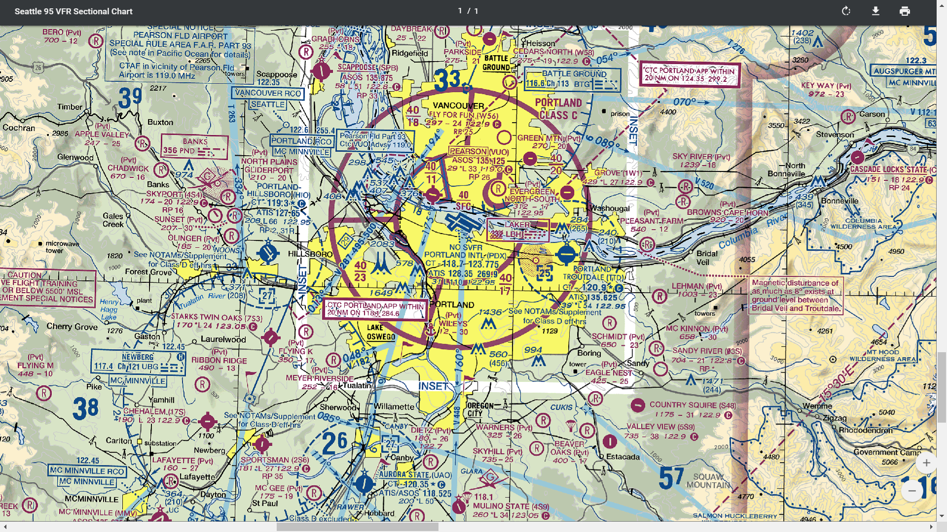

Here's a close up of a sectional chart of the area you're talking about:
And if you want to decode it, here's a guide:
FAA Aeronautical Chart User's Guide
Right off the bat, you can see that there is restricted airspace, most of it with a floor of 700ft, around the active airports- check out the guide to see what additional restrictions apply in your area. From what I can tell Bennet is in Class G airspace and you don't have to call anyone.

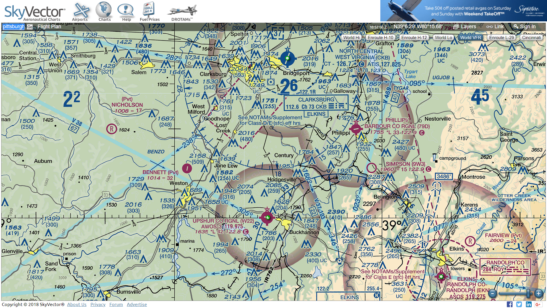

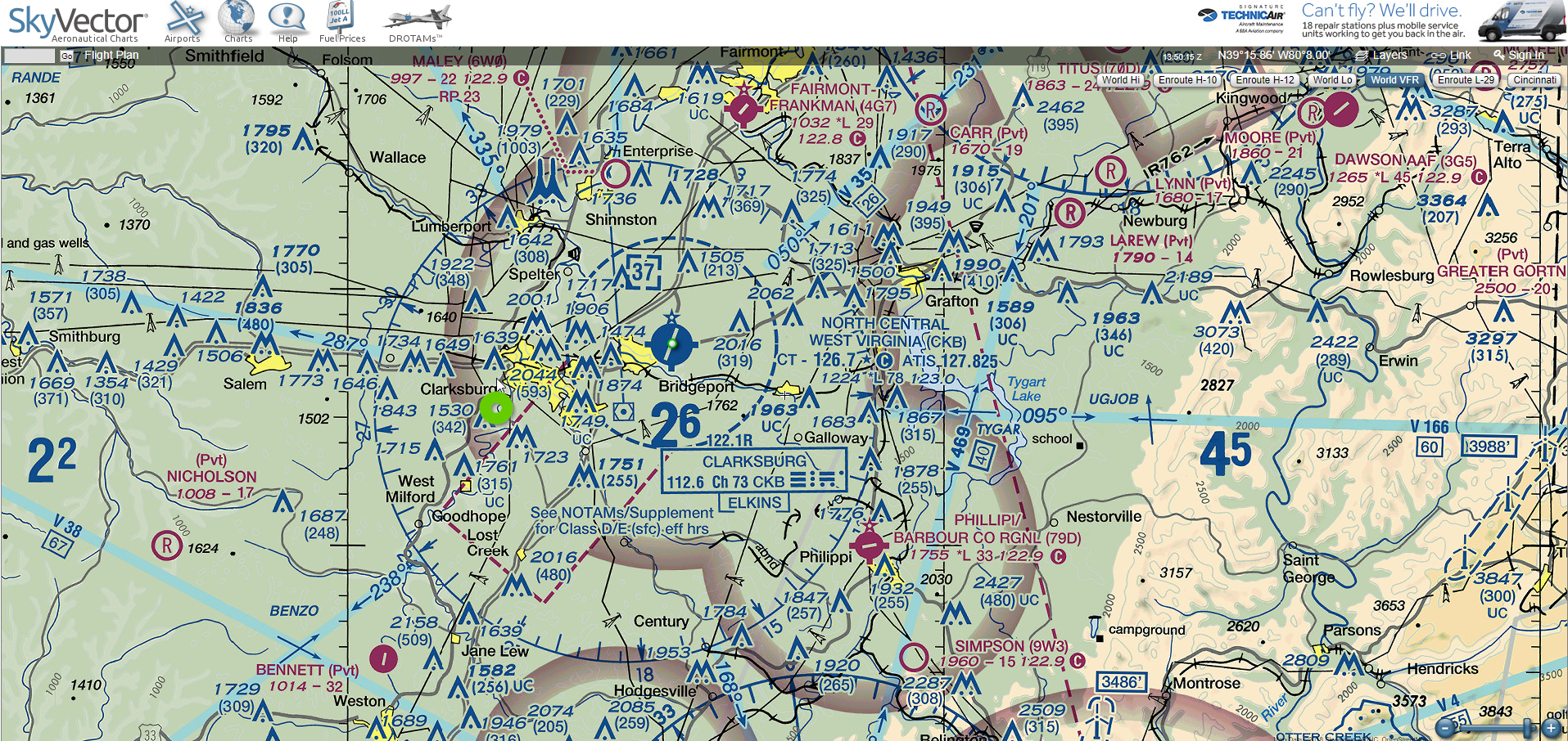

just wanted to try and understand this a little more and make sure im on the correct mindset, so in my screenshot below, if you look at the green circle i put on the map, lets say i was flying there
from what i have been studying and trying to learn on the airspace, this is class E from 700 up, but below that it would be class G? and im not required to get permission in Class G
Im trying to learn this stuff lol
Yes, the Class E floor is at 700 AGL inside the shaded magenta area and your green circle appears to be in the Class G below that, if at less than 700 AGL So no permission needed. Part of the green is in, part of it is out of the shaded area. Which leads to my next paragraph.
Nitpicking, the magenta shaded area is a transition area as there is not a fixed, zero width boarder between 700 & 1200 AGL areas, demarking the change of the Class E floor. What is the width of the transition area ring? No one seems to know although the FAA will have it in their database for each ring. What airspace are you in if you are at 1000 AGL in the shaded area? Wish I knew! :)
