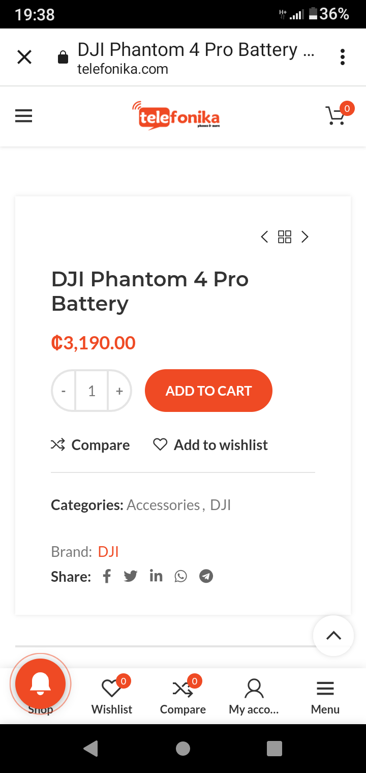

That is a screenshot from the link u sent me. You can see the amount in my currency which for a teacher whose monthly salary is no where near that amount how do I fund this purchase.
