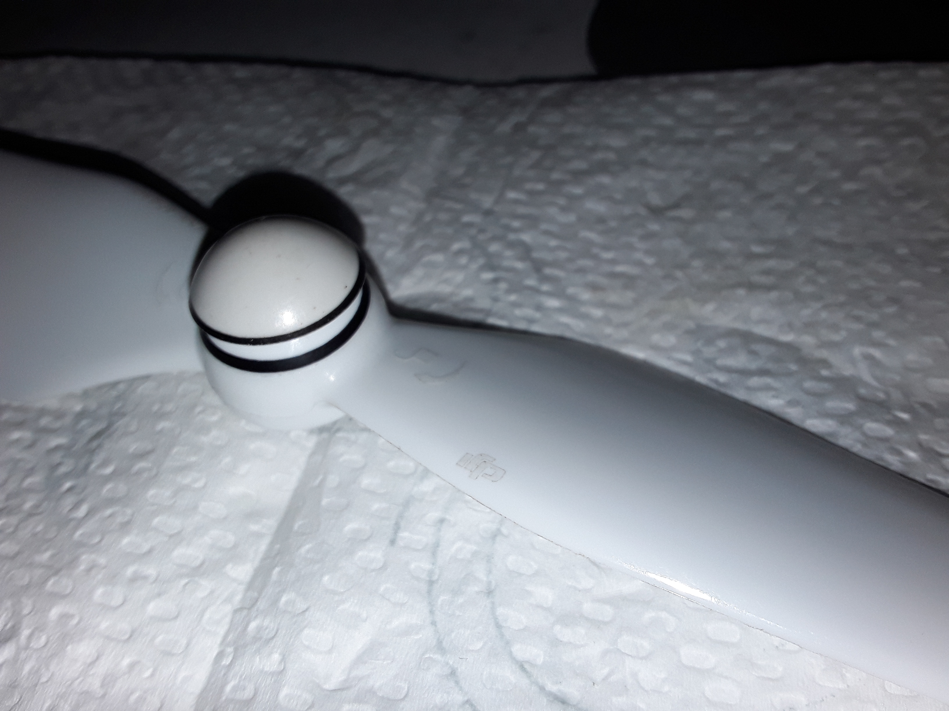

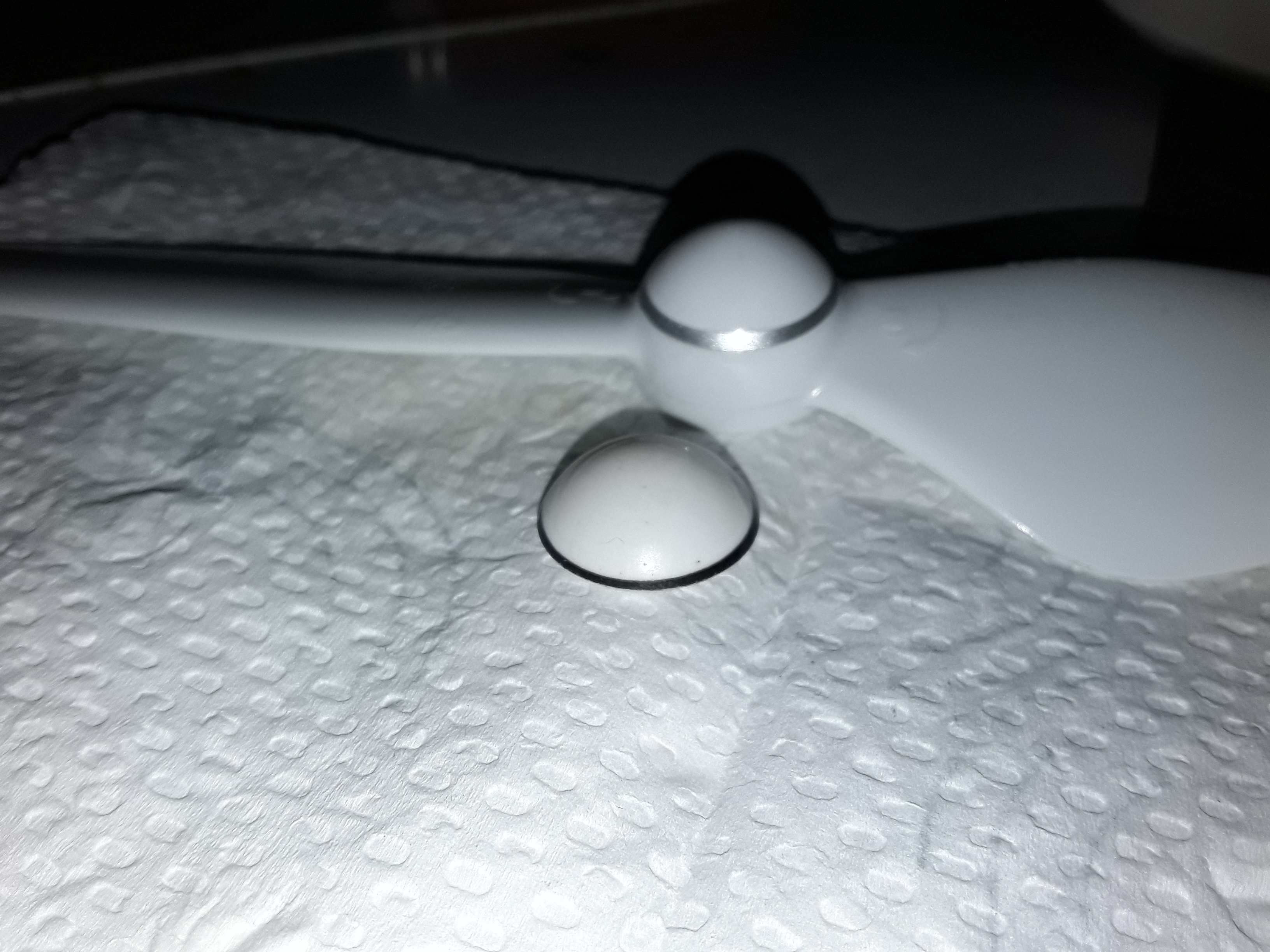

See the damaged prop in the attached photos which show its two ends. This is the only prop that is truly beaten. Structurally it looks sound except for the tips. Would it be okay to fly with this?
I had the almost exact experience you did and I blamed it on me trying to fly on a windy, gusty day. My P4P would sit there with the props spinning and the moment I tried to take off, the drone would flip on it's side and beat the props on the ground. I did a little research and found the the problem wasn't the wind at all. It was because my IMU needed calibrating! As soon as I did that, my P4P took off fine on any windy day and never tried to tip over in the slightest. Check your IMU calibration. It worked for me. Then you can test it with your old props just to see if it will lift off the ground. Make sure none are cracked anywhere, especially at the hub. Don't do any serious flying until you replace your props.

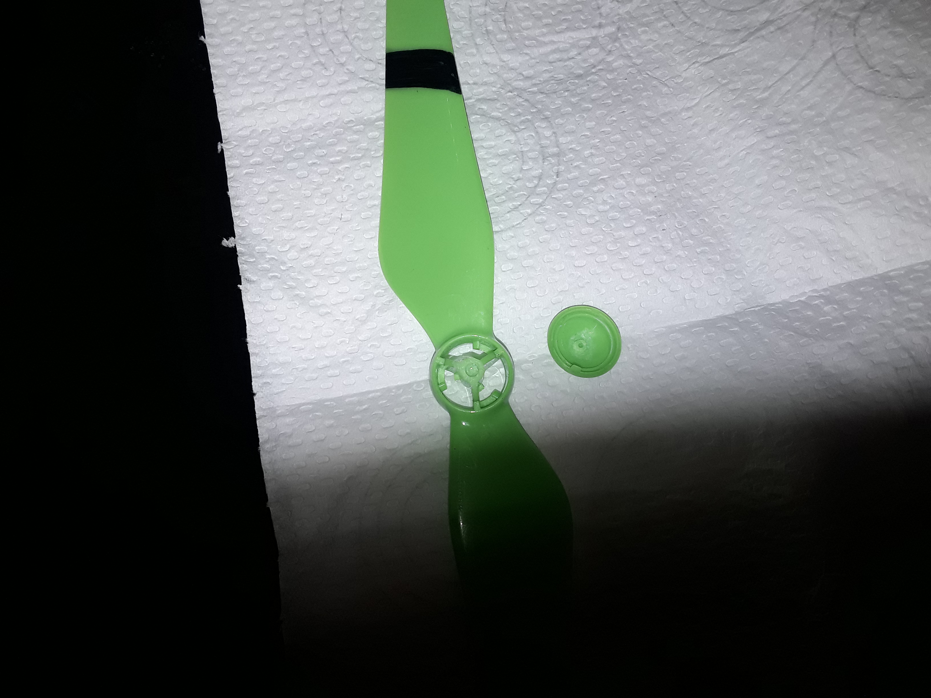

Yeh for sure,,1 set mayby but not 2,,that's why I mention early about seeing if it locked on opposite prop lock,I did accidentally do this one day when I replaced the tab locks on motor,instant tip over and broke a prop,,what a idiot but rookie moment lol,,,now I know what black dot for on prop locks,,,duh,,its to match the prop colour,,stop laughing now ! @RPP post some pics so we can see aswell what going on,,,I know the top of p4 props comes off,,mayby they stuck the wrong colour tops on wrong props,,,do they have leading edge going the right way ?
This is what I try to explain.all phantom 4 props do this and wonder if wrong top colours got mixed up..these cheap spares had small amount of cheap glue,,,,I discover this when some flax Bush caught my prop and tied me drone up(flew to close) and the white phantom top was missing after that

This is what I try to explain.all phantom 4 props do this and wonder if wrong top colours got mixed up..these cheap spares had small amount of cheap glue,,,,I discover this when some flax Bush caught my prop and tied me drone up(flew to close) and the white phantom top was missing after thatView attachment 120178
Interesting! All the more reason to stick with the genuine DJI props!
They do it aswell,,yes genuine dji 9450s,,,mayby someone in factory not happy with their wages and seek revenge by switching tops lol......see I not really crazy
I would smooth out the tips and you should be fine. My concern would be balance. Whatever you do to one rotor you must do to the opposing rotor.
