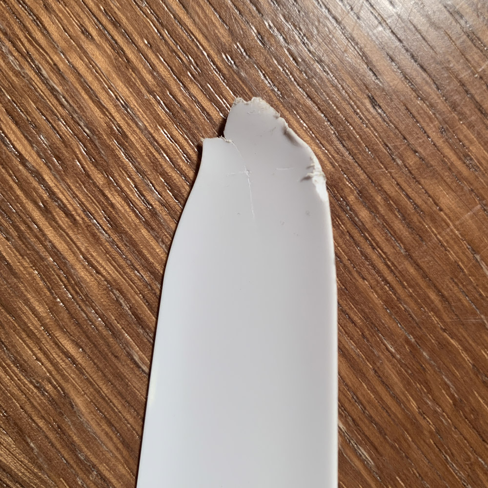

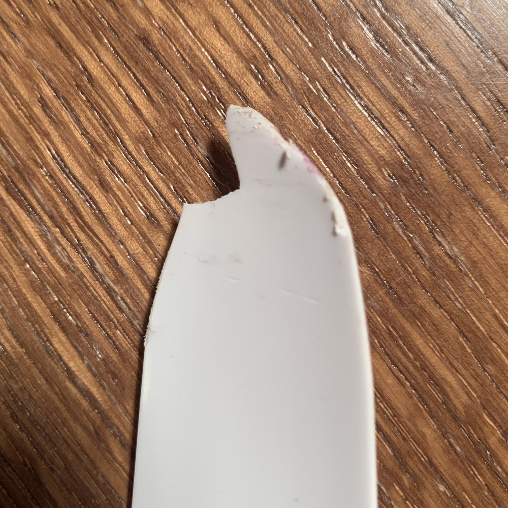

See the damaged prop in the attached photos which show its two ends. This is the only prop that is truly beaten. Structurally it looks sound except for the tips. Would it be okay to fly with this?

Sorry to hear about your damage. I think most of us have been there before (especially in high wind). Personally I wouldn't fly with those unless I absolutely had to. If a client was paying me and push came to shove I would risk it but only if the reward outweighed the potential financial loss. Sorry again and best of luck.

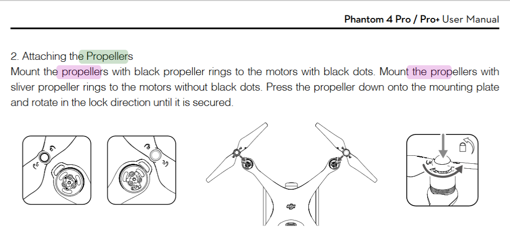

Have you lined up the right propellers with the right motors, I hold the barrel of the motor while turning props to lock them
Oh yip I heard you scream. Have you compared the new prop lock to the broken one,,can you see any visable difference,,mayby post a pic of 2 side by side,,,,just out of curiosity does it lock on the black,,you might be able to stabilize the broken end with bit of tape but I wouldn't put it through any hard maneuvers or it might snap,,balance issue of unwanted vibrations might occur even trying this

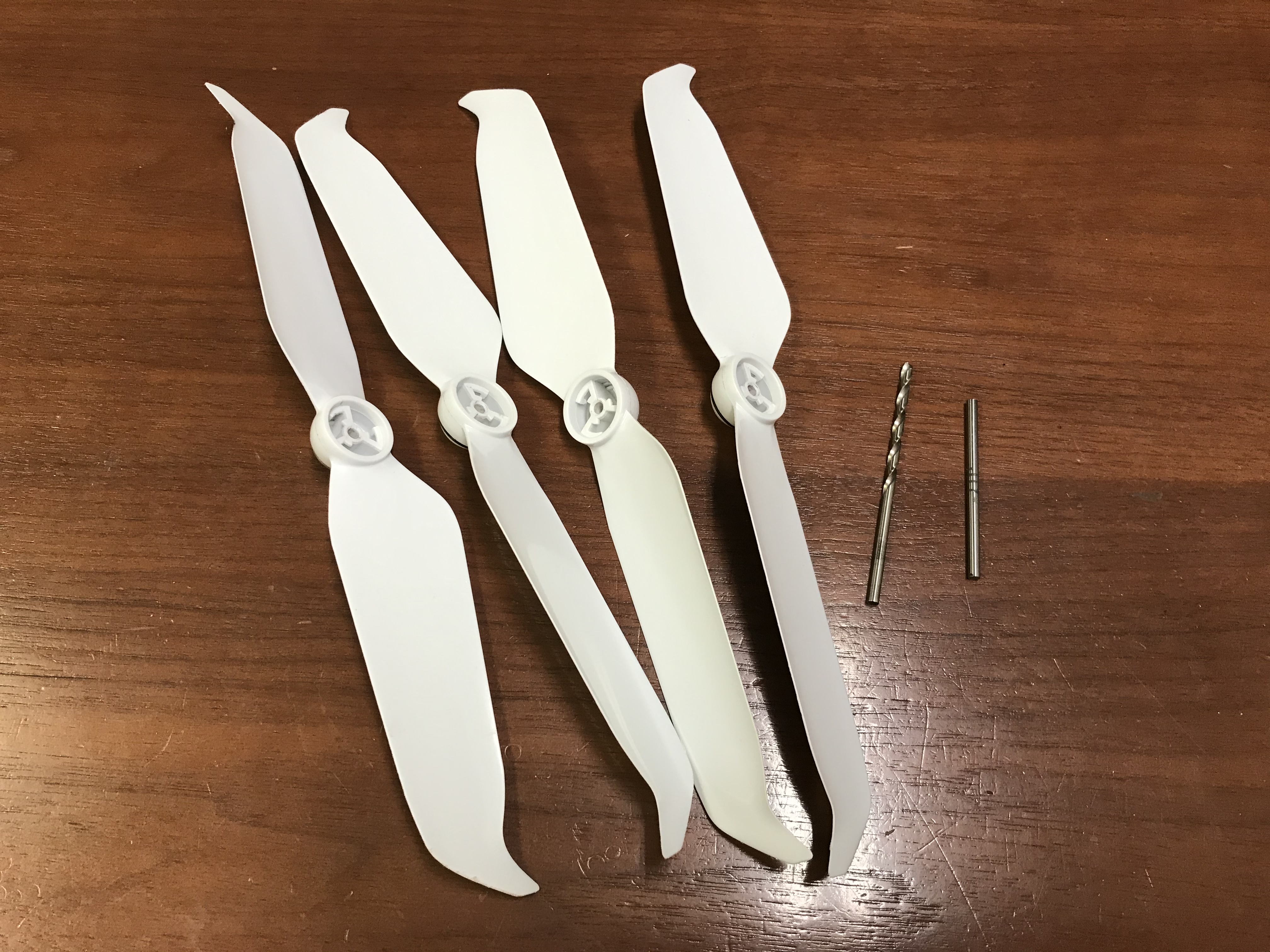

I have just run across the first set of DJI phantom props that I think have a problem. From what I can see, there looks to be a difference in the molding process between these that don’t lock and some that I have that do lock.
Look very closely in the hole where the motor shaft goes into the prop on both sets, new and old. I think the motor shaft does not go in the hole far enough for the twist lock system to engage because of some extra material in the top end of the hole. This material seems to not allow the prop to seat down far enough to engage the twist lock.

I have just checked a different set of props. They fit.
These don’t have as much of the ridge inside the motor shaft hole as the ones that won’t attach. My opinion is there is a molding issue.
I will attempt to ream the ridge with the appropriate tool on the bad set and report back.

I don't think the flying with such can be a problem. A slight disbalanced maybe. Only I would not fly a very long flight.
When you put it up se a few sec how it behaves. If it can't hold the position normally Then I would not fly.
Pay attention on the locking part of the propeller if the propeller is not fit the same as other three. And of course any damages around the locking part. If not then OK.
But even if it fly normally change the prop as soon as you can. And avoid the strong wind.

I would NOT fly with any damaged props no matter how minor the damage. The damage in some cases may seem insignificant but you'll never know if there is unseen stress damage causing an unseen weakened area of the prop which may fail while in flight. Damaged prop = garbage, period. It is not worth risking UAV or safety for the need to fly in any case. This should be a good heads up for us all. When you get delivery of new props, check them right away so you are not stranded somewhere. Just my humble opinion.
Reactions: R Martin
You may be able to fly but I would limit the amount of time if you really have to fly. the imbalance will cause problems with the motors and additoal vibrations may effect you photoes or videos and shake other parts loose. If it was me, I would replace the Props. I always carry a spare set.
