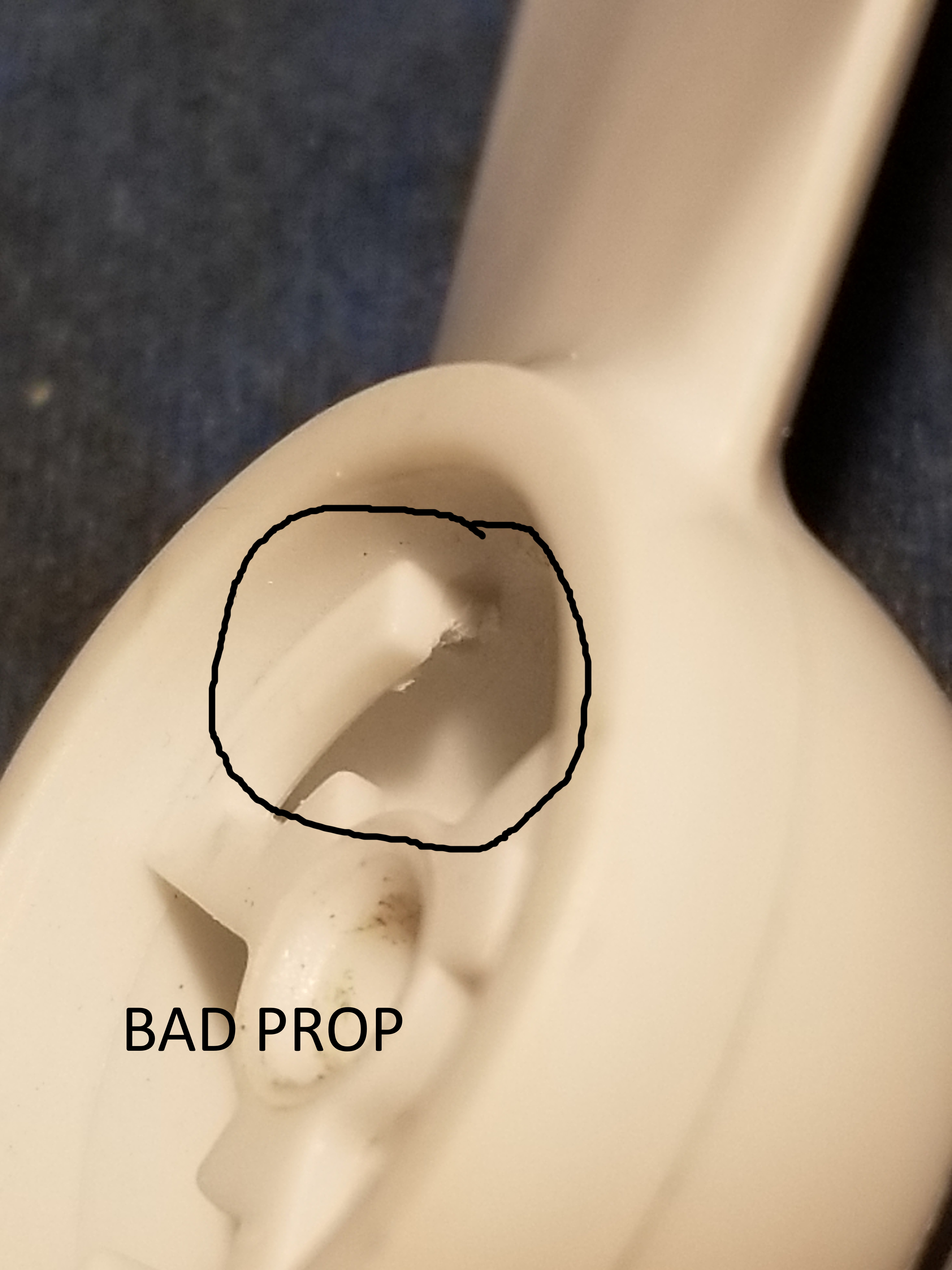

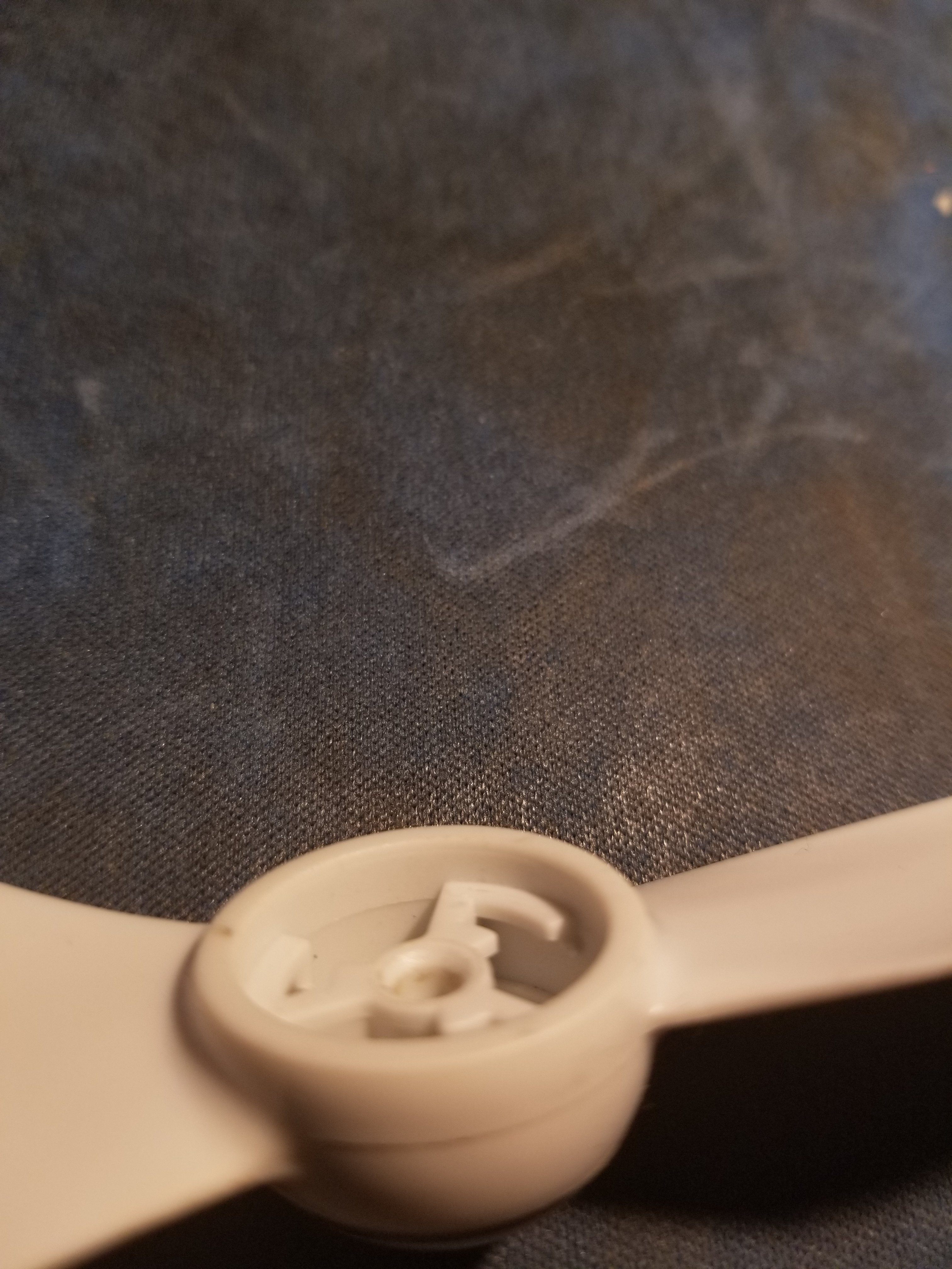

Today went out in backyard for a little flight and after landing I was removing props and noticed a small white piece of plastic fall on motor housing. First think I looked at was the Prop Locks on motor and all seemed good. I then looked at each prop and found the broken piece. This could of been worse than just being out one prop if it had gone UN-noticed. Check the inside of your props, this could cause a prop fly-off in the air.

Sheer luck ianzone, lol, But I'm thinking that it was just maybe got sloopy slowly through time and end up with stress breakage as ianzone mentioned above, but also they were the original props for the P4. I even put it back on and would of never noticed a difference and would of flown, if I hadn't seen that small piece fall. It was sheer luck seeing it.That is why I brought it our forum so everyone will check. I've seen post of people claiming the props flew off in flight before and of course crashes, this could be one cause. But only guessing.

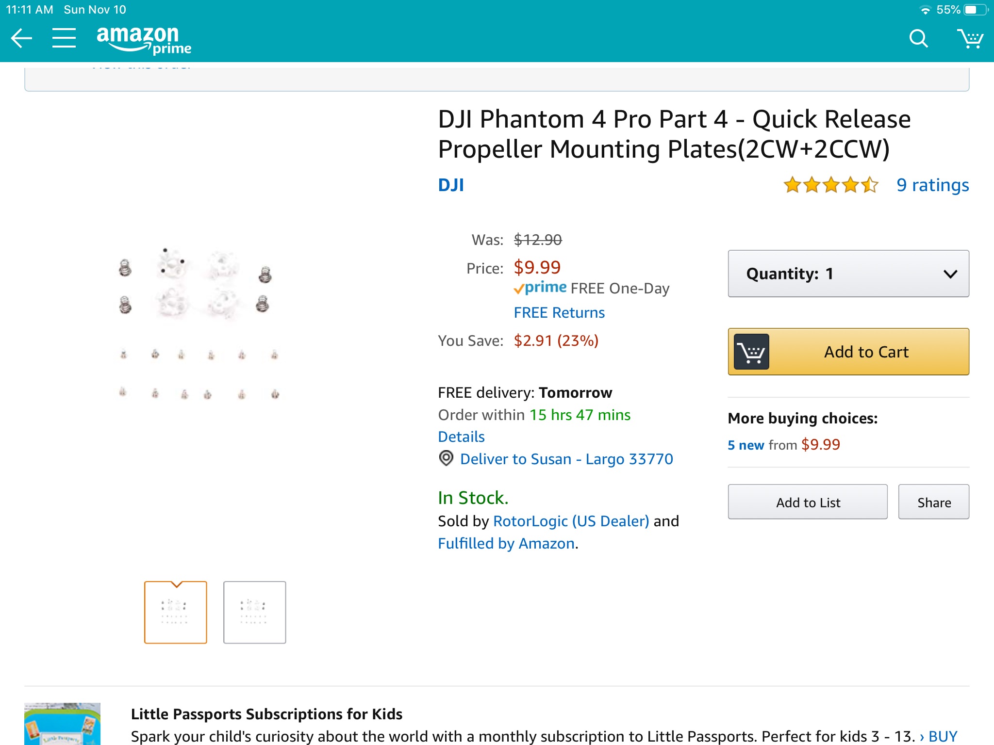

Are you using the original P4 prop locks? The kind with the external spring instead of the new design with the internal spring. If you're using the original, please switch to the pro model prop locks for $10 Amazon. It will save you a lot of grief in the future.
The original P4 prop locks were a poor design that was quickly dropped in favor of the much better Pro design. A lot of P4’s were lost because of prop failures. Glad you caught yours in time! Stay with OEM props too.
Good luck, fly safe.
PS: Pro mounts allow use of Low Noise props as well. From experience, they will fly off the original P4 mounts.

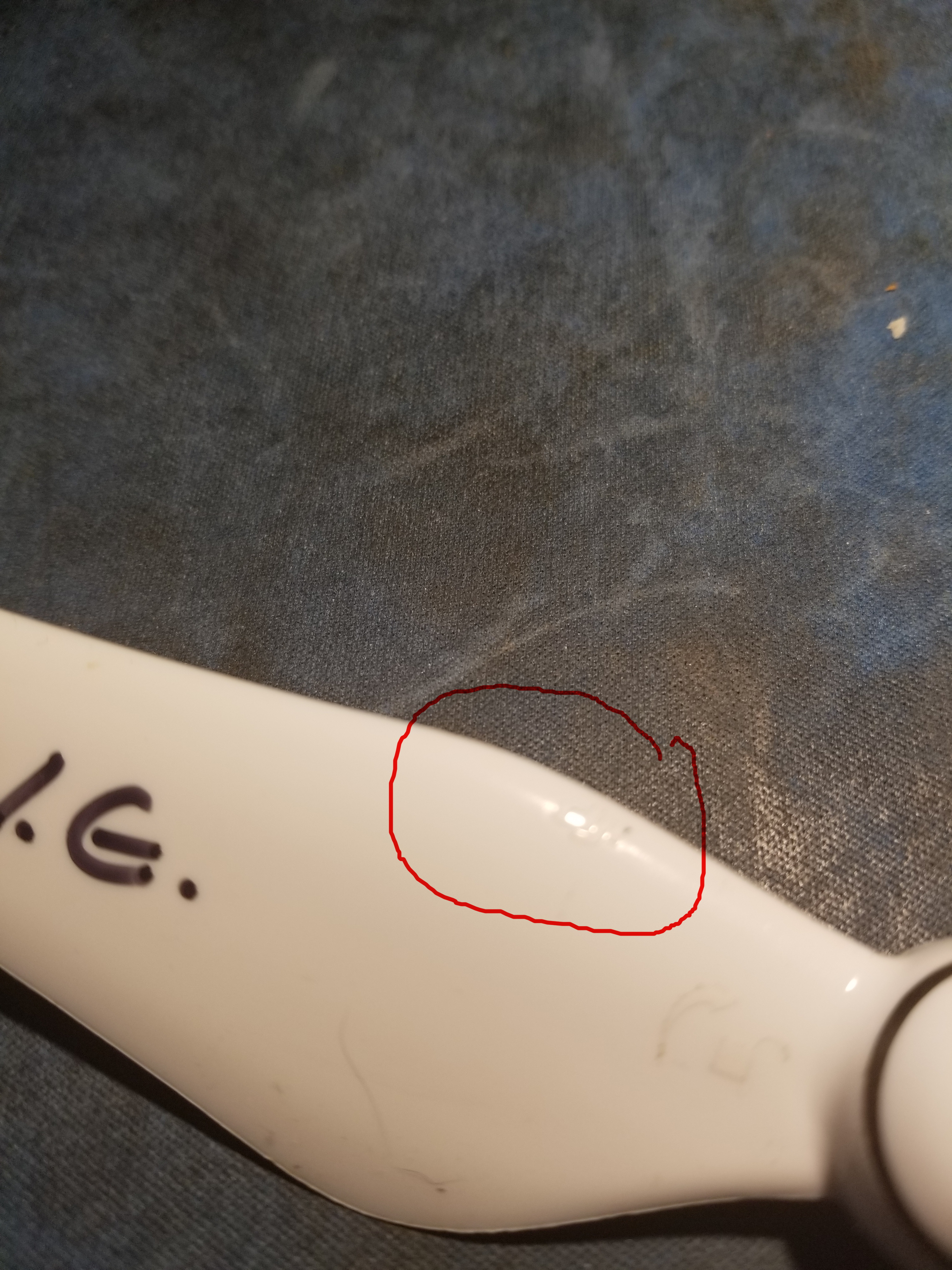

Do you have an opinion on how that piece was damaged?
Does it look like 2 different brand props to you? Bad one looks aftermarket? If so, that’s my opinion. Lol
Whatcha think Cadbob, aftermarket 3rd party props maybe?

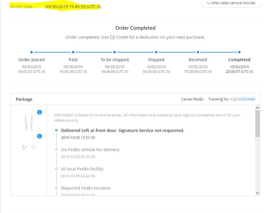

I’m using the newer spring props locks and they are definitely the original props that came in box. I do still have the extra props in the little black DJI bag and also 2 sets of the newer quite props. This is why I put it out there to check your props. After markets I would of never posted I would of chalked it up as my fault instead of stress wear.
Yes purchased straight from DJI awhile ago. :) I only buy straight from DJi for parts! You never know what your getting! lol

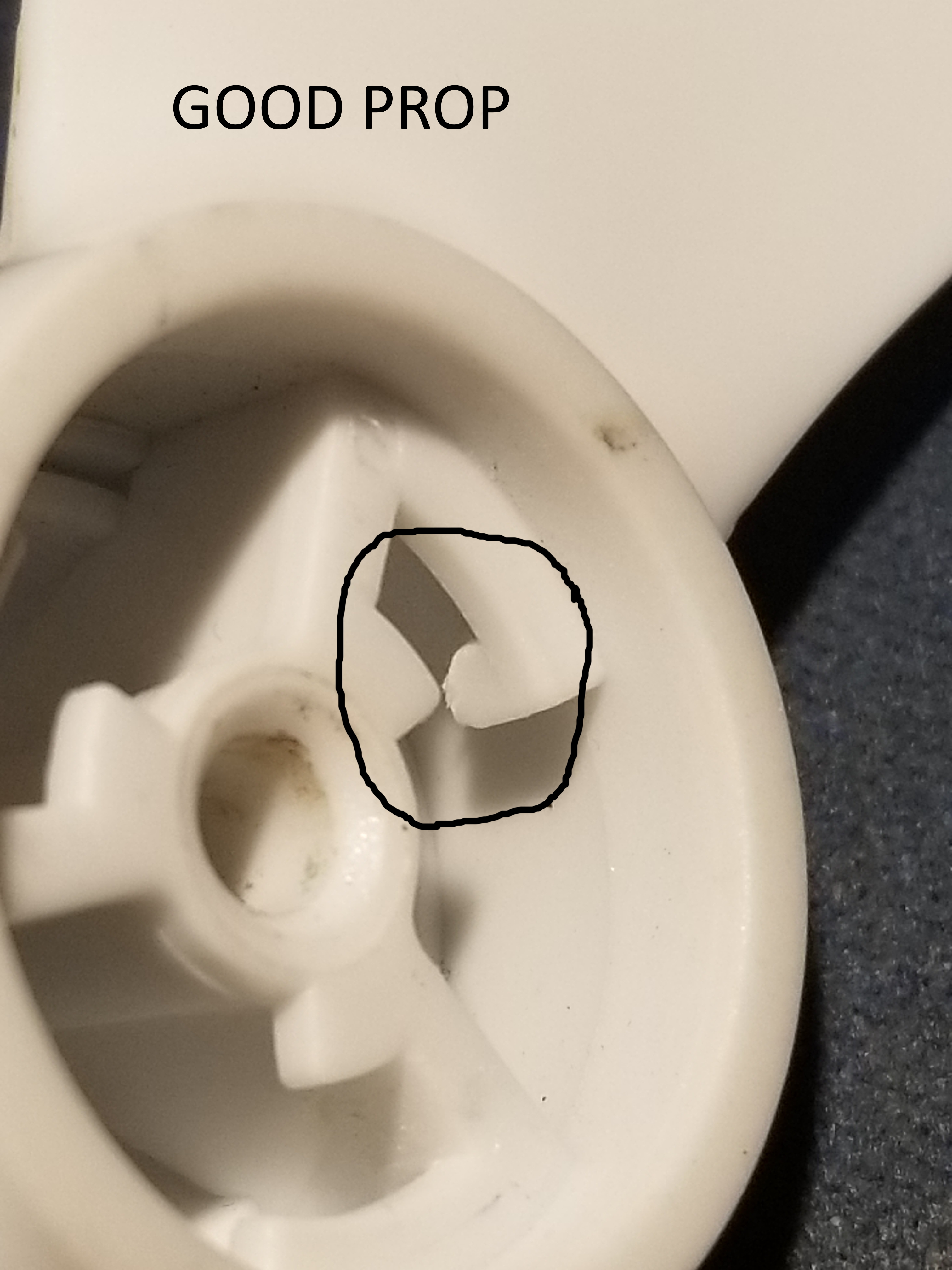

In the picture my text on picture is misleading the same prop hub just one of the three locks snapped off

Make sure they are OEM props. Dollars to doughnuts, they are not.

While this is a good idea, keep in mind that both props that failed DID pass ground inspection. Neither prop had any nicks, dents or scratches. They both mounted positively to the hub. So buyer beware that a comprehensive ground inspection does NOT insure an aftermarket prop won't fail. So far, I've not had a single OEM prop failure.
