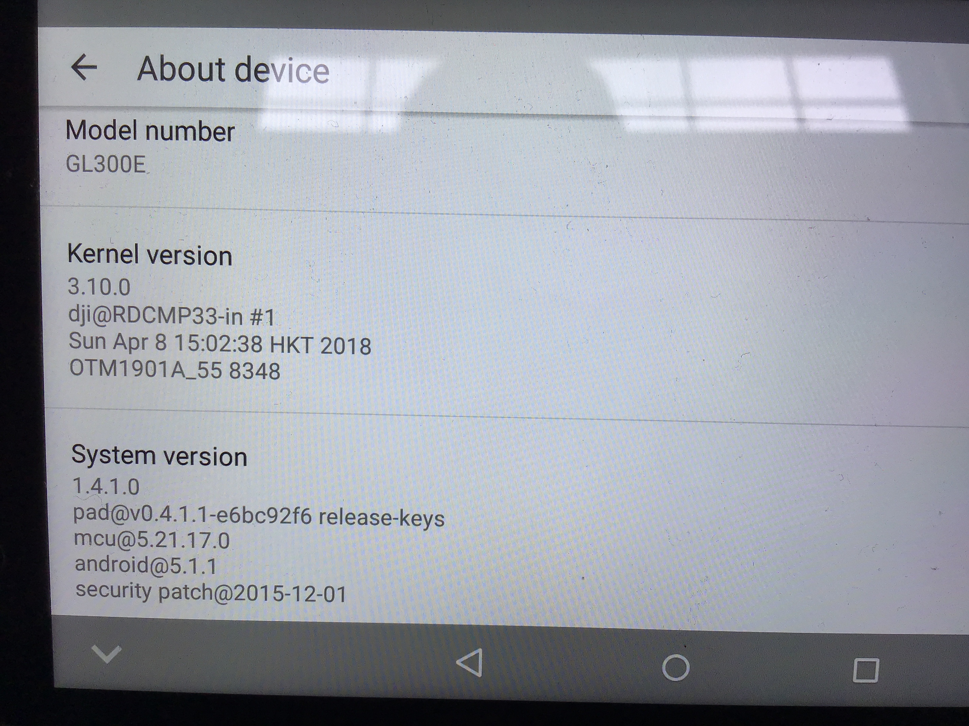

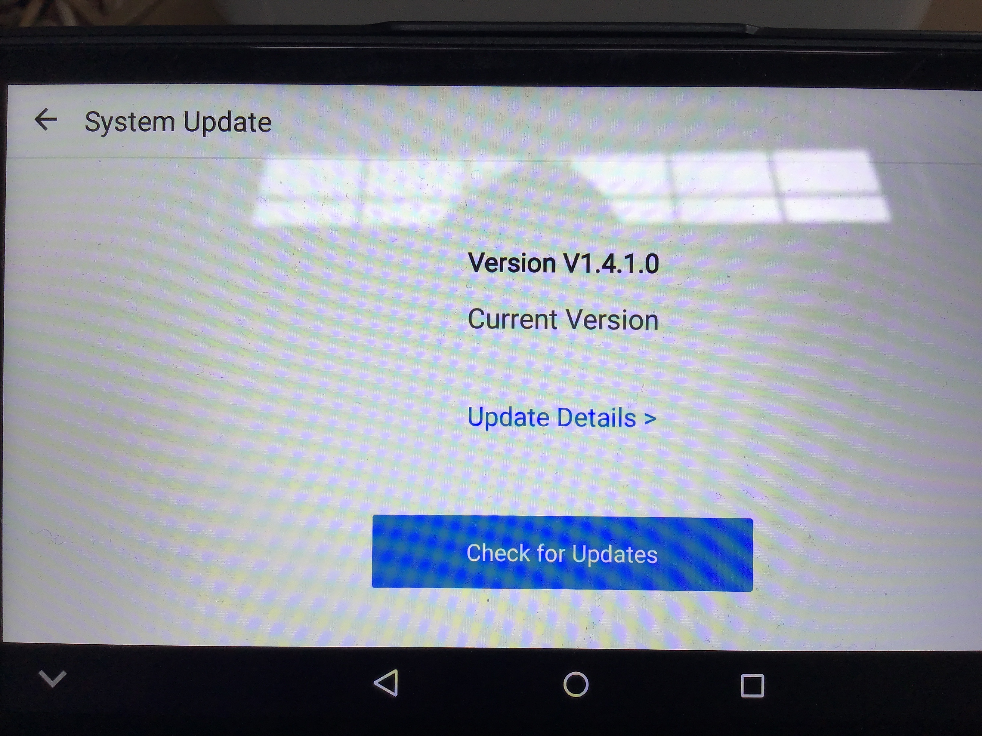

I have a P4P+.
What versions of firmware and software do you have?
I'll compare.
Check the remote “System” version again.
Mine is showing 1.4.1.0 as current.
