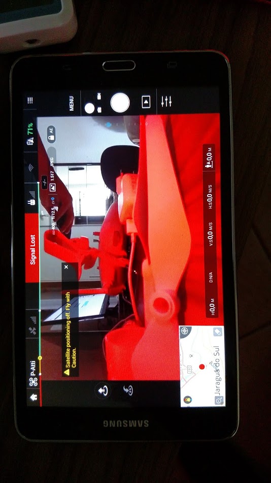

My Phantom 3 control does not appear more than the battery level. It does not appear the load lights, it must have given firmware problem when I updated it. I left the video attached and the photo. The control becomes signal lost.
Connects only no wifi and a camera appears. Commands do not work. If you notice how lights that show a battery charge are off
I guess your controller could be faulty, but I'm not a a pro at this yet so maybe theres something I'm missing. you could try downgrading the firmware.
