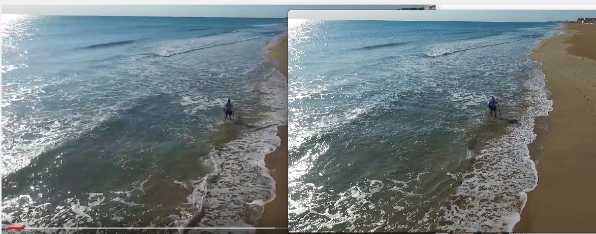

    Screen Shot 2016-03-03 at 20.53.02.png Unfortunately videos on youtube loose clarity.
    When I compare my uploads to the original file, its chalk and cheese.
    see this screen capture, youtube on left and video on right through media player.
    uploaded at 1080p

  9. Ed209
    Jul 27, 2015
    943
    431
    Yes, I know that. But even just comparing some P3P footage vs P3A footage in similar conditions the P3A looks worse...I don't know...My P3A isn't for shooting quality so I'm not gonna waste effort trying to figure it out. I know it shoots fine it's just the YouTube compression for some reason with P3A videos.
