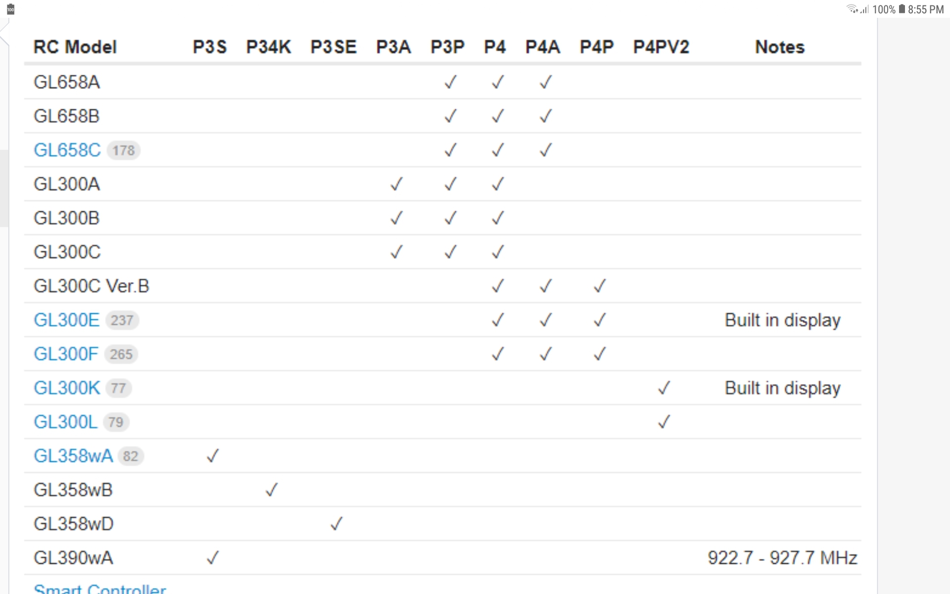

Hi, I am new to this forum, 1st time posting, I would like to know if a Pro 3 controller will work with a standard 3 drone, I managed to loose my pro 3 to the fishes and can pick up a good condition standard 3 unit but only want to buy it if the pro 3 controller will work with it. TIA
Welcome
Awnser is NO, p3p and p3a remote is lightbridge and p3s is wifi,,not compatible ,,,bummer about losing it
