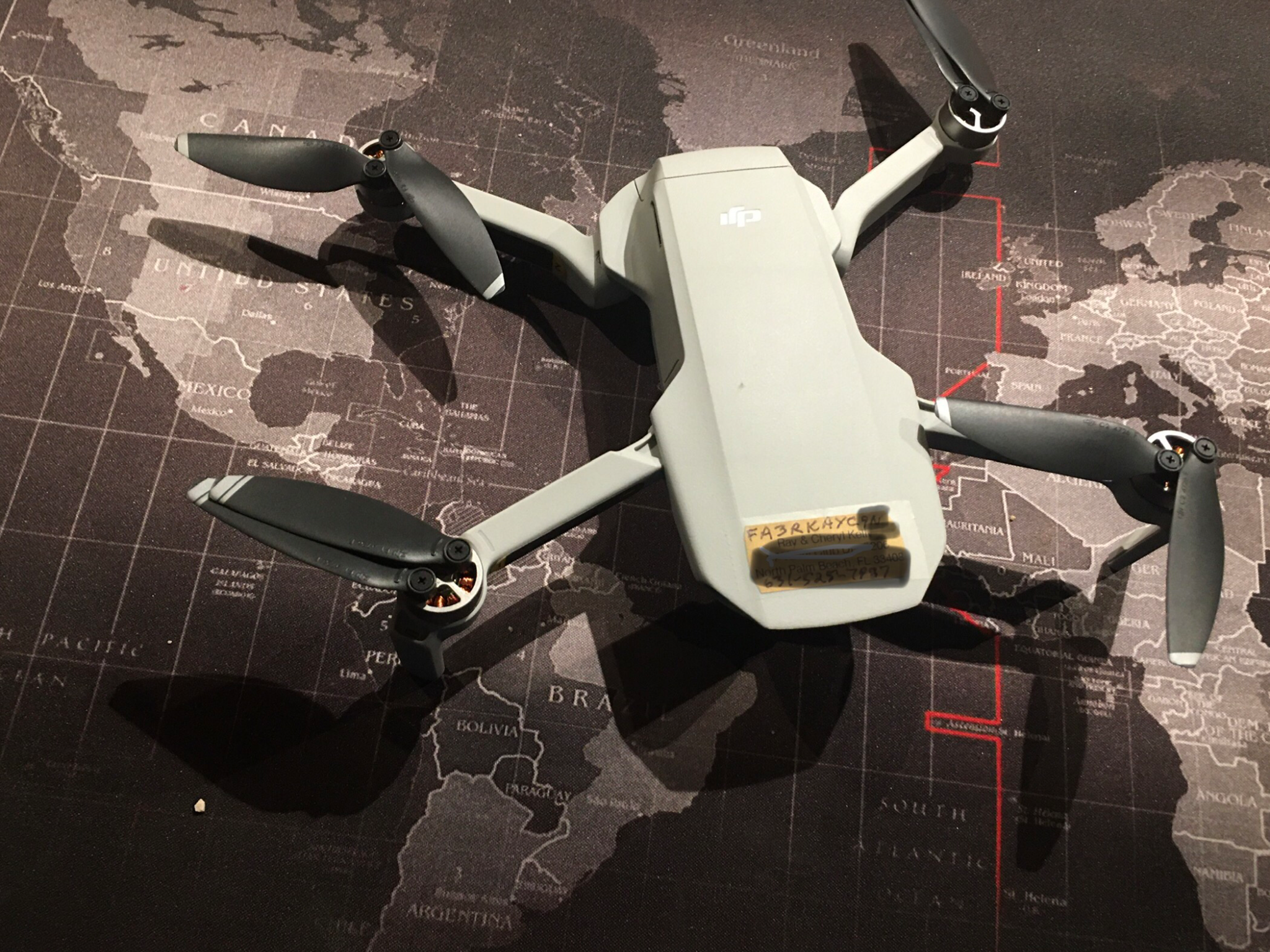

Glad you got the sand out. I had it happen with my Mavic Mini so far so good with my P4. Luckily my son was able to dislodge it. See photo.
I now always use a takeoff/landing pad.
Glad you got the sand out. I had it happen with my Mavic Mini so far so good with my P4. Luckily my son was able to dislodge it. See photo.View attachment 118324 I now always use a takeoff/landing pad.
