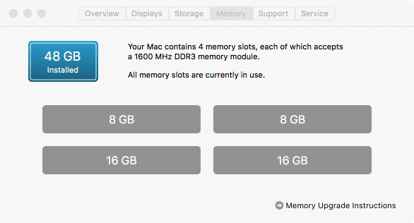

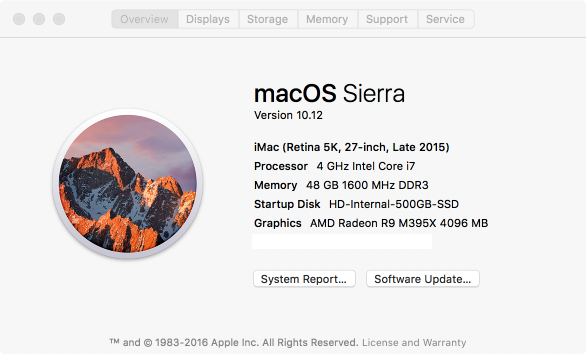

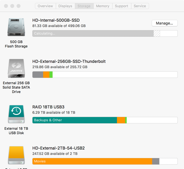

5k iMac, Late 2015 with 4GHz Intel Core i7
- 48GB RAM (2x8GB, 2x16GB)
- 500GB internal SSD, 256GB Thunderbolt External SSD
- 18TB Raid 5 Array (USB 3)
The best part of having a 5k screen is that 4k content can be edited fullscreen as 4k content without the need for transcoding. Another good alternative for 4k editing would be to have dual monitors at least one of which is 4k (for the same reason - not having to transcode the video during editing). I've been using iMovie for now. After using it for about 8 months I've discovered that it's a lot more powerful than people think. Many of it's options are hidden away in non-intuitive places. After reading this thread, I'm going to give DaVinci a look.

I Didn't realize the I Mac could go this high with Ram. I have the same system ...HmmmmTime to go find more ram.
48GB????? Holy crap!! I remember when they said 2GB would be enough for most programs... lol... (yea, I'm old...)
