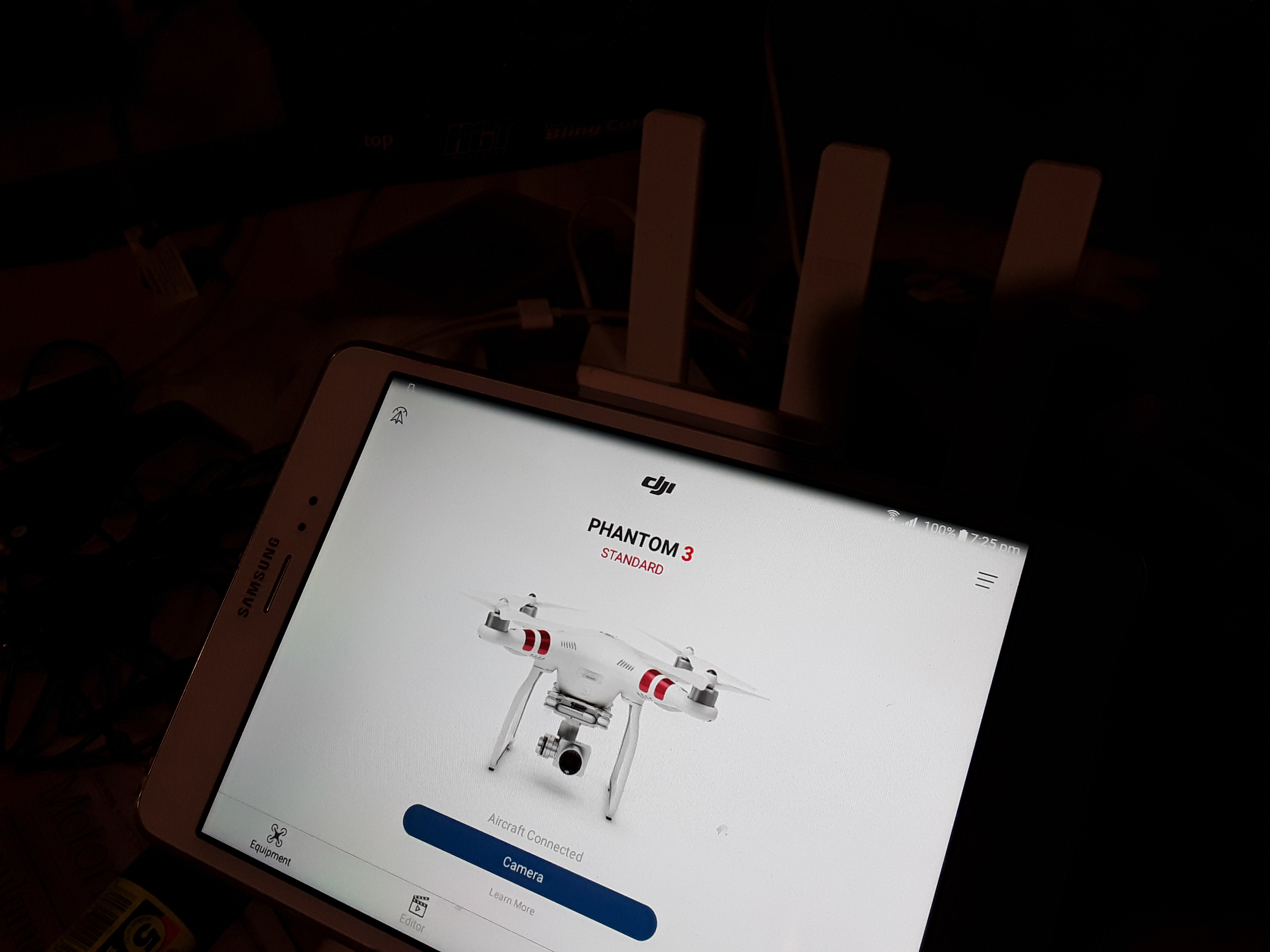

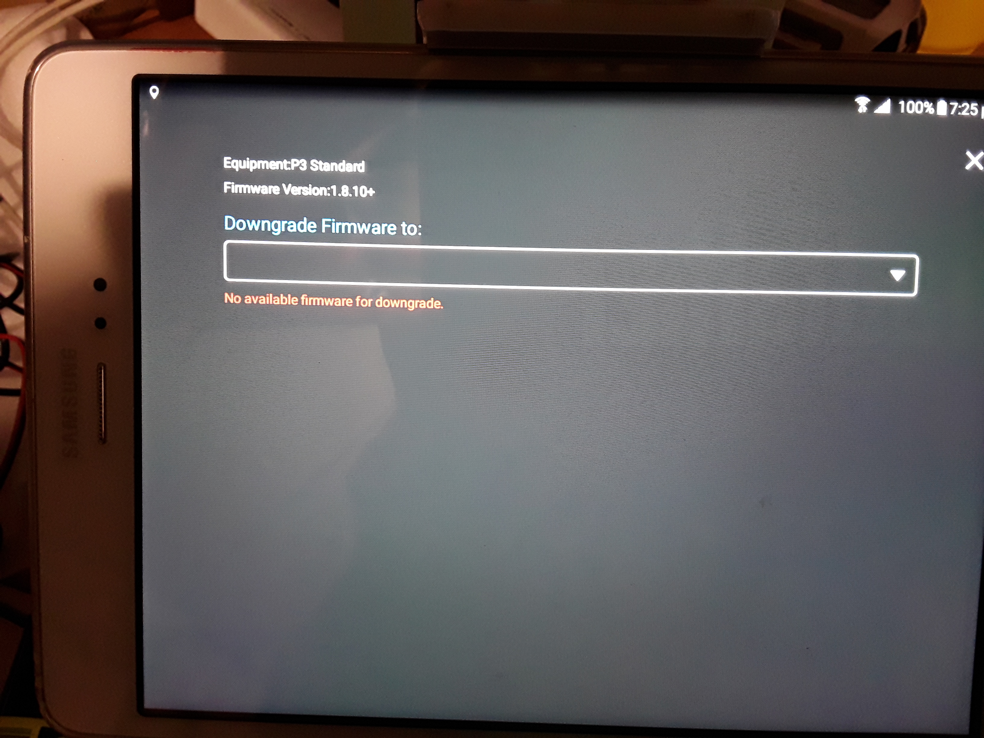

OK how come you downgrade and why unplug camera, couple questions,what colour your lights,all of them,gimble light drone rear lights and remote. Could try delete zip file from device and uninstall djigo and then reinstall djigo,that should give you a red prompt if firmware needs doing but will come with latest app from playstore or iTunes,,get home screen up and press and hold those 3 black lines top right of screen then you get screen like bottom picture with firmware versions,(this device not show because no internet,was just for pic) but when conected 1 or 2 versions come up,(can't remember),unless you know which does what playing with firmware can get nasty,I avoid it at all cost,,,,,mayby someone who knows bit more about roll backs etc can add to this,-----mayby if you can post a vid of what happens at start up,,be watching and thinking, best of luck

My DJI Go doesn't give me the option to select a firmware like your 2nd picture shows.
