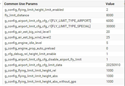

2. Consider using Drone-Hacks.com to adjust flight parameters. I believe the hack for eliminating the REV REV (auto pre-load) upon motor start is available in this product. This can mitigate wind tipping during take-off. You can also adjust the motor idle speed on ground down to 50% or lower, which makes the craft virtually silent when powering up the motors, until takeoff. These hacks are easier with P4P V1 with 1.3.509 firmware, but I think the drone-hacks.com product will allow these two parameter mods also.
Identifying the proper parameter description is a chore. These below are my changes, but this is only allowed with 1.3.509 firmware. Some of these are available with the Drone-Hacks product.
3rd option- have a second person Hand Hold the drone overhead by holding the bottom of both landing gear.
Startup, let it do the REV-REV thing and give it power. As it starts to pull up your helper releases the landing gear and you give it more power to counteract the wind. It works.
