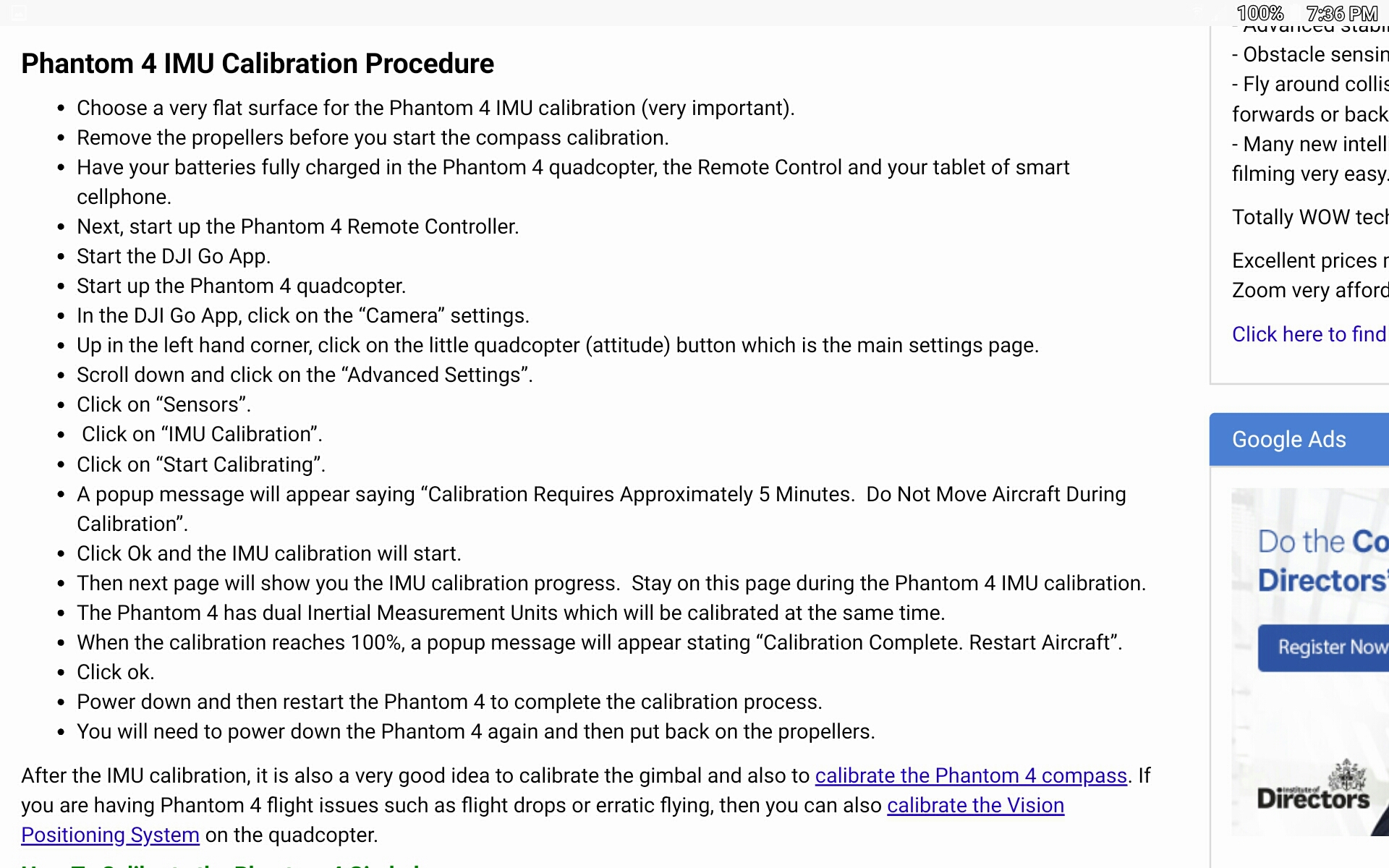

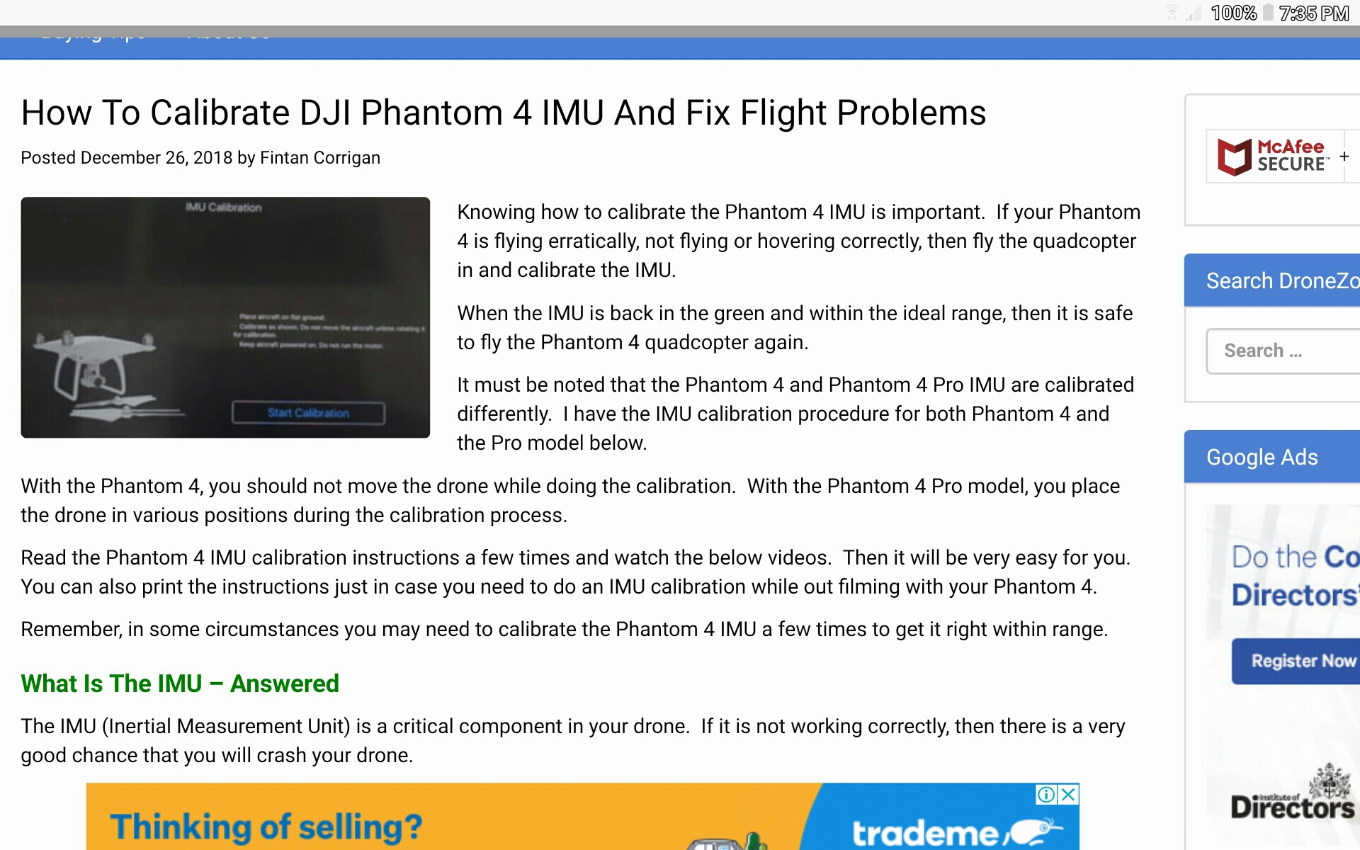

Cables can be bad at new or faulty,imu calibration recalculate all sensors on board drone,,imu check does fast check and say if needed or not but most just do it anyway,cause go4 not installed on this device is can't screenshot so I just get a picture
Also when doing this imu calibration props come off cause you follow onscreen pictures and last one is upside down resting on motors

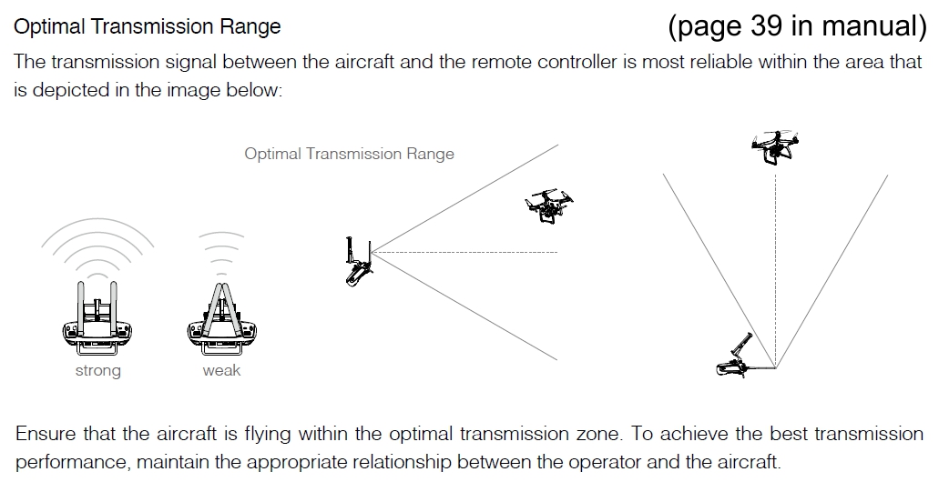

Are you orienting the antennas properly as recommended in the manual? Both should be vertical and always face toward the P4.
