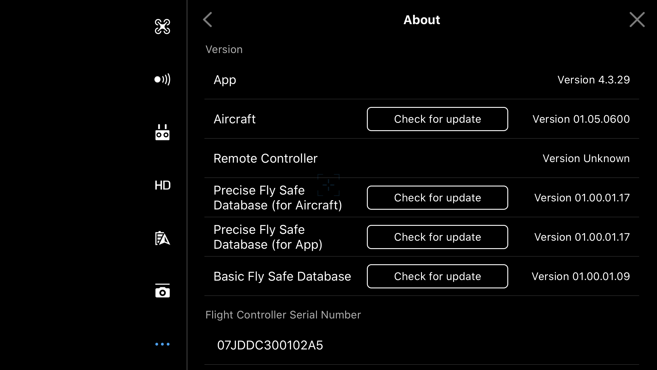

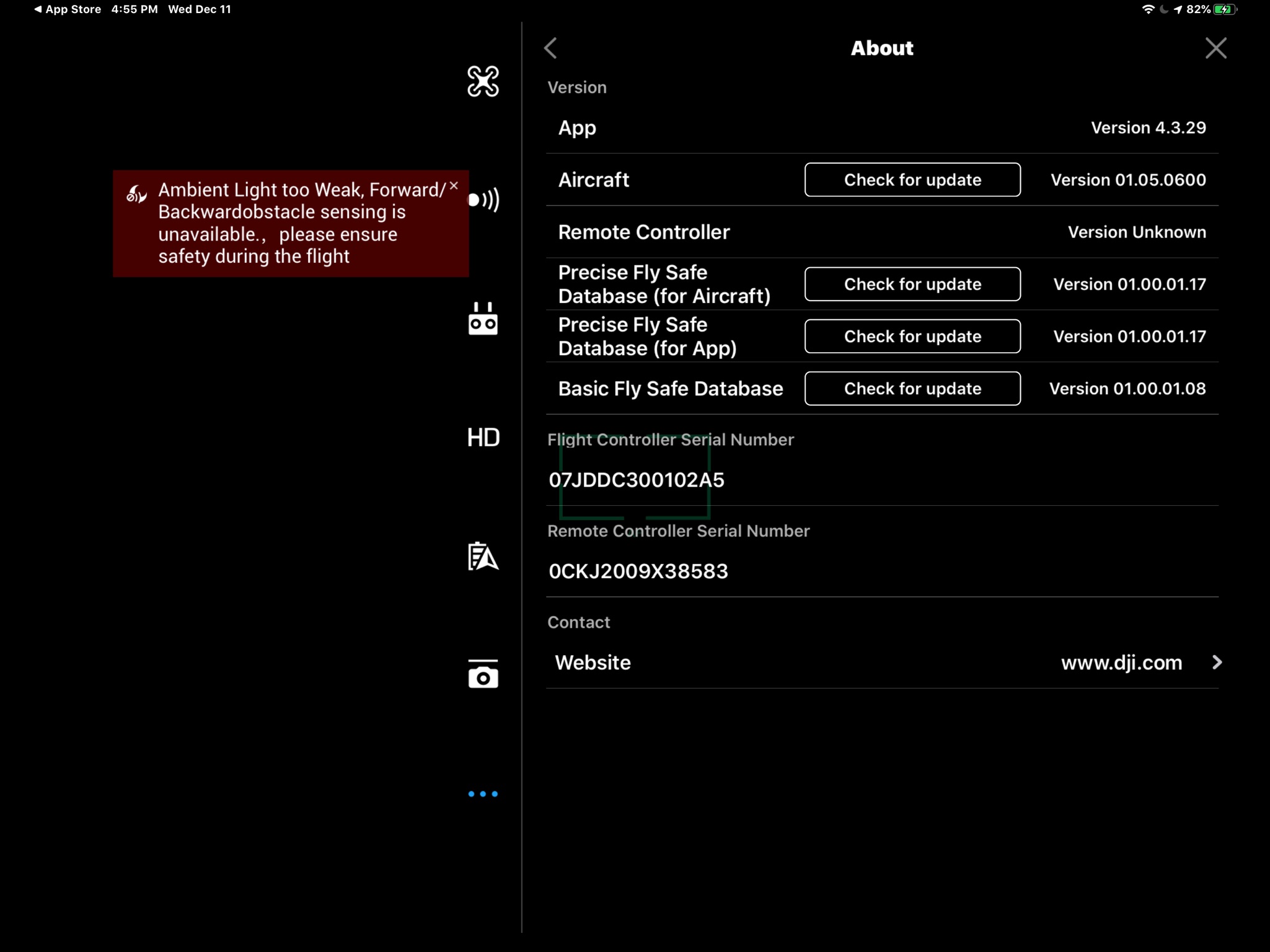

I bought the drone as is. I have tried manual resetting the controller. I have tried to reset the firmware and even reverting to the old firmware on the drone. I am assuming the old owner was in the middle of an update and it failed for the controller. I have read this being a problem for a lot of people. I have tried Rebinding the controller as well. I have tried using my IPhone 7 and IPad Pro to no avail. You can’t update the controller through assist is what I was told so by DJI. Here are some screenshots of Go 4....
I am unable to update the controller firmware. It tells me it’s up to date. GO 4 seems to think it’s an Inspire controller when the drone is powered off. It’s crazy that there’s only 1 way to update the firmware on these things. Any suggestions or help would be greatly appreciated!

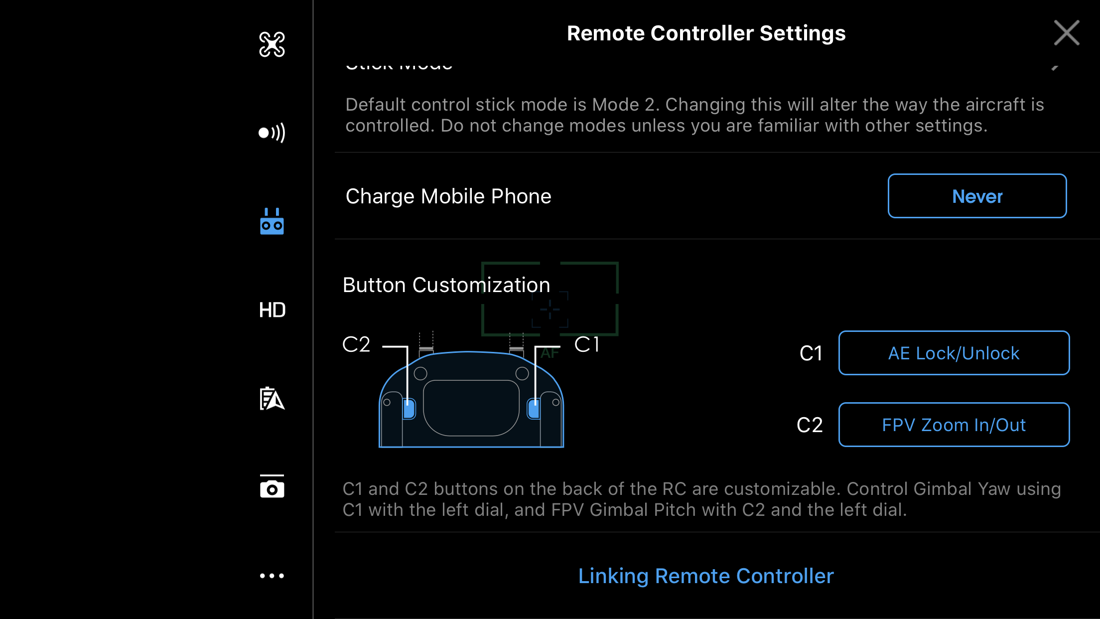

300F & E remotes:
In Go 4, tap the remote control icon. At the bottom of that page, tap advanced settings. A new page will come up that shows which model you are on. Tap the model shown, such as Phantom Pro or Advanced, and the P4 V1 line appears. Choose which P model and follow screen instructions.
have fun.

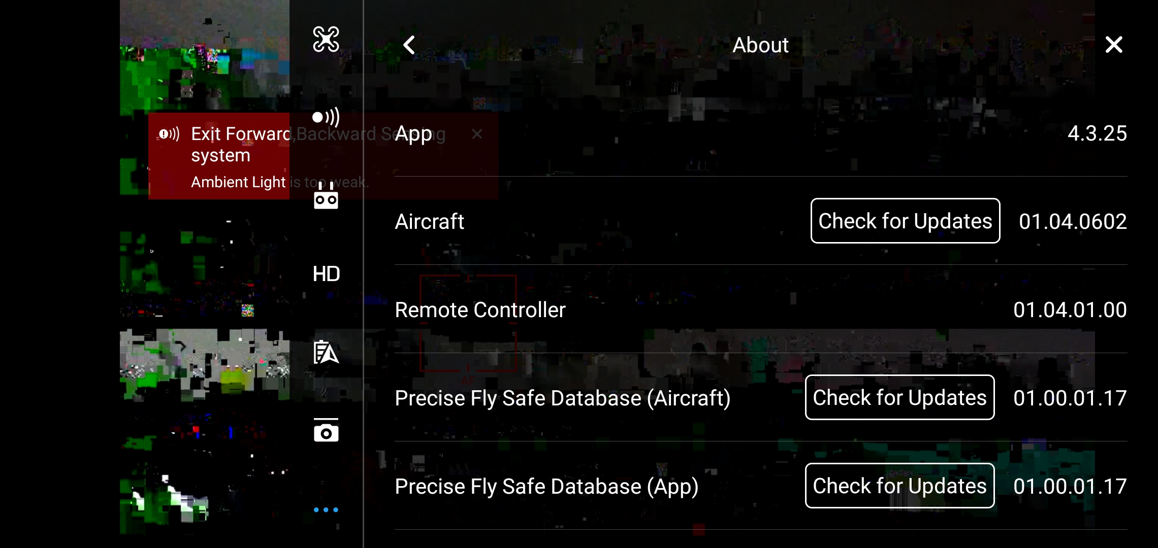

I have the same issue, pixelated video signal. I have Phantom 4pro. Controller GL300F used to work fine but now the video is pixelated. Other than that it's fine. I verified that it's not the drone by connecting the drone to GL300e controller. Video is perfectly fine so I know it's remote controller issue. I have no idea what should be the latest controller firmware but I also can't update it though assistant or the app.
Can anyone answer:
1) what's the latest firmware for GL300F controller?
2) how to update remote controller firmware?
3) is the video pixelation caused by controller firmware or something else?

Here’s what I found out. If hold the button at the top Right on DJI GO 4 screen where it shows a picture of your drone and the option to enter device at the bottom left. Press and hold the three lines for 10 seconds and the controller firmware will come up. The drone should be shut off for this. Try to refresh the firmware. I wasn’t able to refresh mine and just bought a smart controller for a great price instead. I tried to many times with so many different cables and nothing. It won’t even get to 1%. I have factory reset it by holding the c1 all the buttons on the top and c1 and c2. So shutter, record, settings, picture, and C1 and 2.
mine is still not updating. Why would you make a device with only 1 means of updating?
For as much as these things cost we deserve better. Tech support that is actually tech support is a good first step. Better tools for problem shooting is next!
