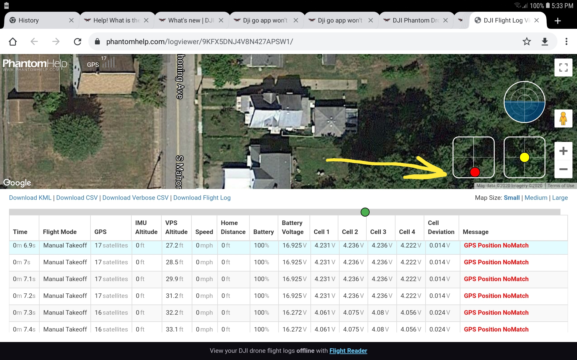

My P4 went up to 35' ft then dropped like a rock. I hope I load the log correctly. Can anyone explain please.
There is something unusual in your flight data.
Your barometric sensor (the main altitude sensing device) is showing no data at all.
The VPS (downward facing sensors for close range height measurement) shows the drone climbed to 35 ft and then came down.
The motors stayed on and there was no spinning which would indicate a failure of a motor or ESC.
It appears that the failure of the barometric sensor prevented the drone from holding altitude.
You launched and gave a little left stick down which started the descent, but without altitude holding, the drone kept descending.
You made no corrective moves with the left stick which might have arrested the descent.

I'm sure [?......i just notice on stick inputs it only show stick start and no input as its going g up,,,,this is the users problem,,we found out why it came down but why did it go up in the first place,,,,,,USER=6114]@Meta4[/USER] hit this on the head,,yellow arrow I draw show the 2nd stick input down,,unsure why no GPS match,,,would letting home point set prevent this or ?why would it change to atti mode and drift ? It should have regained sats dont you think ?,something at play mayby to do this or lead in the clouds to block satellites or got solar flared ? These questions bug me,,,also why did it continue to drop even when stick let go it should drift with wind not continue down,another curious question,,,,also a question for the OP,,,did you give any stick input to go up,it shows a slight input but mayby the remote wasn't calibrated at 100% on the stick input,,you should check your rc ,,your left stick might not be centered which will make it rev past idle speed

His left stick inputs were:
Left stick up​
0:03.2 - 0:05.2​
Left stick down​
0:00.4 - 0:00.5​
0:06.1 - 0:06.3​
0:06.7 - 0:07.1​
Without any sensor input from the barometer, his drone was acting like "vertical atti mode".
With a little left stick up, the drone would go up but when the sticks were centred, it would continue going upwards until there was some left stick down.
But with left stick down, the drone would continue going down even when the stick was centred.
Perhaps it might have been recovered with some gentle up/down moves to get control of the altitude, but any pilot would have been confused to have their drone act this way and there wasn't much time to work it out.

Looking closer at the data, I see there was an issue with GPS and perhaps the Position NoMatch message meant something after all (but 99% of the time you see this it's meaningless).
Although his GPS was receiving up to 17 sats for the flight, the Flight Controller rated the GPS health as 0/5 for the whole time.
No home point was recorded but his position was being recorded every 1/10th of a second even though the data was not used for navigation.
There was nothing blocking sats so no need to consider left field ideas about lead in clouds (? never heard that one before) or solar flares (which have never had any measurable effect on drones).
It probably didn't drift much on the breeze because there wasn't much breeze.
But none of that had any effect on the real problem which was the Phantom's inability to hold altitude.
There is no hint of any issue with his controller or its calibration either.
Short Version .. there was a serious issue with the IMU (including barometer) that prevented altitude data from showing and caused the rejection of GPS data.

I'm sure [?......i just notice on stick inputs it only show stick start and no input as its going g up,,,,this is the users problem,,we found out why it came down but why did it go up in the first place,,,,,,USER=6114]@Meta4[/USER] hit this on the head,,yellow arrow I draw show the 2nd stick input down,,unsure why no GPS match,,,would letting home point set prevent this or ?why would it change to atti mode and drift ? It should have regained sats dont you think ?,something at play mayby to do this or lead in the clouds to block satellites or got solar flared ? These questions bug me,,,also why did it continue to drop even when stick let go it should drift with wind not continue down,another curious question,,,,also a question for the OP,,,did you give any stick input to go up,it shows a slight input but mayby the remote wasn't calibrated at 100% on the stick input,,you should check your rc ,,your left stick might not be centered which will make it rev past idle speedView attachment 120015
I did nothing, it suddenly launched straight up. All I did was push down 1/2 way twice to try and arrest the accent. 1.8 seconds later it crashed onto my deck. I calibrate my controller a few times a week. And had done it that morning. I took a 2 mile flight, landed to change batteries, and it went demonic
The yellow highlighted numbers from your data indicate the left joystick being pushed up.
Blue = non-functioning barometer data
Green = VPS altitude increasing after left stick input.
