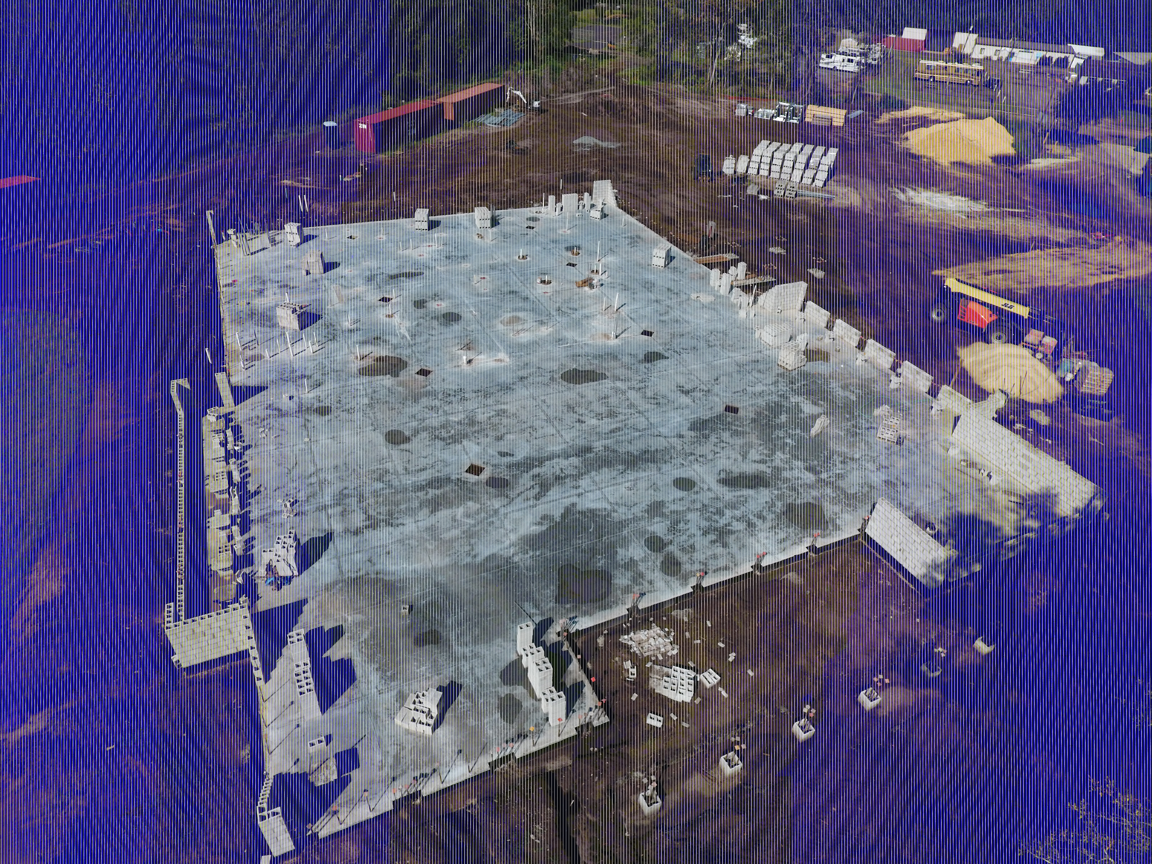

My Phantom Four suddenly has photos that look like they were shot through a screen. The image is still visible but the fringe area is now purple and the center screened.

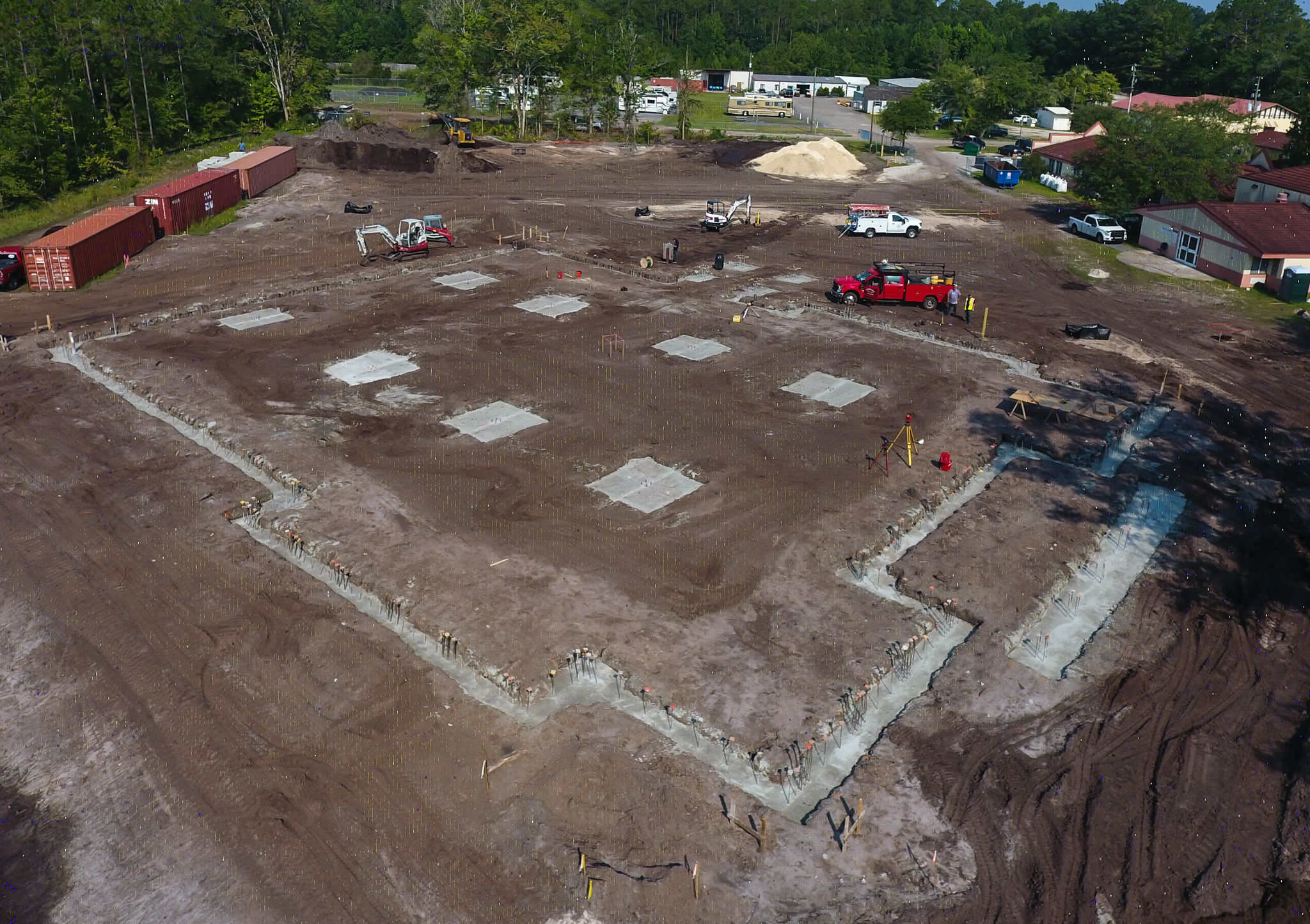

Live feed looks normal until I hit record. On the ground the picture is normal. All photos are poor. SD card is the one I have been using successfully for several years SanDisk 32gb. See two photos taken within a week to see how they have changed. Thank you

Well... it could be the card. i would try to clean it with a lens cleaning cloth (dry) and see if that makes a difference. Contacts on SD cards do wear out over time.
I can't remember but doesn't the app record low-resolution images to the app / phone as well? I would check those too just to see if they look normal or if they look weird.
