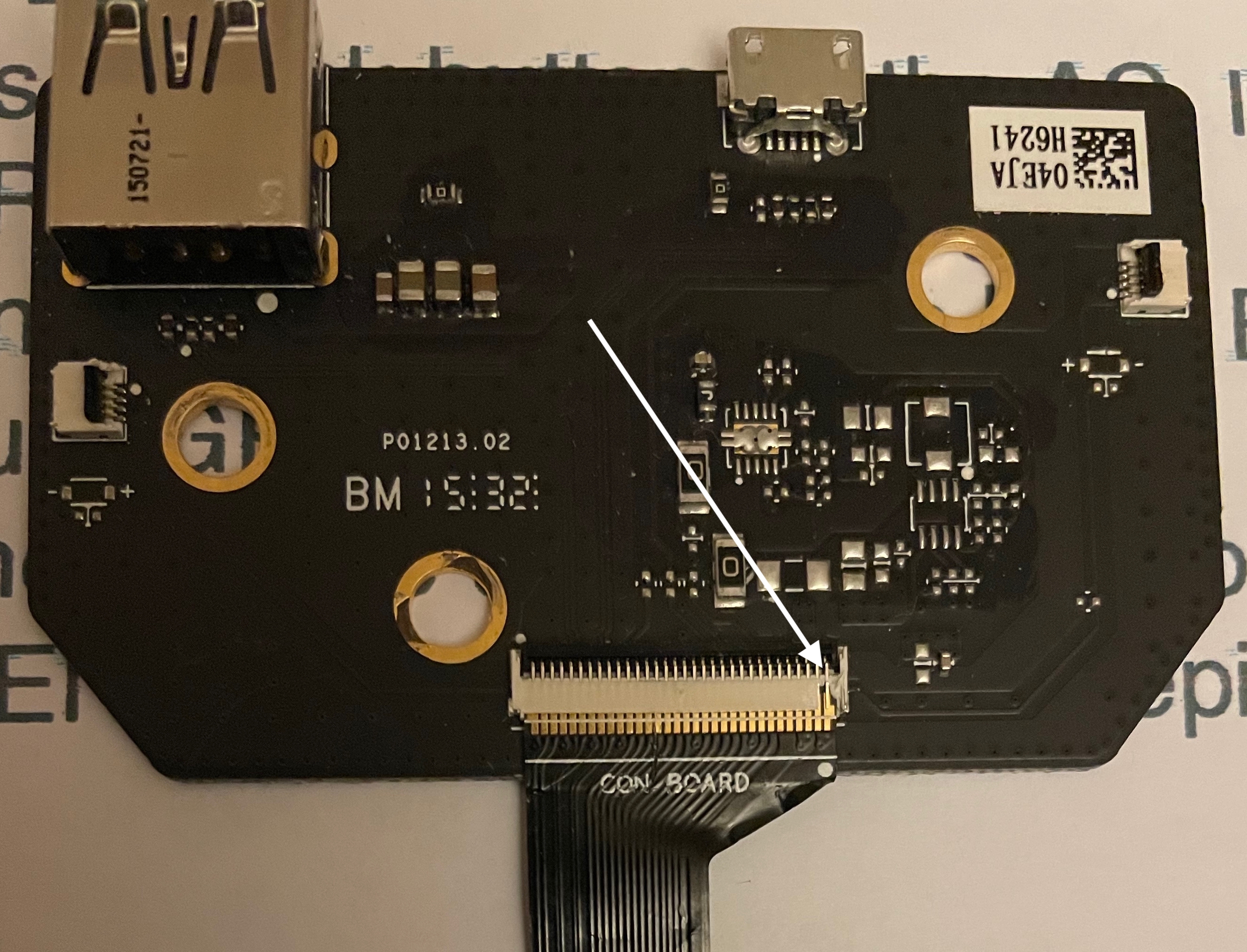

I think my problem is defective connector on the Remote Controller Interface Board. Abit of the socket has broken off but then again, looking closely it doesn't look as though there is a wire going to that part of the socket??
Anyway, bought a new board so see what happens when I replace it 🤞

Initially it was b because the multi-pin ribbon cable wasn't pushed right in, something stopping it. Blew the socket out with air brush and the cable goes in OK now but still RC Disconnected from the Display.
Any ideas - defective Interface Board still???
