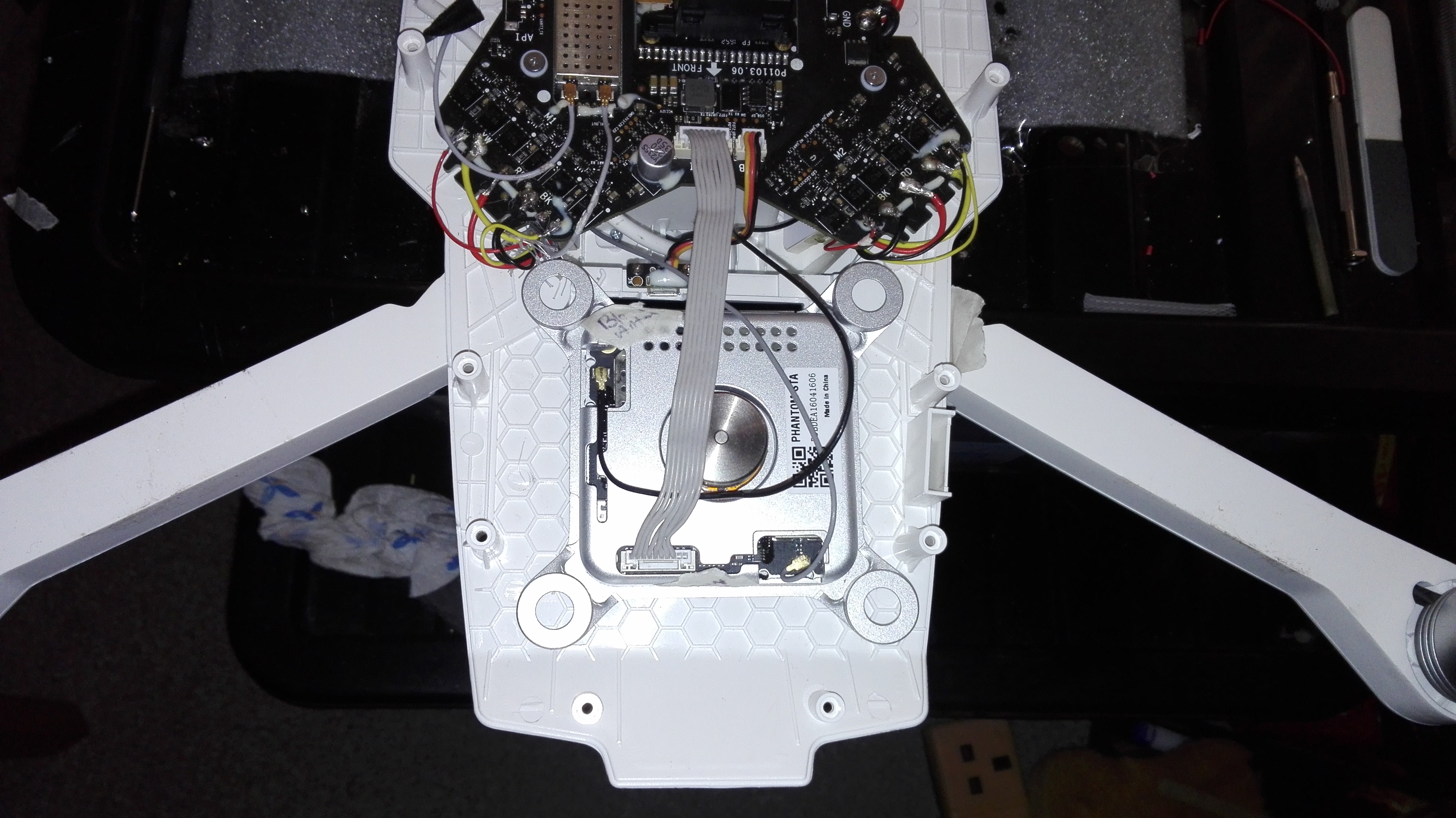

Yes I have just finished one lots of patients the camera is a pain flys good seems very responsive am going do other one
One n front one in back and camera antennas in base each side of battery tray
