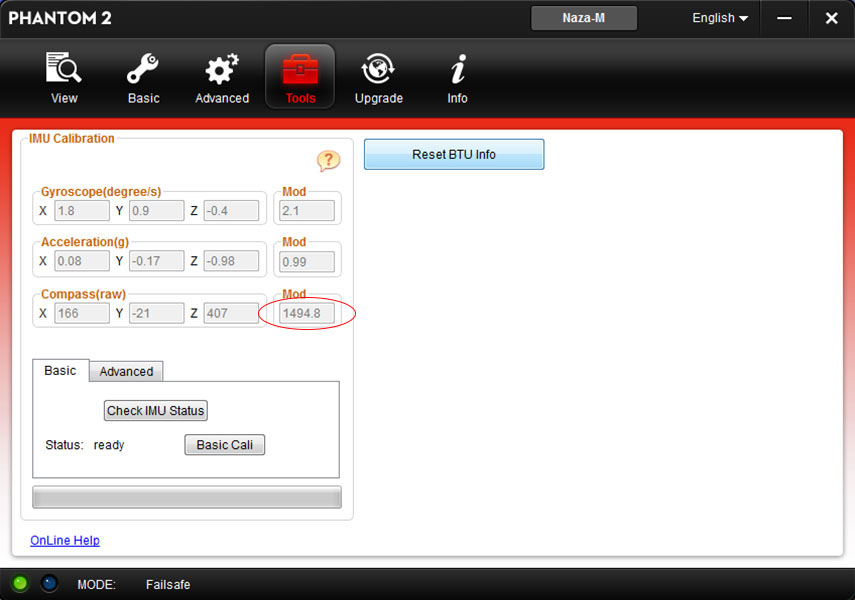

Did you calibrate the controller first then the P2?
Connect the P2 to its software and check those IMU settings again. The MOD settings should be between 1300 - 1600 and if lower or higher then those numbers recalibrate the advanced IMU.

calibrate the controller first then theP2
This is the number was referring to.

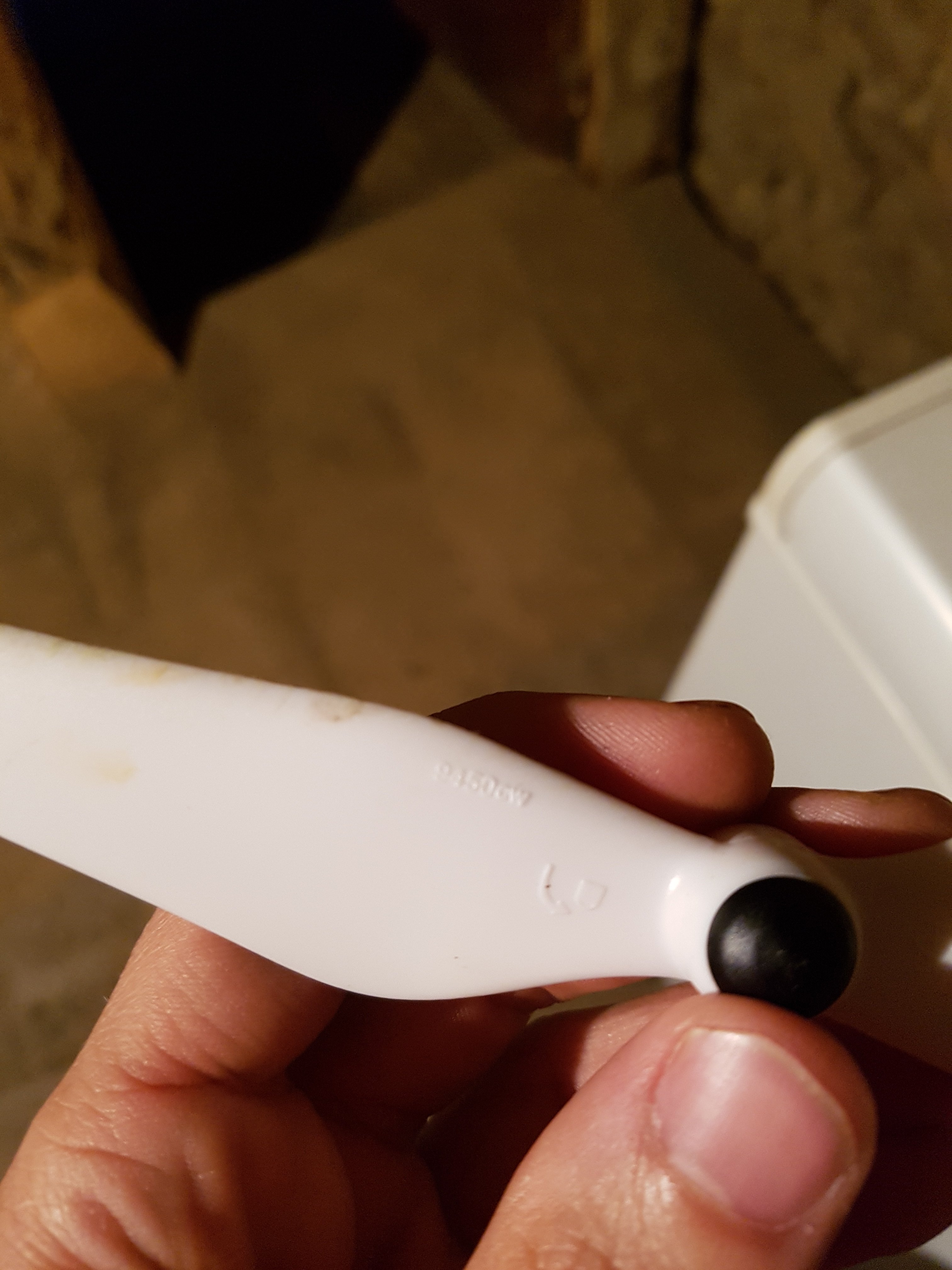

What kind of props do you have.. I crashed mine and put on some cheap off brand and it was doing the same thing your is doing.. either balance them or buy official DJI props. I bought the official and it corrected the problem.. maybe that helps good luck
all original

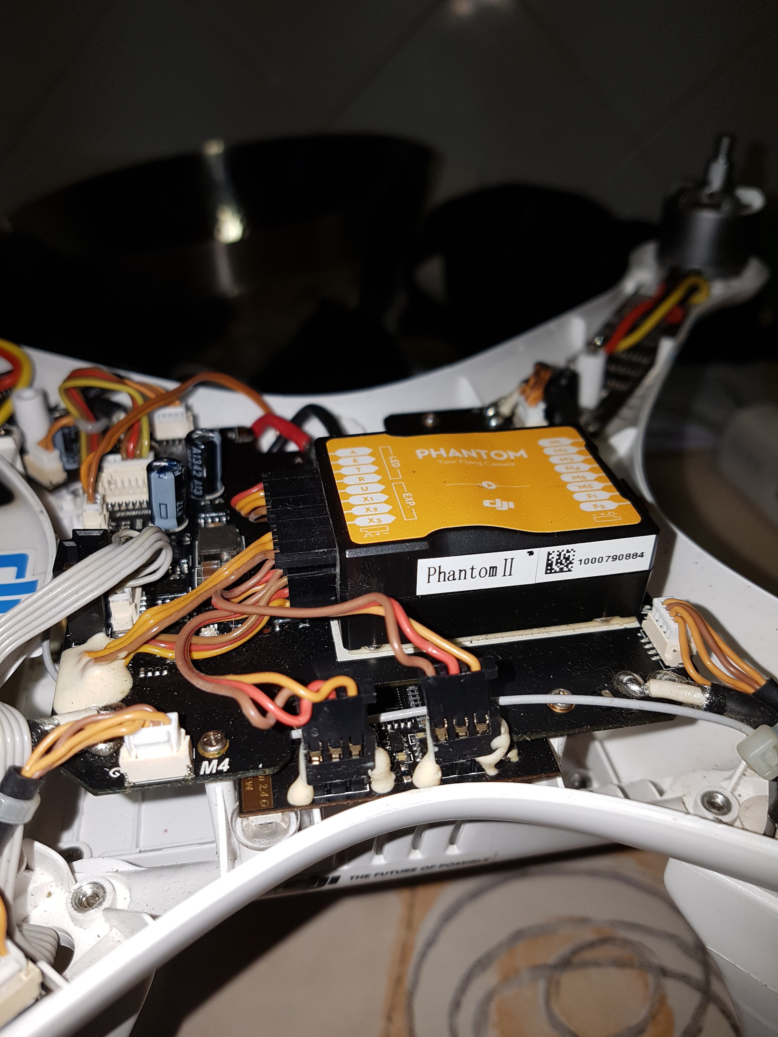

next step change Part 9 MC Board - NAZA Flight Control System
Now you say the props are all original if that is true the leading edge will have DJI on one side and 9443 on the other side.
Why are you thinking of replacing the main (MC) board?

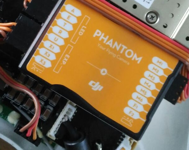

I'm going to change the main board because there are controls coming from
When you takeoff is the righthand switch (S1) in the upper position and are you in Naza-M Mode in the P2 software.
What I can tell is that the model you have is a Phantom 2 vision and not a barebones Phantom 2 non-vision because of the silver module next to the Naza-M control module. So whoever you bought this unit from either damage the camera/gimbal assembly or just removed it. I see no reason for changing the Naza-M module or the whole board as it will not accomplish anything regarding the flight characteristics you are having.

1) Are those props marked with DJI 9443 or 9450? All props have to be the same and they cannot be mixed.

sorry but it is very difficult with the translator. I have the phantom 2 non-vision, the one in the photo is a phantom 2 vision for pieces. I answer the questions.
1. All accessories are the same as dji 9443
2. Maza M
3. Yes
my phantom is this

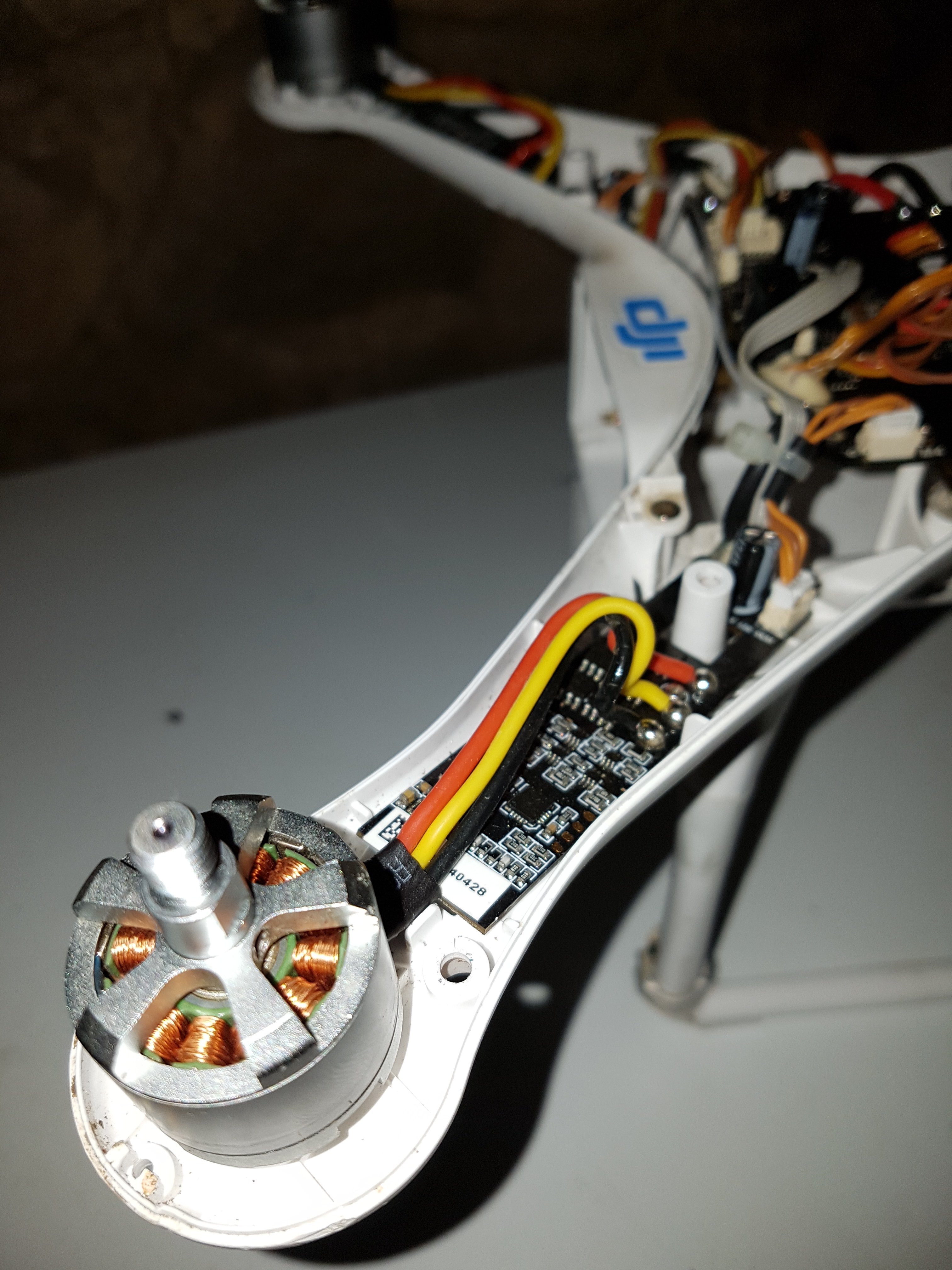

I noticed in that photo the shaft on the CCW motor seems to be all black. Is that correct? If that indeed has a black shaft all 4 motors should be 2312 and the props for those motors should be the 9450. Below is a photo of both motors used in the P2 v1 2212 and P2 v2 2312 the motors cannot be mixed all for have to be the same. Which ones do you have and are all 4 the same? Look at the difference in the windings.

Noté en esa foto que el eje en el motor CCW parece ser todo negro. ¿Es eso correcto? Si eso tiene un eje negro, los 4 motores deberían ser 2312 y los puntales para esos motores deberían ser 9450. A continuación se muestra una foto de ambos motores utilizados en el P2 v1 2212 y P2 v2 2312, los motores no pueden mezclarse todos para tener que ser el mismo. ¿Cuáles tienes y son los 4 iguales? Mire la diferencia en los devanados.
