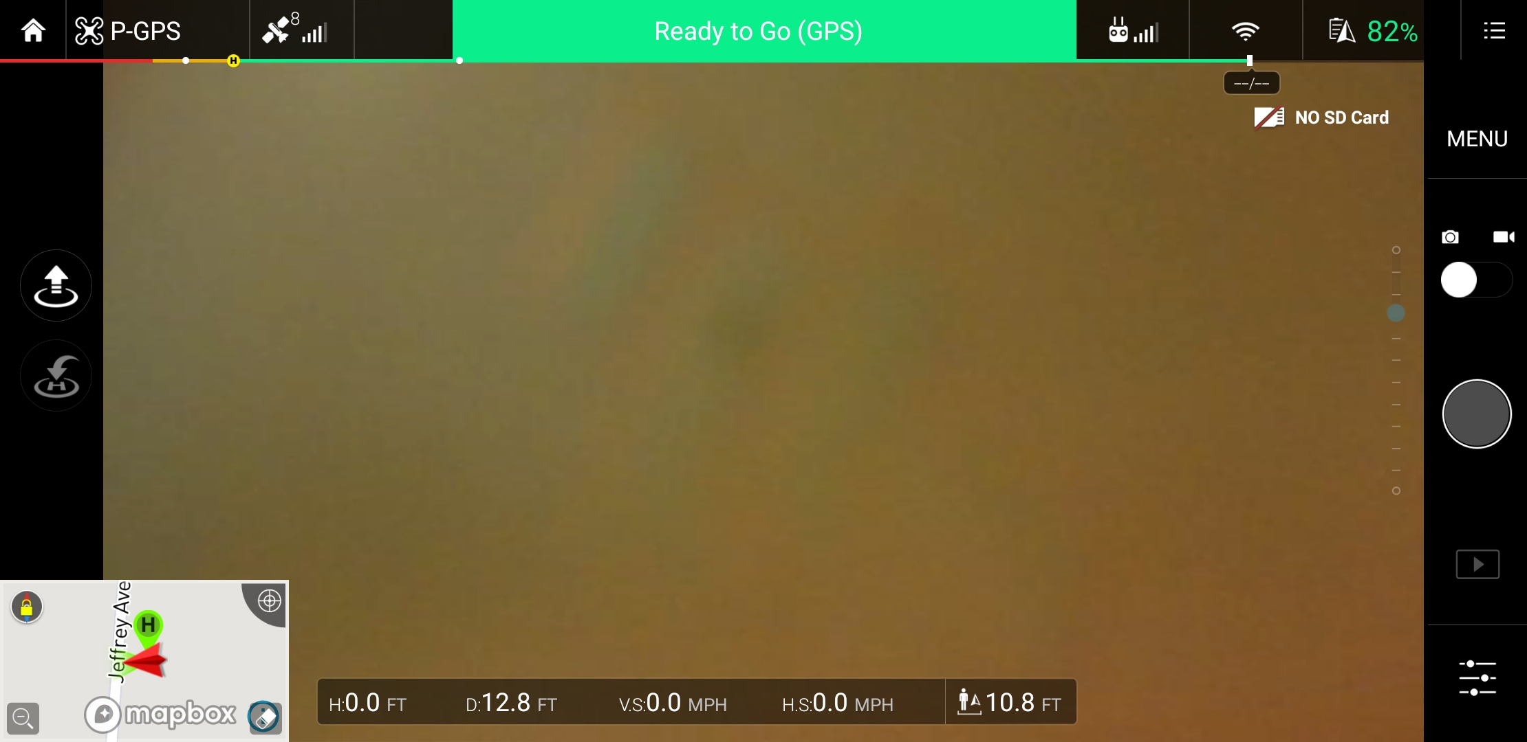

Not sure how to see remote controll signals. I did walk out 215 feet from AC and nothing on the app changed. Here is what im seeing on the app

@Planetime2, I not sure about yours, my problem the signal would bounce Good, Bad and Ugly, standing completely still. At 100'
Rod
