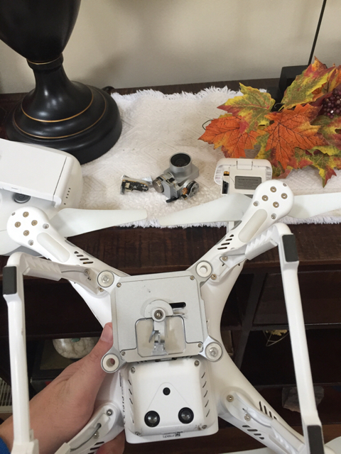

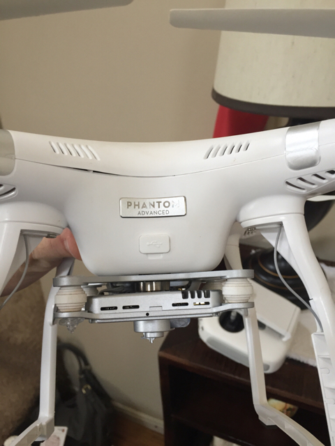

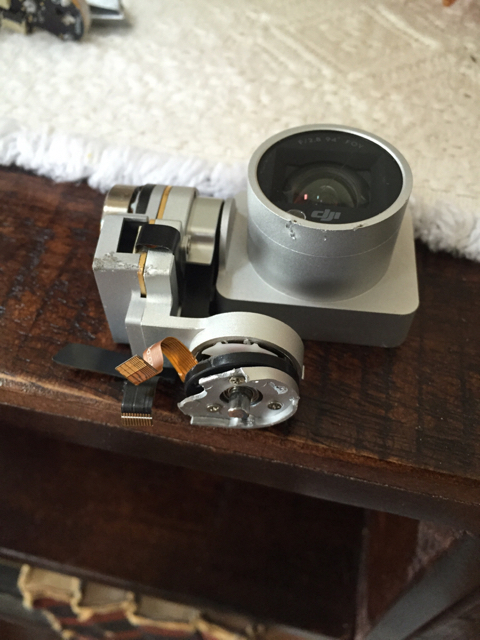

Hey everyone,
I frequently read this forum and regularly get useful information and tips from y'all. Thank you for that.
Unfortunately today I pulled my phantom 3 advanced out at my brothers house, turned it on and calibrated the compass and was locked into satellites (don't remember how many, but I have flown here before and had no problem acquiring 16 satellites). Status bar indicated it was safe for a GPS flight. I used auto take off and immediately brought it up to about 30-40 feet when the motors suddenly stopped and it fell and smashed on to the street and busted into a ton of pieces. As it fell I looked down at my iPad to see if there was something I could do and there was no live feed and said there was no signal.
I have contacted DJI and they gave me an RMA with an estimated return of 2 weeks. Will this be covered under warranty? Also will they be able to verify this was not user error, there is a flight log that shows a flight of less than a minute. I bought it off amazon about 4 months ago.

This totally sucks and I feel for you. My signal cut out as well and resulted in a crash taking out props but that was all. This was my first P3P and was about to be sent back to where I bought it for Warrenty replacement for damage to the gimbal caused in shipping. It all worked out but was very stressful.
The area I was flying in was way too tight and full of power lines and trees not to mention 6 story buildings on two sides. A realtor talked me into it but I should have known better....any way between low satellites and signal cutting out I lost total control at around 30 feet. My prop guards saved my *** or I would have had motor damage as the P3P wrestled with tree branches and leaves on the way down. Looking at the log I saw signal cuts in and outs. Did not see # of satellites.
What was the area around you like? Trees buildings or power lines? DJI may be able to do some Warrenty magic if you give them the long and any footage you may have. I wish you the best of luck!

This was in a neighborhood on top of a mountain with great signal and 14-16 satellites. No power lines, trees, or any other obstructions, it died and fell 10-15 ft away from me at the end of the driveway. Like I said I have flown here before without any problems. Drone just died 30 seconds after takeoff with 58% battery life. I have looked at the flight log with healthydrones.com and cannot see anything. No warnings and it shows the battery was 58% at takeoff and landing, landing being when it died and fell to the pavement I assume.
If DJI cant pull the info they need from the drone, then I will happily provide whatever they want. They did not want me to send anything except the drone and all of the broken pieces and controller.

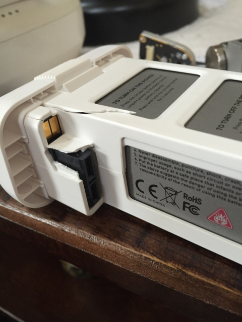

Same thing happened to me this morning, with fully charged battery, double checked, still in place after 120ft fall! Just 200ft any heading away when "no signal" appeared followed by a drop
I wouldn't put it pass it that the batty vibrated loose.
Just an assumption.
That seems more plausible. If a battery is not sufficiently charged to support a flight wouldn't it indicate? What this fellow has described is an instantaneous loss of power with no warning at all.
I once had a Syma x5c (toy-grade quad) take off (indoors), rise about five feet, then just drop onto a carpeted floor. It started up again as per normal, rose up a few feet, dropped, and started running again. I replaced the battery and the problem was solved. When I pulled on the battery's connector-plug wires one of them pulled right out with very little effort.
These Phantom batteries are not simple two or three component devices. I've never taken one apart but I'm led to believe they contain numerous cells along with control circuitry. All it takes is a loose connection somewhere and a little vibration.
