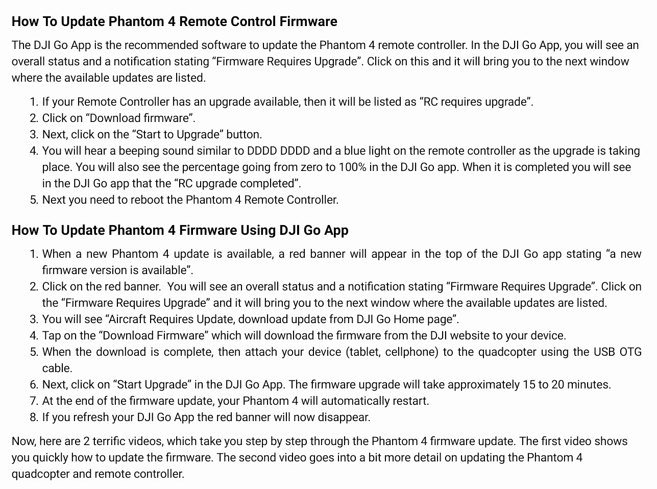

OK was just having quick look..can you or have you clicked on overall status like mentioned below

OK was just having quick look..can you or have you clicked on overall status like mentioned below View attachment 107604
The DJI GO App does not connect to the RC and I don't have a "Firmware requires Update".

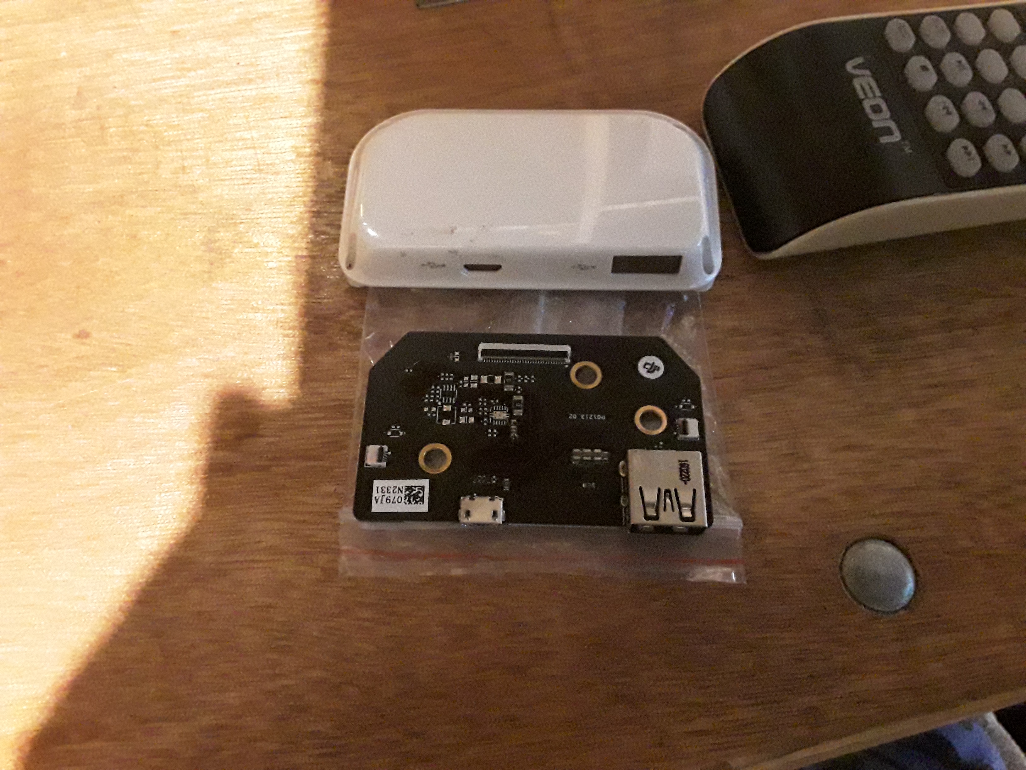

I not metion trying another device but could try,,this pic is my p4s usb module,,I upgraded mine but mayby yours is bad that why I ask if you know history of drone like new out the box or buy used ,not to offend you,,these are know to be bit dodgy sometimes,,easy to look under cover and inspect,I know there is a usb testing device but could probly make one yourself to see if it working

I not metion trying another device but could try,,this pic is my p4s usb module,,I upgraded mine but mayby yours is bad that why I ask if you know history of drone like new out the box or buy used ,not to offend you,,these are know to be bit dodgy sometimes,,easy to look under cover and inspect,I know there is a usb testing device but could probly make one yourself to see if it working View attachment 107605
Maybe it could be a cheap solution to buy a new usb module. But I think it is more a firmware problem than a USB one. As I wrote, I can use the RC on my windows PC to play DJI Flight simulator so the "USB module" is working well. It is the firmware part that is the problem.
I forgot to mention that I have also only the 3 left leds flashing when I am charging the RC. It is a known problem. It should be link with the firmware problem
