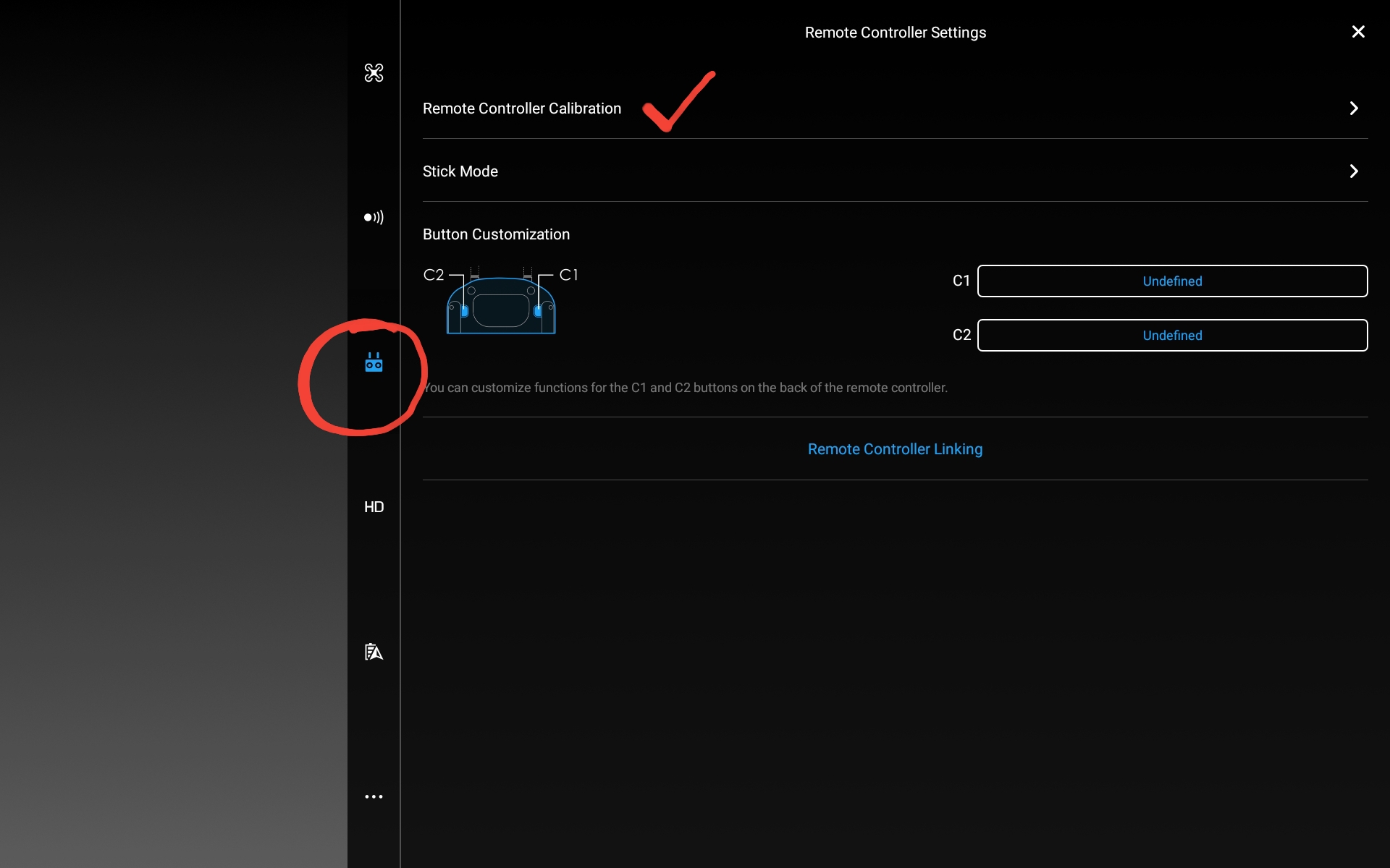

If you tap the lines under like my screenshot, settings should come up,,,,this p4s but same screen.....is yours the built in screen

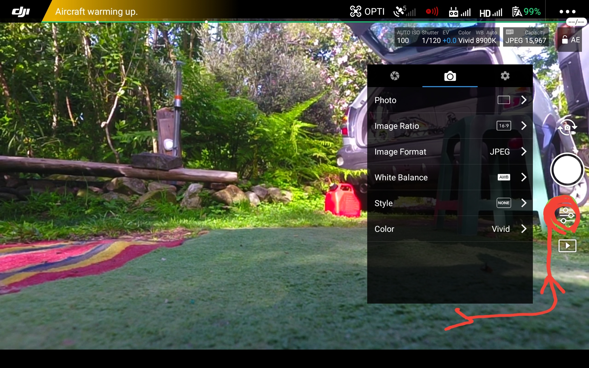

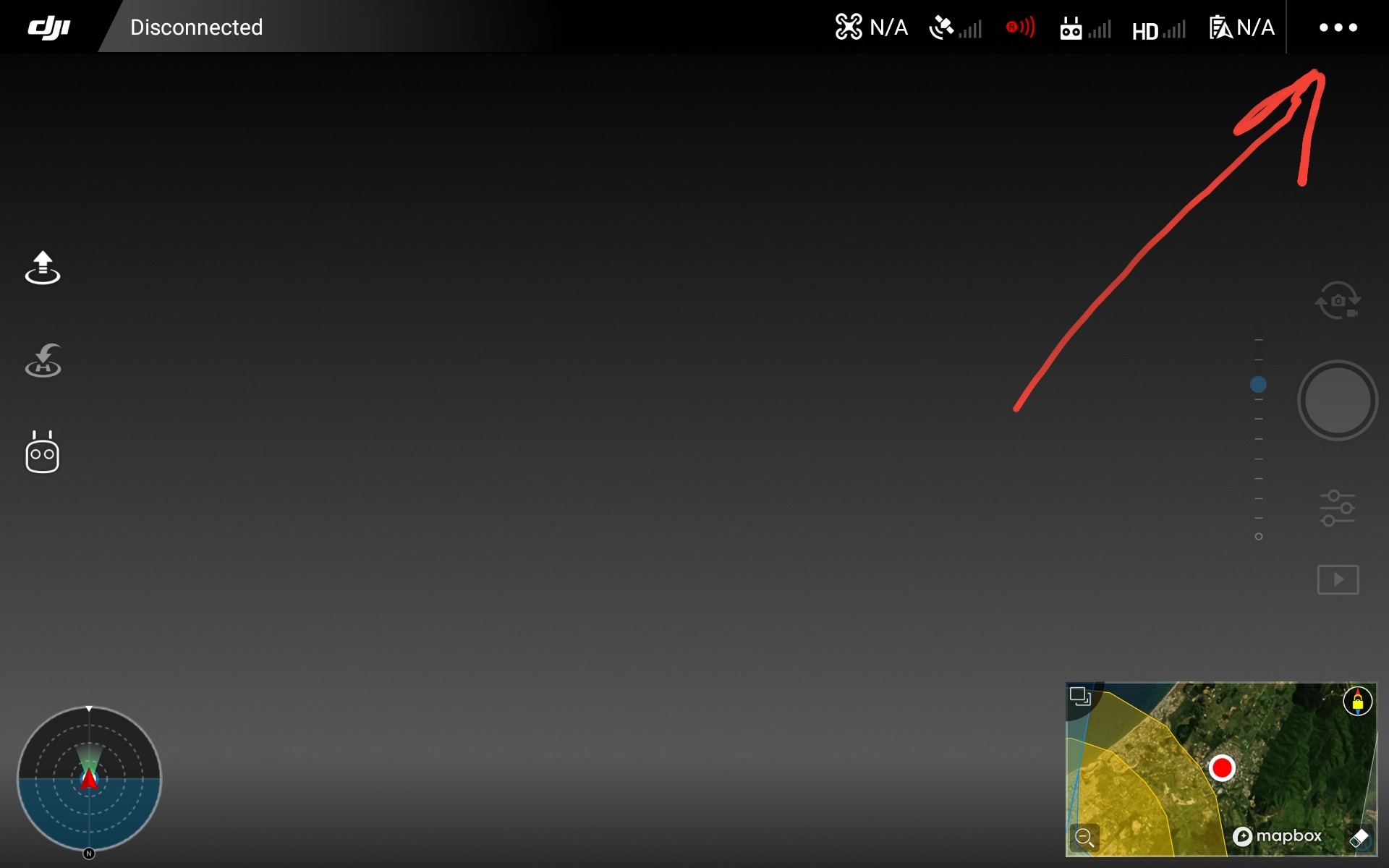

If tablet or phone click 3 lines top right for settings,,very unsure if you have built in screen,,I think it swipes with finger one way or another,,but should be able to change settings in app

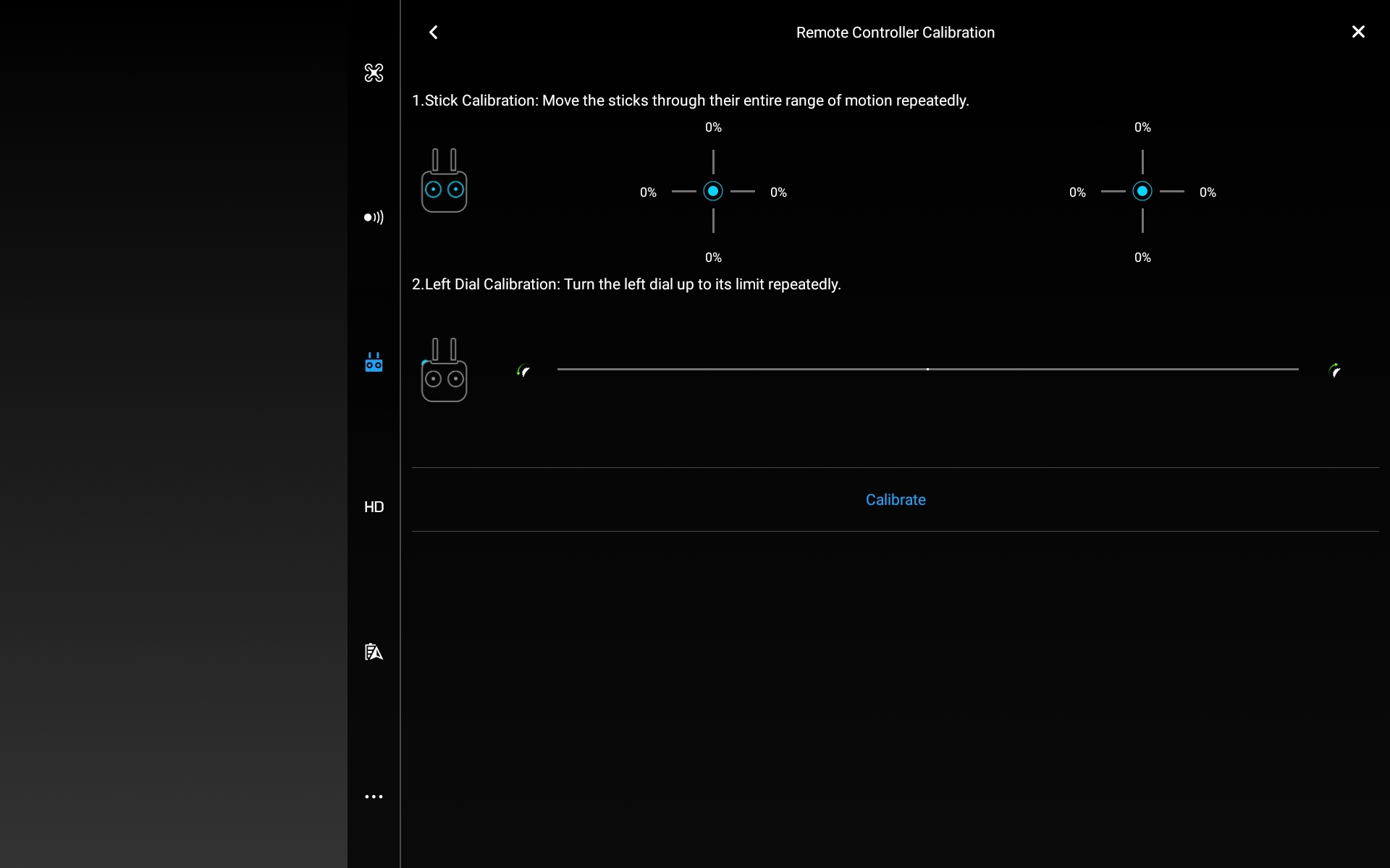

where is left dial calibration that you turn up to its limit
sorry for all the questions thanks for the great help

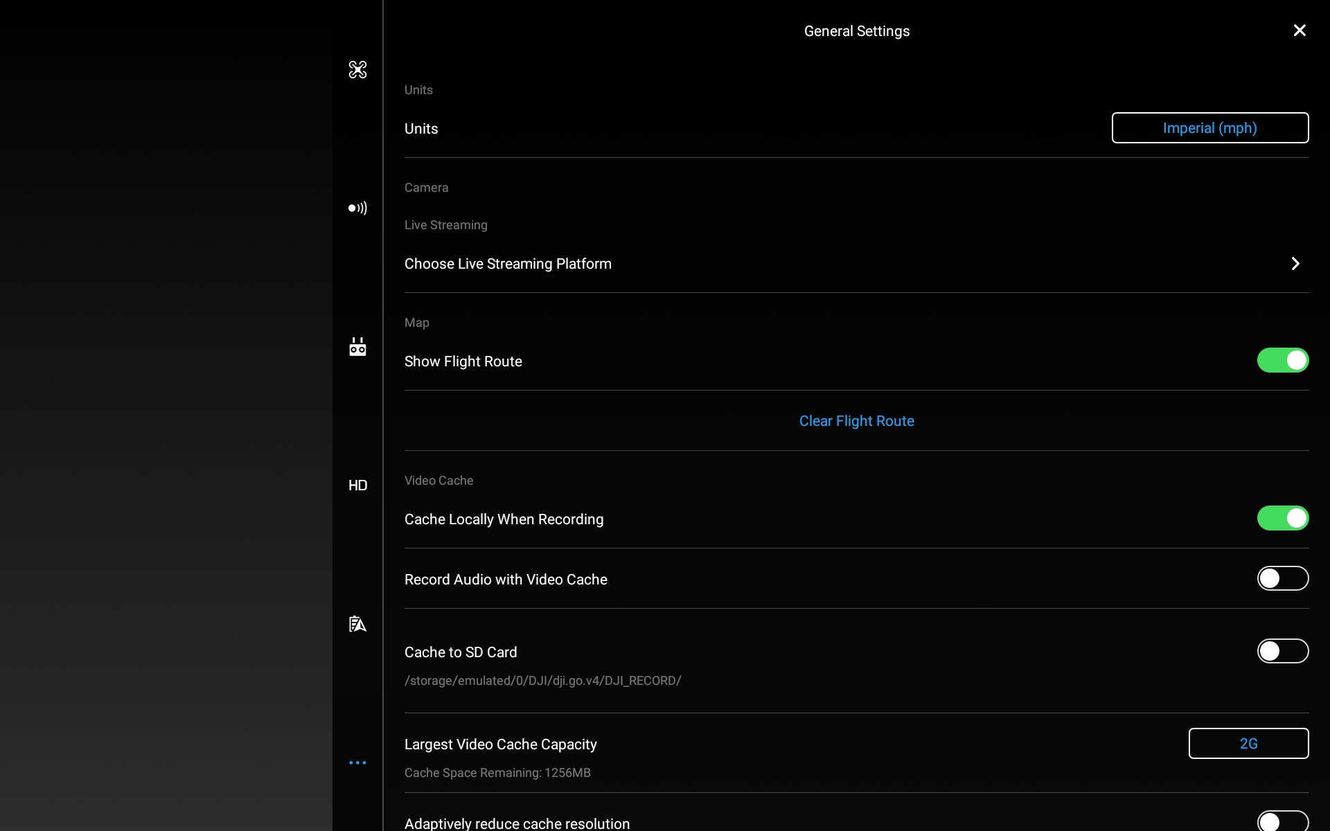

i see all these settings
main controller settings
camera settings
general settings
visual navigation settings
gimbal settings
image transmission settings
how do you get to all these
do i need to instal the DJI GO 4 AP on my iphone and connect to remote controller
even thou the remote has a screen

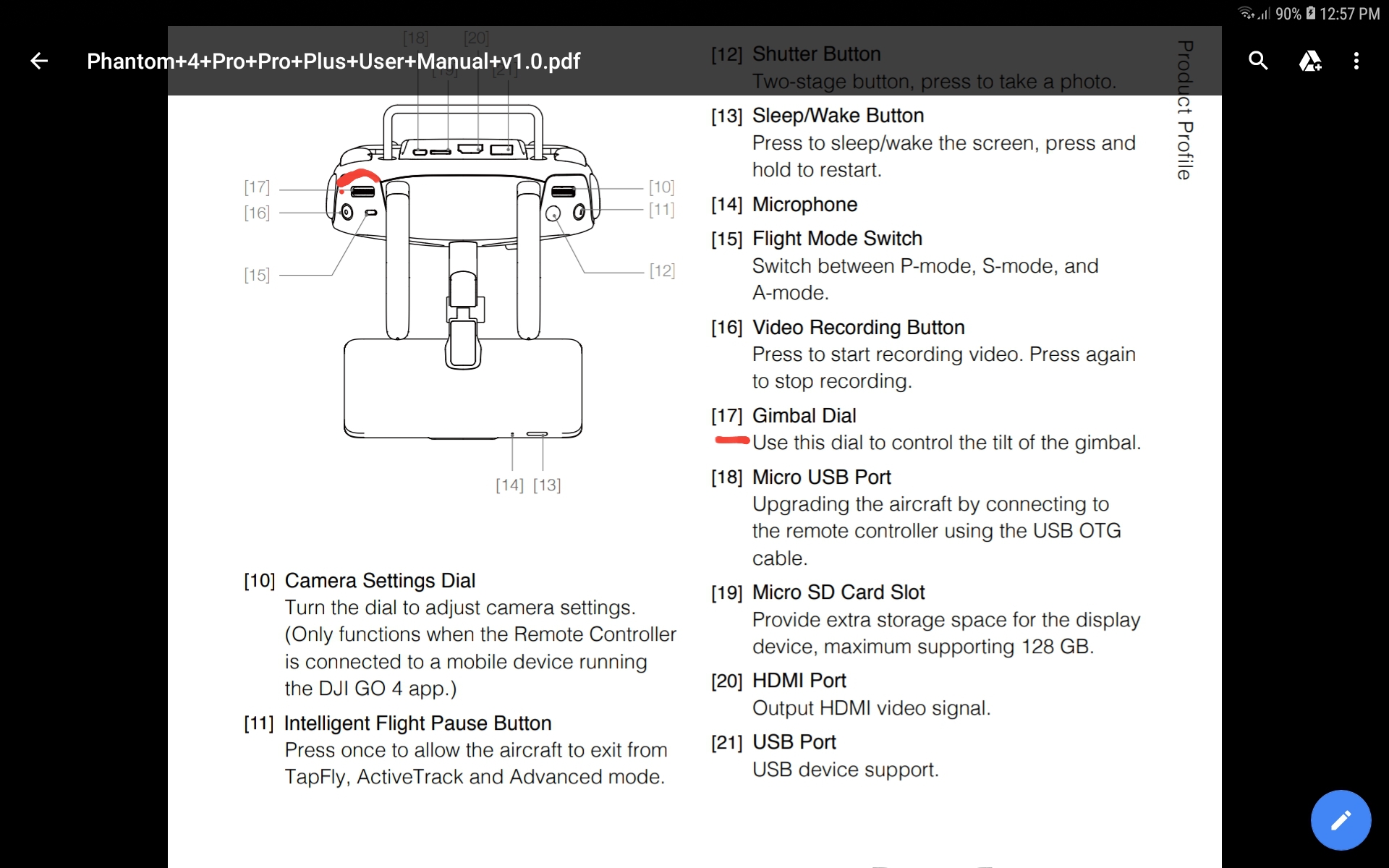

Left dial on remote needs to be turned left and right in calibration for the stick settings to save,go through it then click calibrate,it might make you do again but that's ok,,it will show its finished by onscreen prompt
