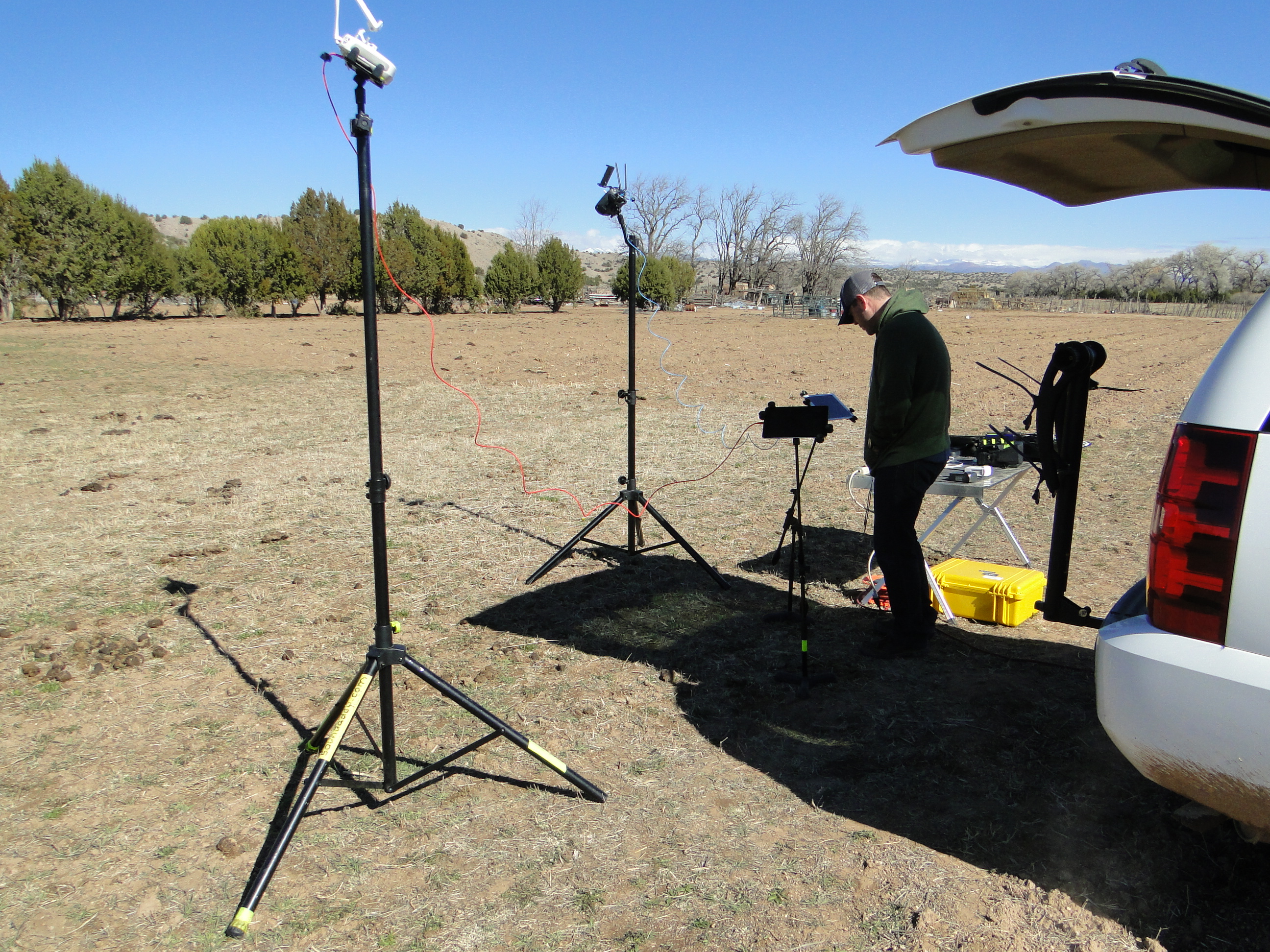

The RC holders are my invention. Because I can put the controllers 10' in the air, reception is often 100% up to a mile away without the use of extenders. With passive parabolic extenders, we've flown up to 2 miles out with 100% signal strength, which is absolutely necessary for corridor mapping. The caveat is that you have to be aware of the drone's location and "aim" the antennas accordingly.

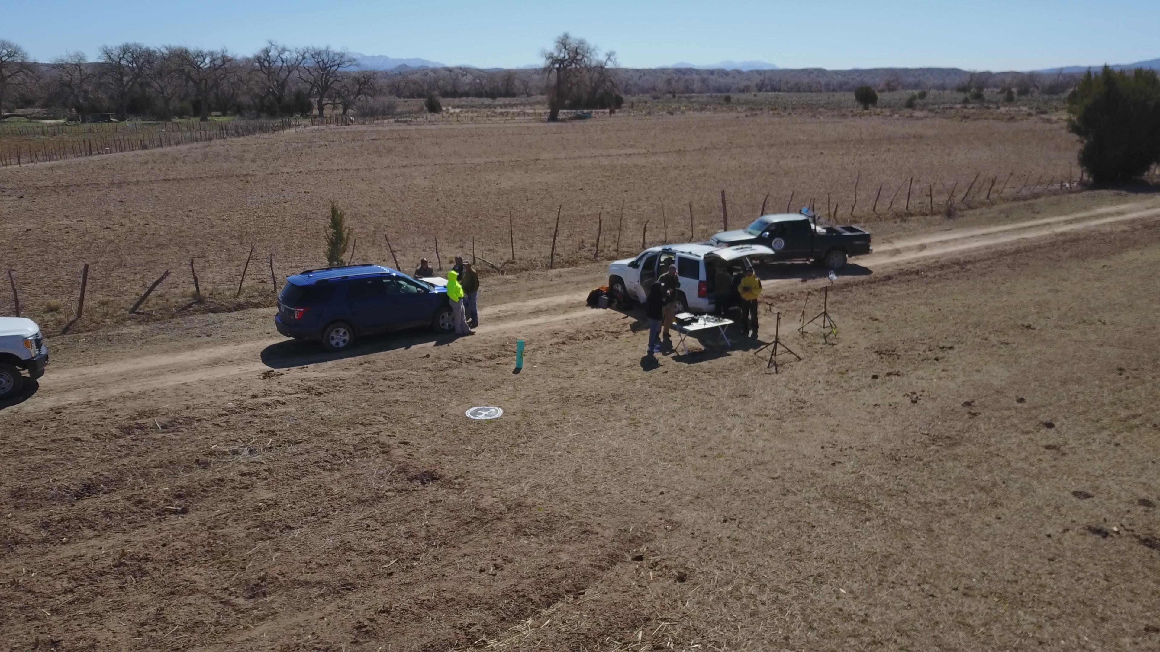

And here's a screen capture from the Mavic Pro showing the whole launch area....
Those other folks and trucks are the client who wanted to check out our operations.
