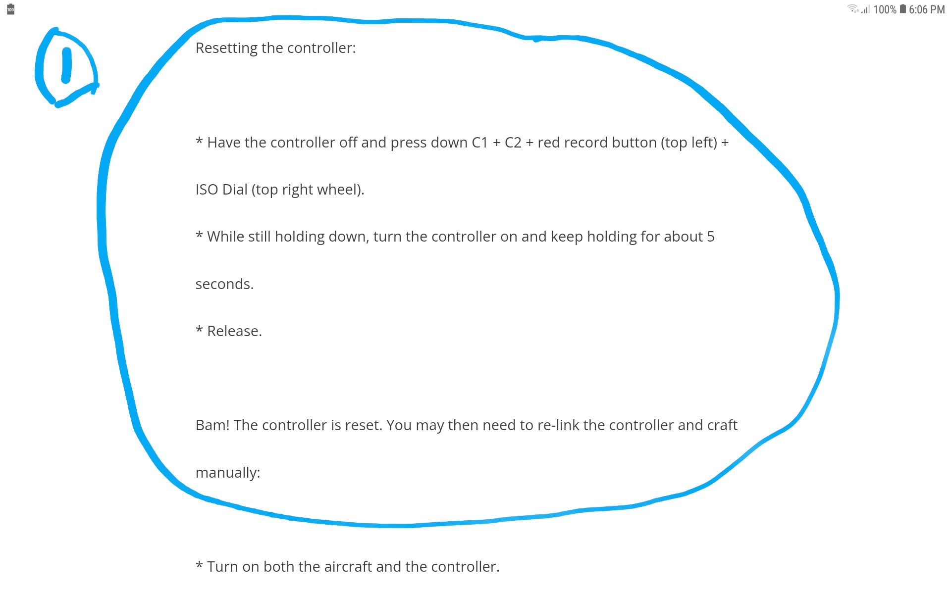

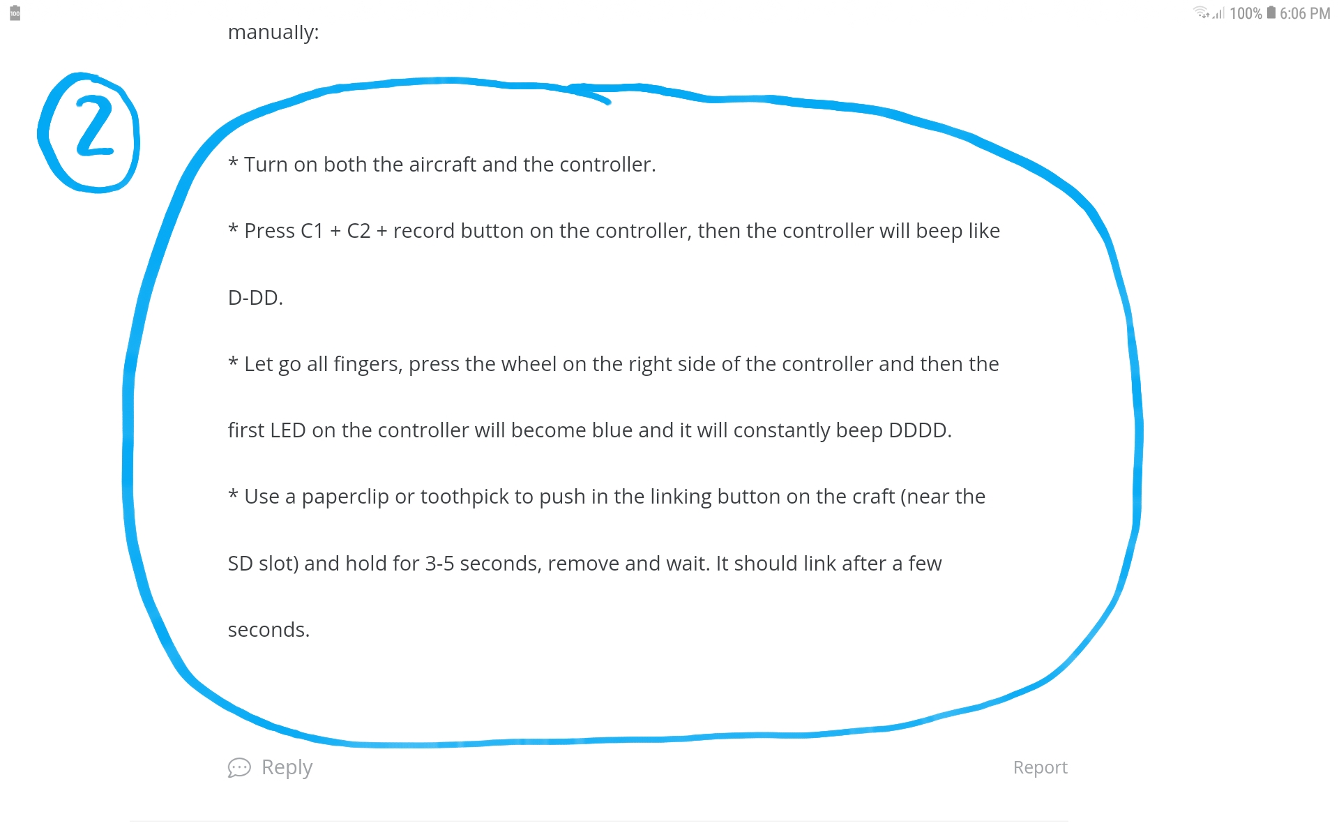

Try this method ,,,remote reset and manual linking
