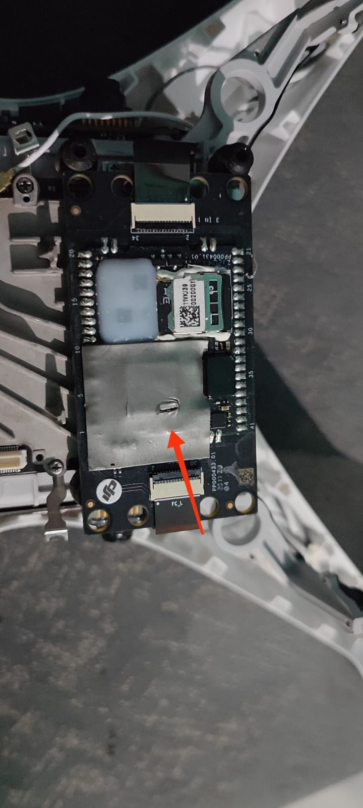

Hi all
recently got a problem in phantom 4 pro v2 . it has been crashed and damaged from bottom side. flight controller has one sign of force on it but not damaged . now when turn it on and check in about section it is not showing flight controller serial number. it is not showing any battery info also . flight controller flex cables are good . all four LED's below motors are not glowing . flight controller pic is attached for reference . IC below the tape on flight controller is not damaged visually. is this flight controller needs replacement ?

That’s a hard hit. That board is held in place by rubber isolators that would have collapsed completely and may have allowed some damage on the underside of the board. What does the underside look like?

I removed the tape and inspected that edge of ic carefully but didnt find any damage. Even checked the other side of fc also but no component is damaged .

Solder connections on the board can break easily, your lights wires are soldered to it as well. Also ribbons and connections easily damaged. Hope the replacement part fixes it. I'd keep a solder iron handy.

That you can see. Without the proper test equipment, you are dealing with guesses. If you had another board to replace it with, that may provide the answer.

Yes only DJI has test equipment. From my experience the flight controller probably is the issue. Sometimes it is the ribbon cables as they are easy to damage and you can't see it without a microscope. My money is on the FC.

I thanks for the reply . I have replaced the fc and it is working fine now .
