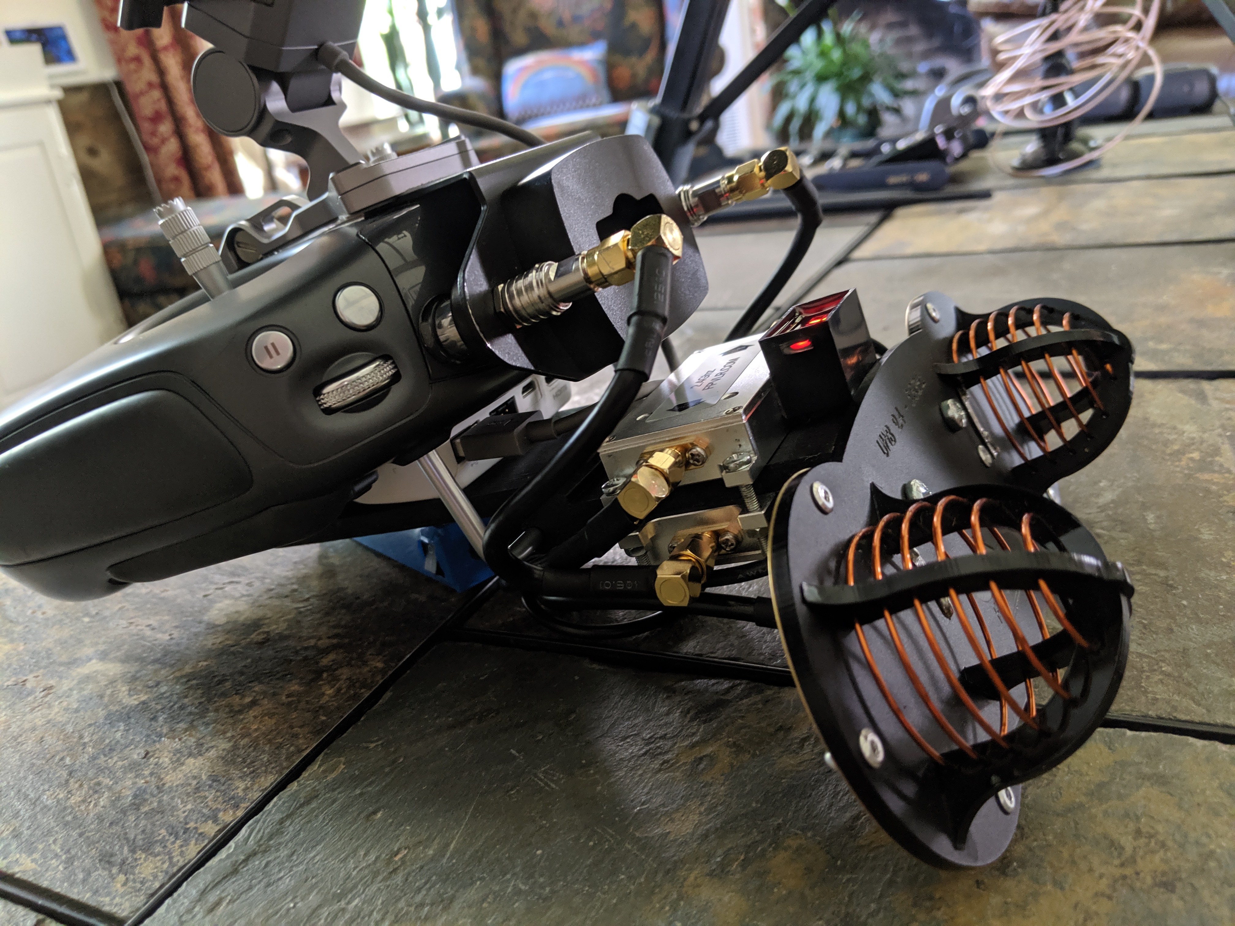

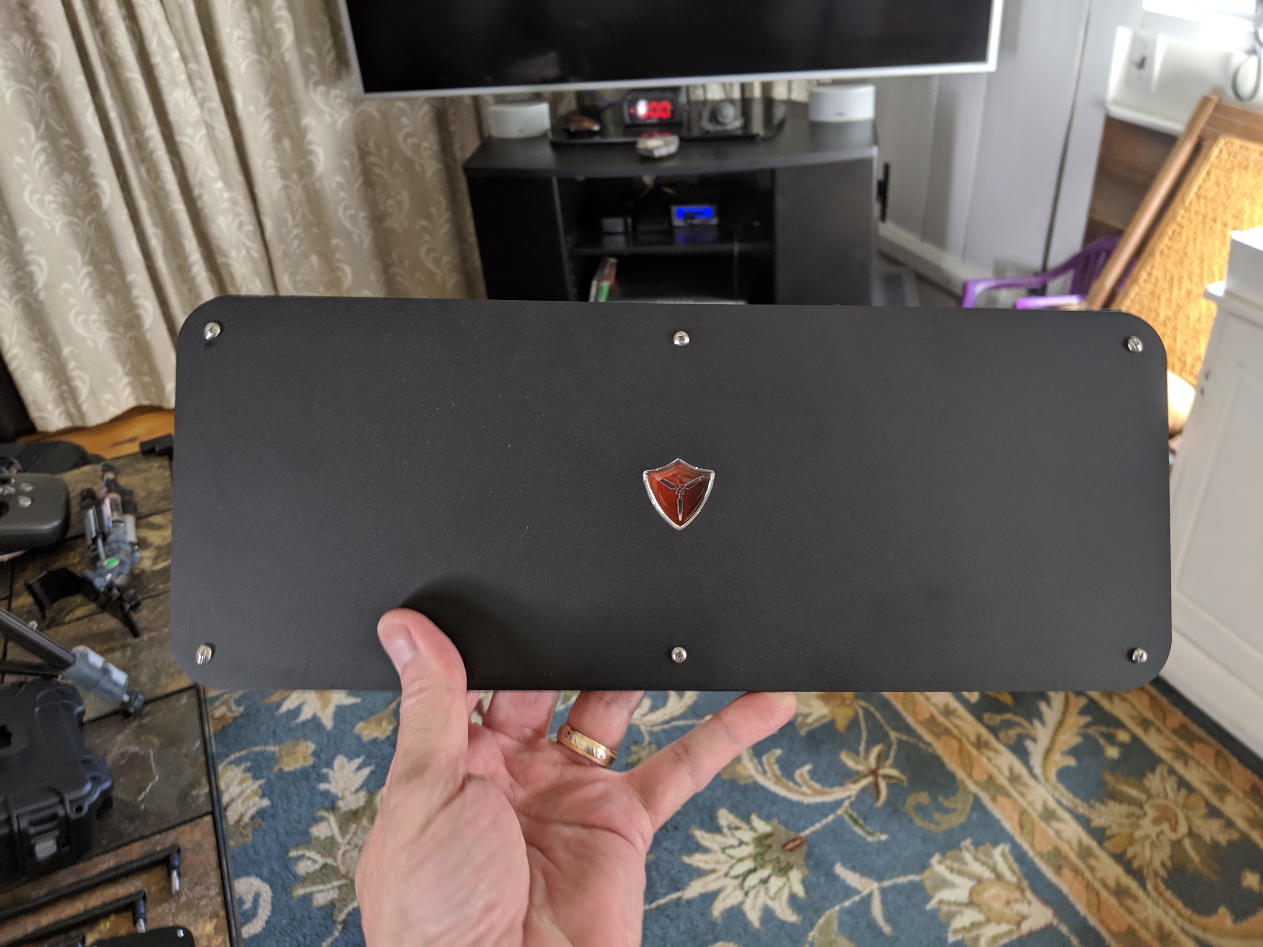

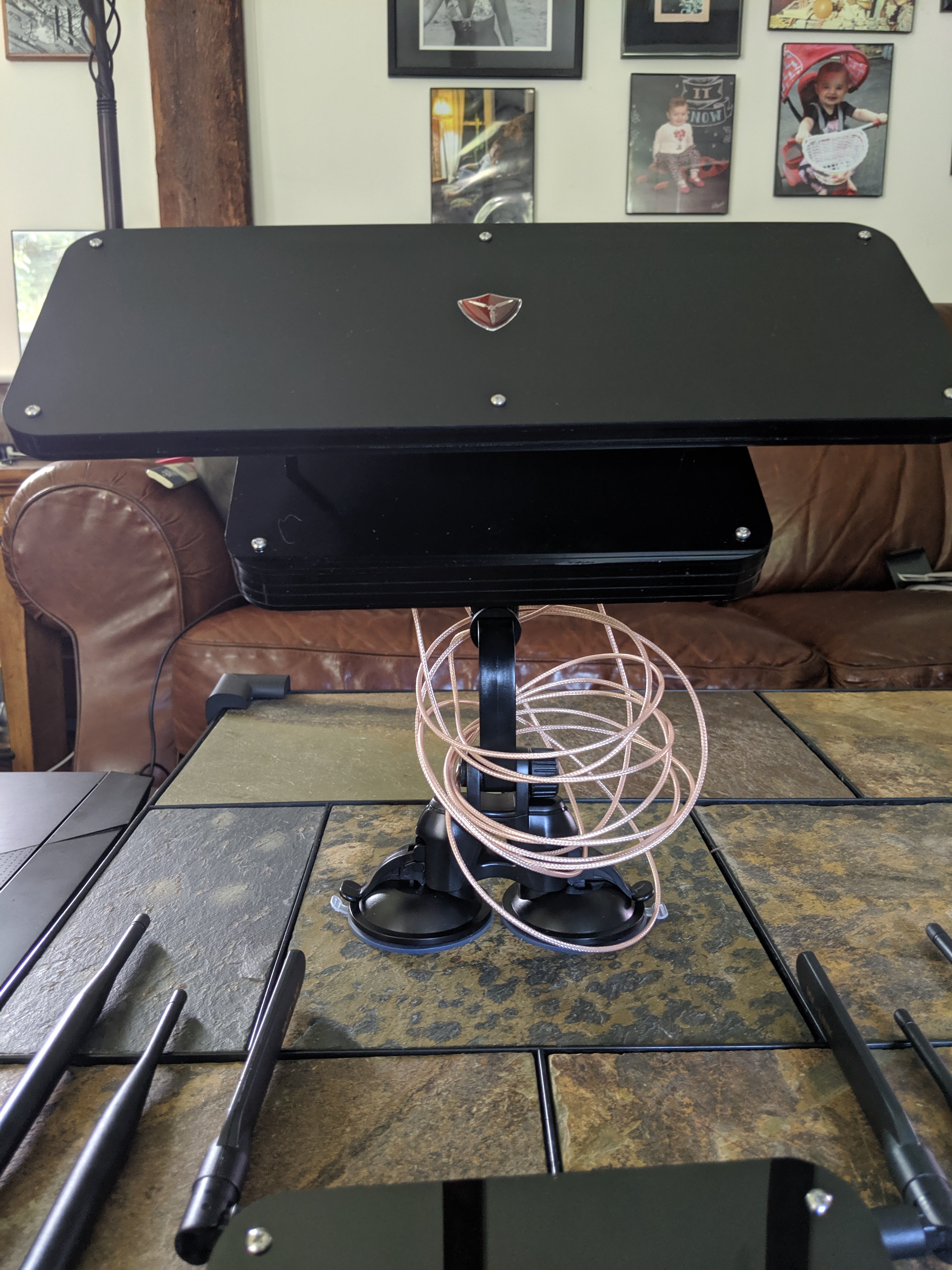

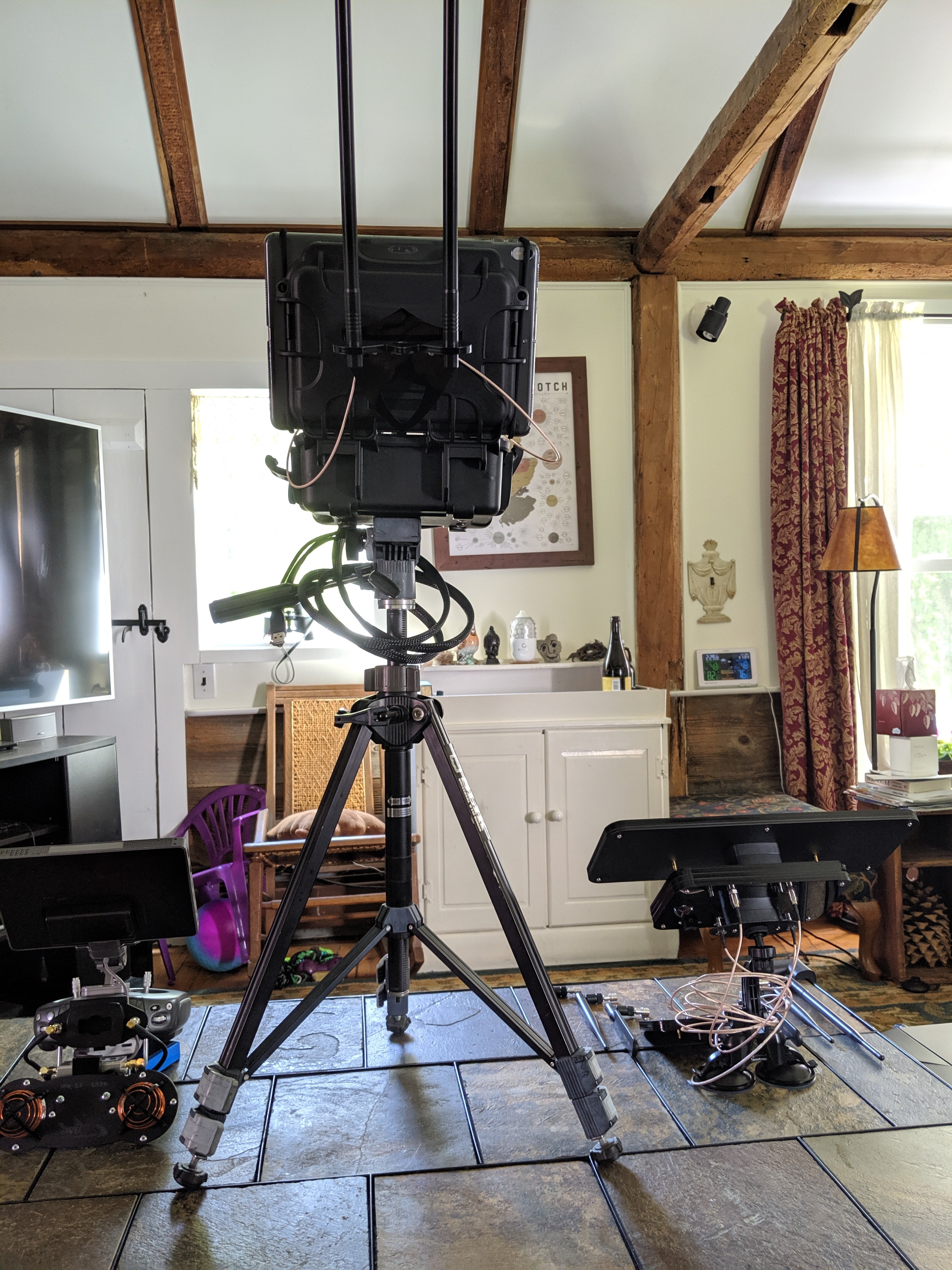

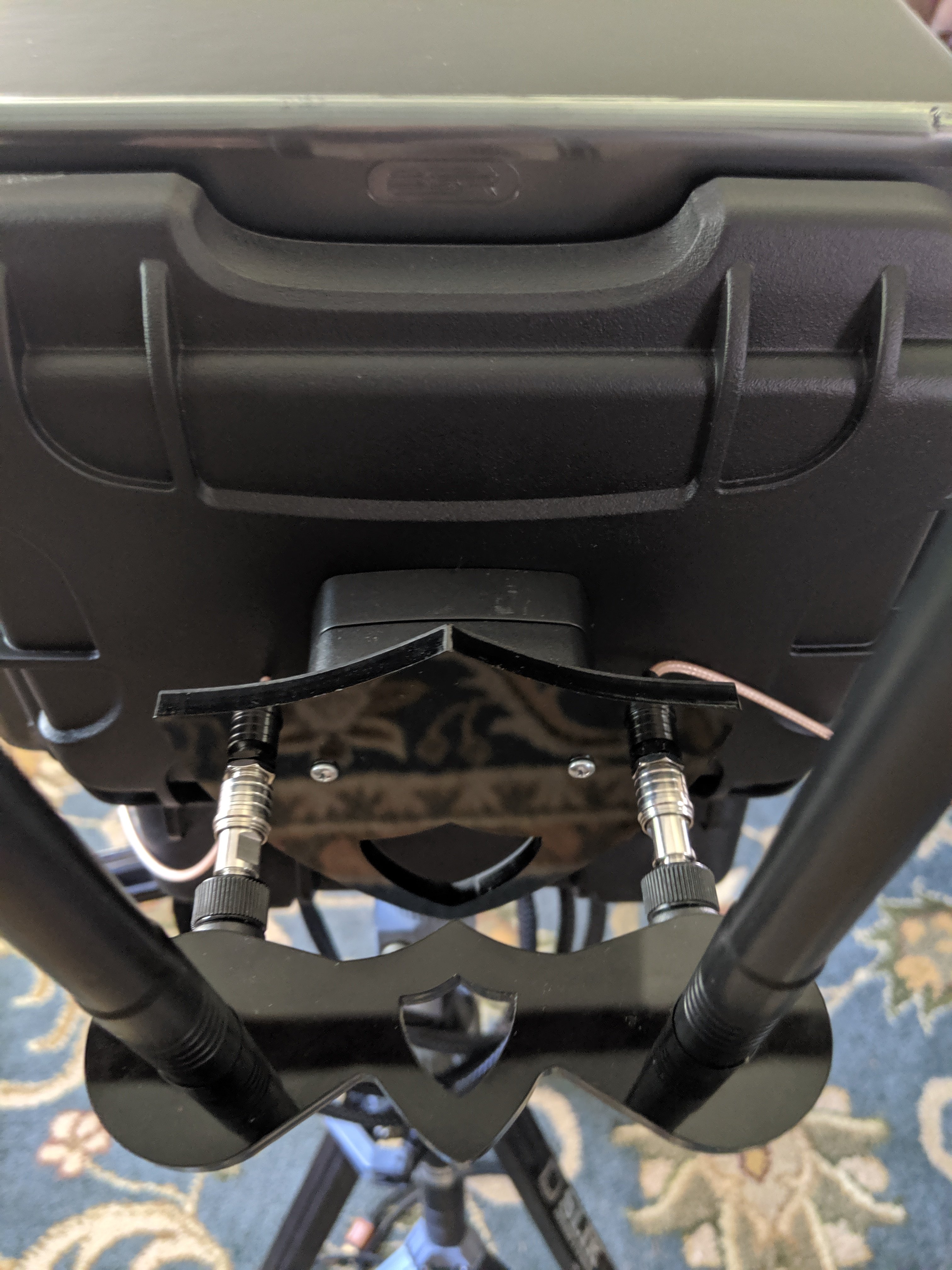

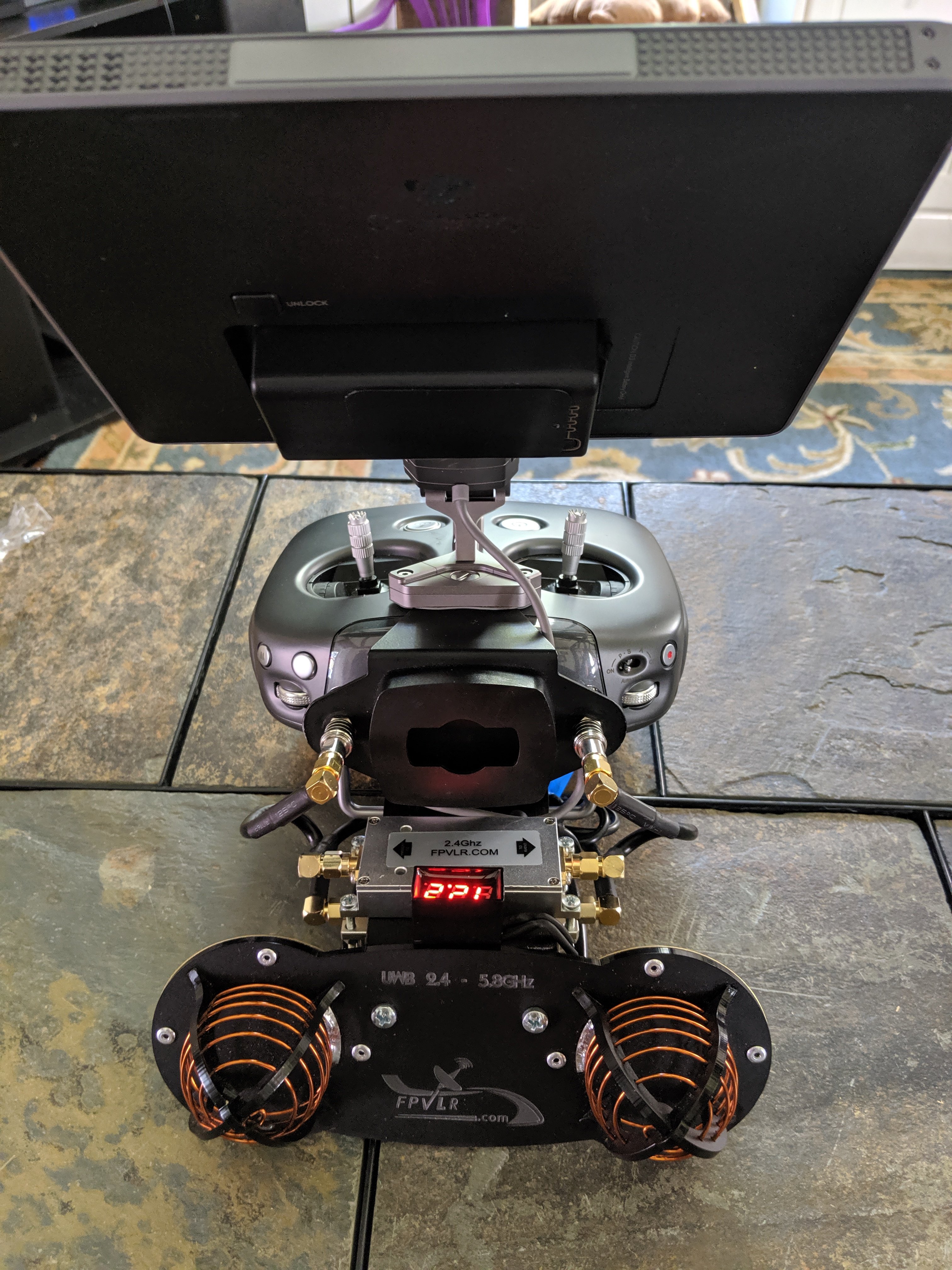

I have a Phantom 4 Pro with both a GL300E (with screen), and a GL300F (no screen) I use the GL300E when I don't need boosted power, and it works great, as mentioned above. On the other hand I had my GL300F modified by Titan Drones to use with the amplified "Switch" system, as well as they're "Command Case" amplified system. I have all of the antennas they sell, and they all work in harmony with each other. I also bought a FPVLR amplified Circular Polarized "Boobie" setup that I modified to use all of the Titan Drone quick disconnects to seamlessly work together. With all of the amplified kits, I can fly in dense wooded areas where I live, with just amazing results! The Titan directional panels, and the Boobies are great for penetration, but like the 4Hawks, you need to always have it pointed at the drone, or it will disconnect. The FPVLR Boobies are somewhat more forgiving directionally. With the Switch, or the Command Case, I just snap on the 16" Omnidirectional whip antennas, and just stand there and enjoy fabulous connections without worries of having to point in the direction of the bird.
Also, I see no reason you can't have your GL300E Pro+ controller, If 4Hawks can't do it for you, I would contact James at Titan Drones. I'll bet that he can! Let me know if you need any help!
