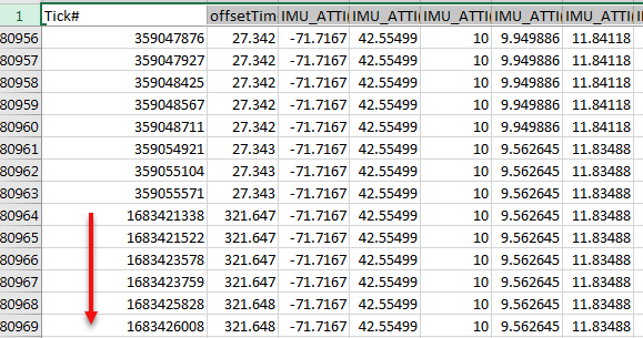

That may be the correct file, but it is not converting properly in DatCon - I only get the first 25 seconds of the flight, even though DatCon thinks it lasts 321 s.
Any ideas @BudWalker?
The .DAT wasn't closed properly. Almost certainly because the battery was abruptly disconnected.

The .DAT file is written in blocks - just like in a normal file system. Records are written into a block until the block is full. At that point the block is "closed" and future records start being written into a new block. When a .DAT file is deleted it's blocks are then made available to be used in a new .DAT file. When the last record of the log is written to the .DAT file the location of the last byte is recorded within the block. If that didn't happen then it looks like there are extra records - past the last record that was actually written. The bytes for those extra bogus records are whatever was in that block from the last time the block was used in a file.
You can "recover" by ignoring those last data points. Or, you can modify the .csv and remove those final rows. I ran DatCon at the highest sampling rate and then deleted these rows.

Right - I remember getting spurious additional data, but in this case it appeared to be missing data - I never saw those additional rows. Maybe that was due to the sample rate I chose, which was 200 Hz. In any case, I guess that means that the flight was that short, so no problem. Thanks for the reminder.
