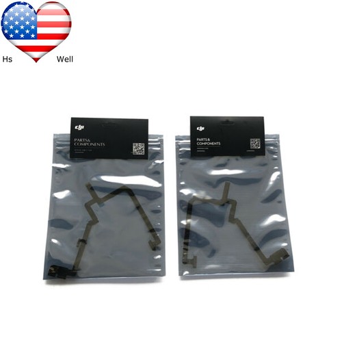

I never do a yaw motor or gimble after a mishap without doing the ribbon too. Not visible but they fail more often than any other part. What is happening to you is common. ONLY use DJI original replacement, 3rd party rarely work.
Thanks were do i get original ribbons, having problems finding the site. thanks
The slightest scratch on the cable will cause this. If u need a link to a cable on eBay let me know.
