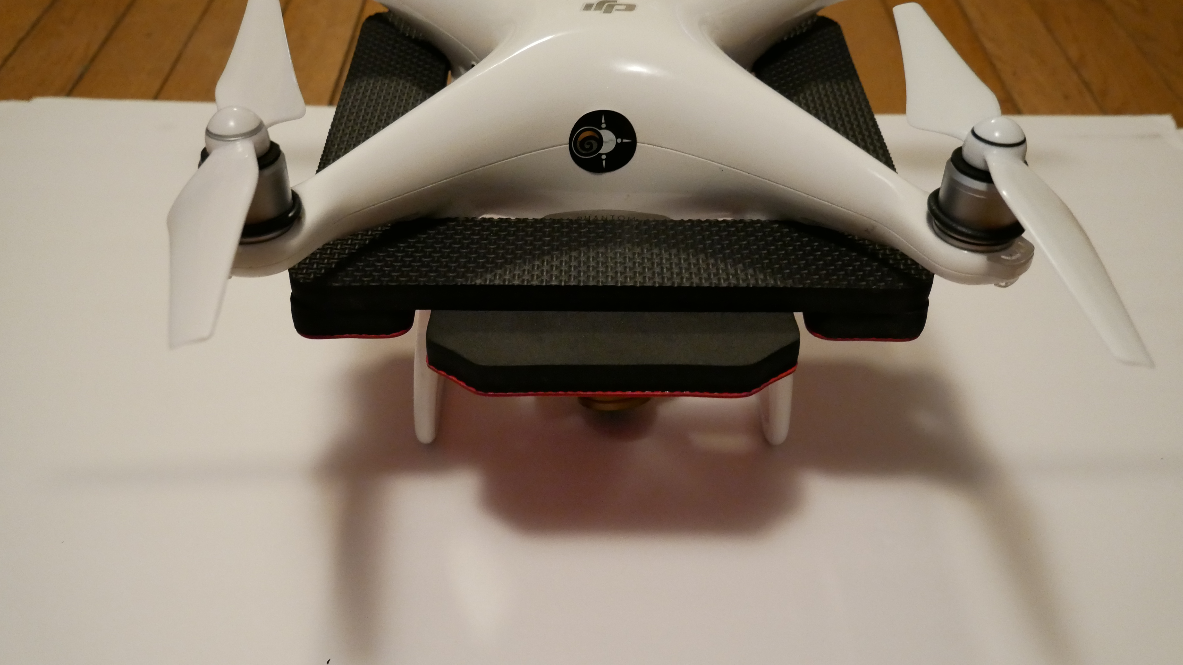

This is Phantom Rain. We are in the process of releasing the Phantom Rain Rescue Jackets that are can allow the Drone to float on water do to a crash or early landing on the water. We have been thinking about using the Rescue Jackets as a platform to hide the wires add the extra batteries to the Jacket itself as its locked in. Can you tell me what the extra weight is on those batteries. The Rescue Jackets weigh in at 3 ounces . The Phantom Wet Suit weighs in at 2.5 ounces do you think it might work.
Even just adding 1 extra Battery would be interesting , do they make them in different sizes and or shapes ?
