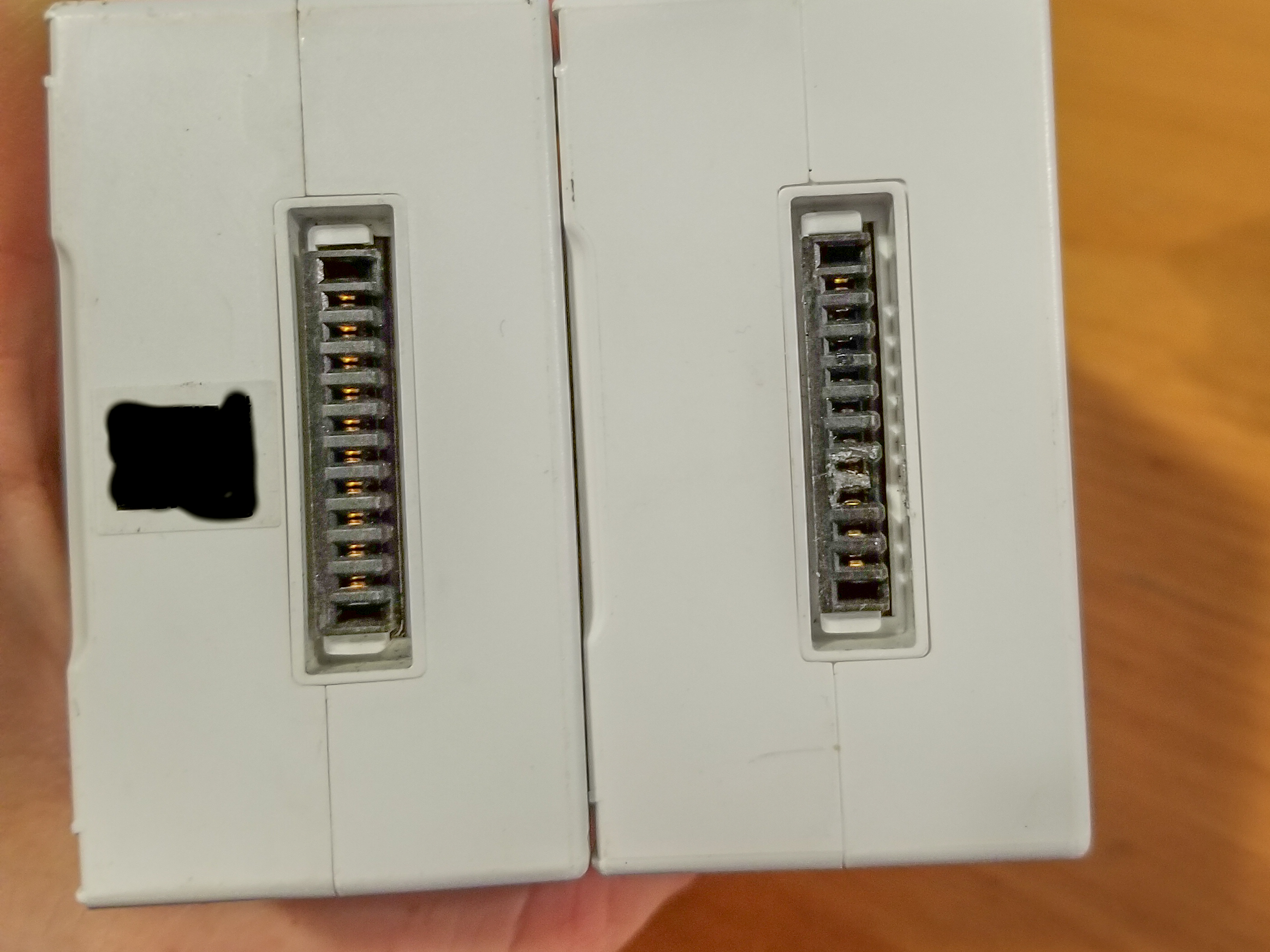

Same problem with melted battery contacts on my refurbished Phantom 4 pro after only one month and maybe 10 flights. Totally unacceptable. Caught it early this time and only melted one contact pin.
I was using the same battery DJI sent with the refurb.
Proof this IS a design flaw and DJI only applies band aids to the issue instead of redesigning the connectors so they don’t melt and fail.
I’m sending it back AGAIN and hopefully I can sell the refurb without even activating it. This is ********.
OK i got my “repaired” Phantom 4 Pro today with what appears to be a new battery.
There is one problem though, they returned the same P4 I sent in ( no issue there) but they did absolutely nothing to fix it.
It still requires activation on power up, but no repairs performed whatsoever. The damage to the battery connector was much less severe this time with only one pin melted, so I guess they thought that was fine, LOL.
There was a replacement battery board listed on the invoice, but that didn’t get replaced.
Oh well, I can only laugh at the situation.
I guess if I want to get the battery board replaced, I need to take a blowtorch to it and melt those connectors good before sending it in.

I had the exact same problem today. My drone has about 80 hours of flight and the original P4P battery with about 75 cycles got glued to the connector of the drone. I had noticed that one of my batteries was extra hot at the bottom few days earlier but didn't see any damage and considered it a one time thing... but I guess not! By applying quite a lot of force I managed to pull the battery out and saw molten plastic around one of the connector pins. I flew 2 more batteries after that to complete my project and there were no issues. In the picture below I already cut out the moten bits from the connector but you can see where the damage is.
When I compared the molten connector to those of all my other batteries I saw something important. All the pins inside the faulty connector seemed to be way further apart as opposed to the connectors of the other batteries. In my humble opinion there in lies the cause of the problem. As those connector pins somehow got loose over time, the contact with the drone connector deteriorated which caused overheating. I was lucky that my drone did not drop like a rock. At home i tried to pry those pins out and see if I can "restore" them to what the other batteries look like but they would not budge. Let me know if any of this makes any sense to you as it may be a way to screen batteries for this potential issues before it actually stats a BBQ inside our drones.
