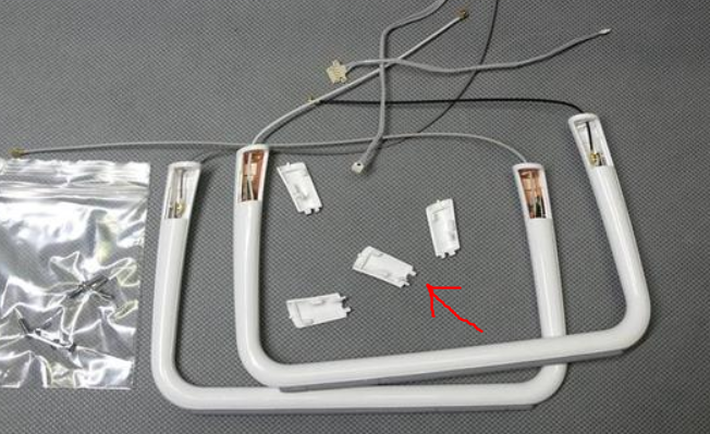

Speaking of the wire and screw covers.....
I need a set (4) of them. I contacted DJI for a part number, 9 emails later and them wanting purchase date info, serial numbers, date of birth, etc....I gave up. Other than buying a whole set of landing gears to get the covers, anyone have a spare set or know where to get them without buying the whole package with new landing gear legs...part 26?? Thanks.

Thanks for the info. Anyone know what these parts are called and where I can find replacements for a Ph4pro?
