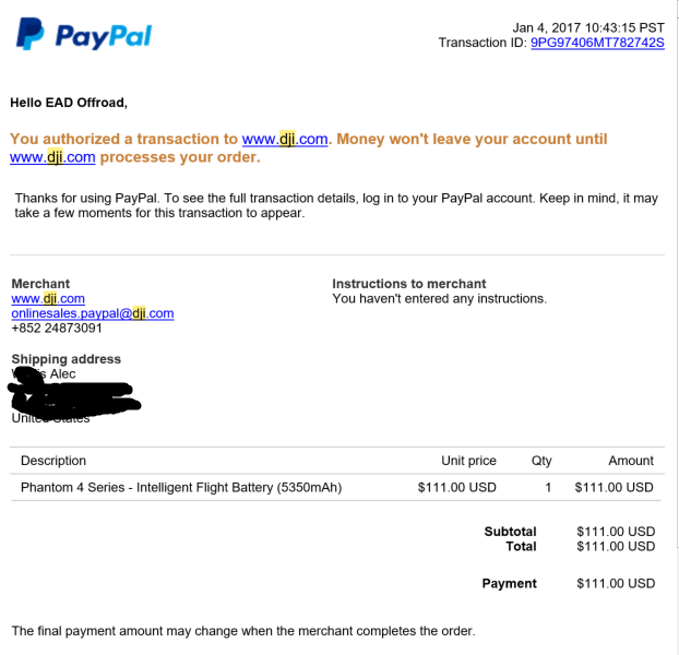

Back to $159 right now. They were actually $111 the other day so keep an eye out.
