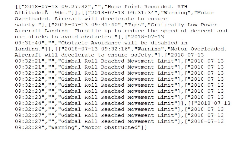

I located the flight in the FlightLogs and I used WordPad to open it. Notepad opens it as well but not near as much info is shown??nSo I saved it to a jpg file to post here.
Also in FlightRecords there are two files but they are in swahili and I cannot read these. They are much larger files and are likely the ones you need to send to DJI if they are looking into it. If there is a way to view these I have not found it yet.

I did see this video on Utube and studied it in length. I did consider opening the battery and trying the RESET procedure. But decided to research all other options before I tried this option.

AirData translates swahil quite well. Thank me later. Enjoy!

Got AirData and was able to view the files needed. Indeed one of the four cells has an issue. It comes down faster than the others during flight. Thank you for helping me with this issue.
