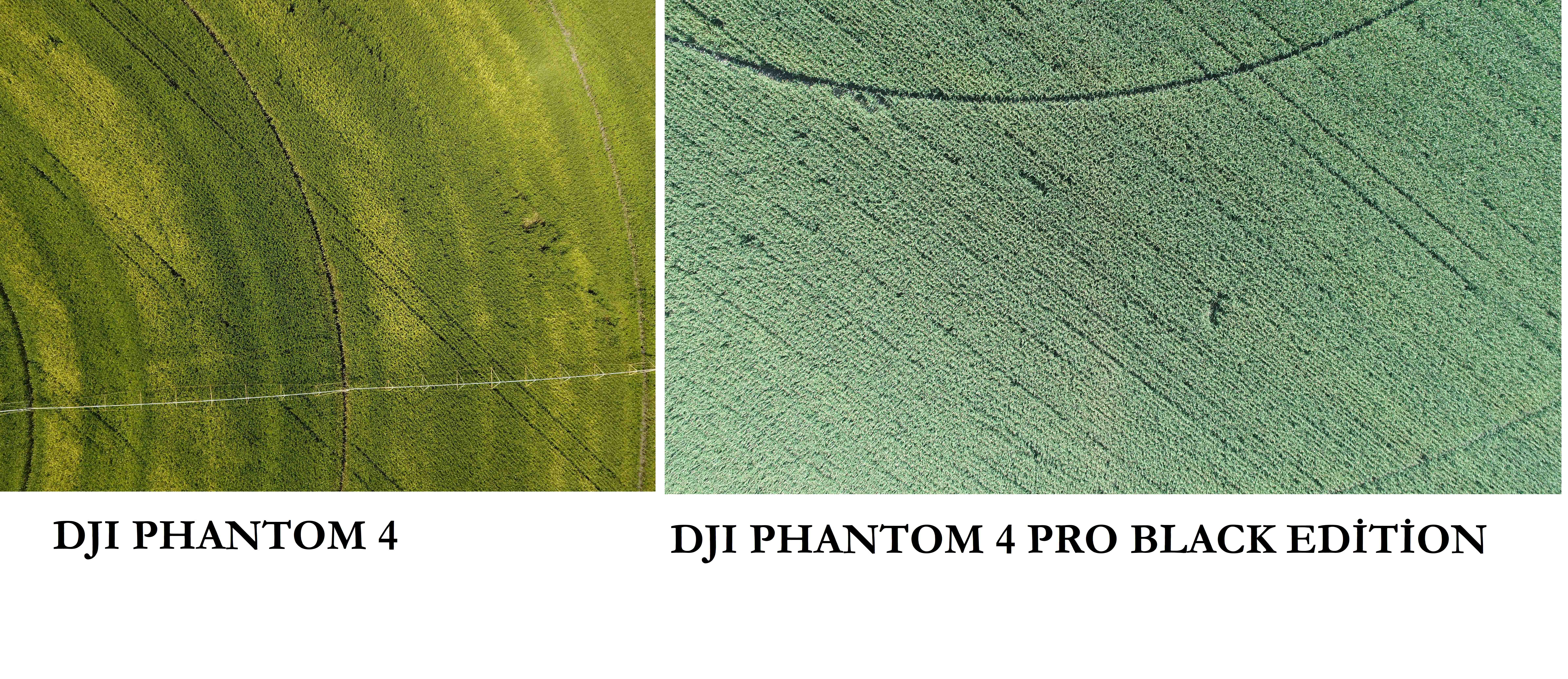

Hello to everyone,
I have 1 Phantom 4 and 1 Phantom 4 Pro Black Edition drone. I am using with automatic flight program. But there is a color difference between the photos taken by 2 drones. Phantom 4 Pro Black edition makes it very bright. Phantom 4 makes it lifelike. What can I do about this topic?
Thank you,d
Hello to everyone,
When your images look too blue or too yellow, that's a White Balance issue.
If you have WB set to Auto, it might malfunctioning like one of my drones was.
The solution is to manually set the WB manually to match the weather, sunny or cloudy.
If you had set WB manually, you might have had it set incorrectly.
