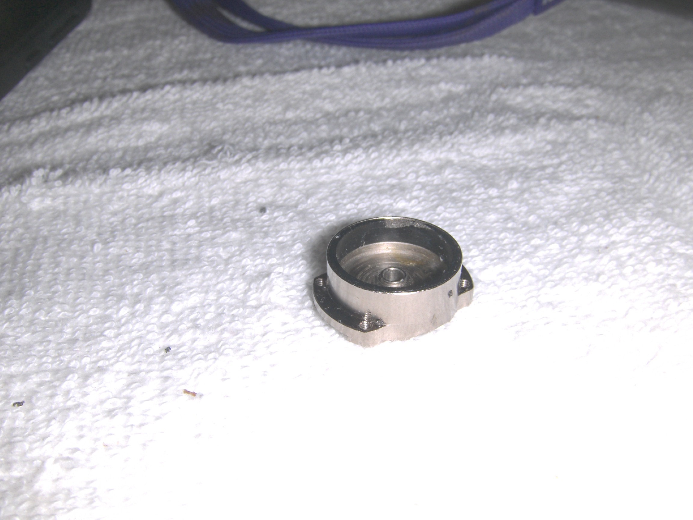

I had to step away from this for a few days, life has kept me busy. Took a couple of pics, but they are not really focused enough. Will have to get more, but this one should give you an idea of the damage.

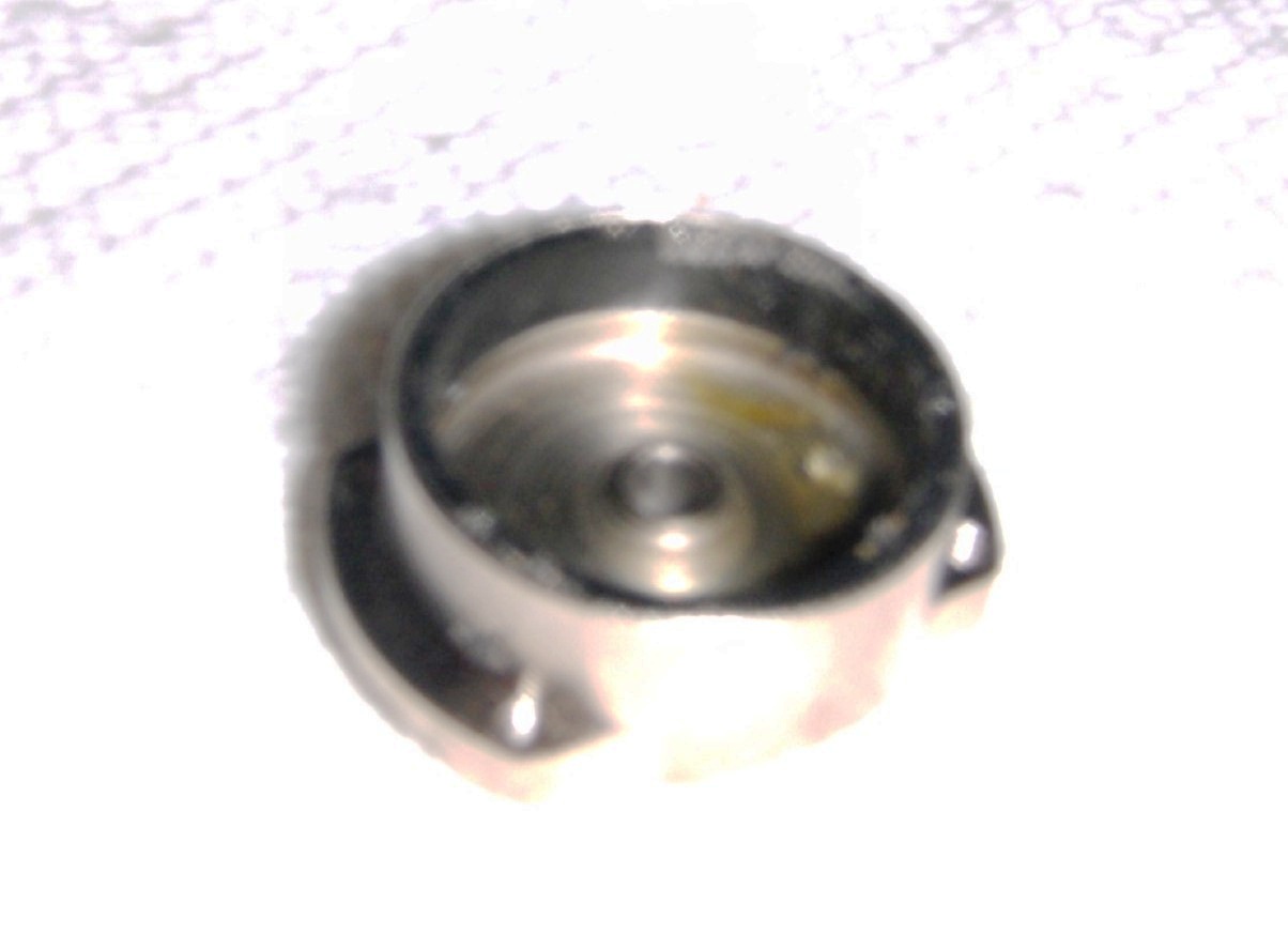

I managed to find a complete donor P4A and used the yaw motor's casing with mine machine I've installed everything and it seems to be working OK so far. I got a better pic of my original yaw motor casing and it shows the damage to it. Still usable or is it roached? If so, I'd like to find a used motor casing if anyone has good one you'd like to part with.

I would try that casing. It does look bad but It could still work. Clean it out to be sure there are no debris in it. I use acetone and a q tip. Acetone is finger nail polish remover.
