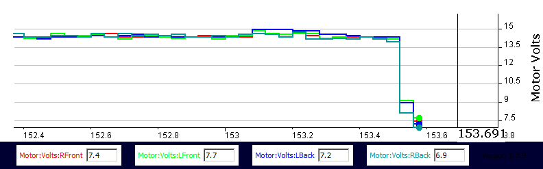

Sorry for the delay. Here is the file. Dropbox - DJI_ASSISTANT_EXPORT_FILE_2017-12-01_10-43-16.DAT
This appears to be an abrupt-power-loss incident. At the very end of the .DAT recording the motorVolts dropped from around 14 volts to around 7 volts. The .DAT can't distinguish the cause of the abrupt power loss; i.e. was it a battery failure, battery coming loose, or something else.
Thanks. The battery was still in it and the camera still working after it fell from the sky. The camera view is what helped up find it.

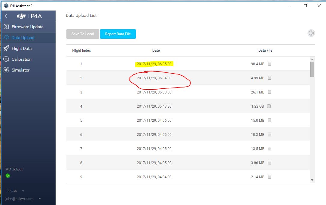

There are other flights shown, but they were listed before the final flight. The one circled in red is where I rebooted it before my flight because I couldn't get a GPS lock.
OK - that's weird. It looks like it is no longer generating DAT files. I'll have to think about that. @BudWalker ?
I didn't do that many flights that day. Just the one highlighted and the one that I circled. The other ones listed must be from when I fired it up after the crash.
Something is odd about the time of your flight. The GPS data says the flight took place at 2017-11-28 17:12:21 GMT. That's 2017-11-28 13:12:21 your time?
But, other parts of the .DAT say the flight was at 2017-11-29 06-33-28 This matches what the Assistant is showing. Which one was it?
I believe the 2017-11-29 06-33-28 time comes from the tablet which wouldn't have been available for the flight we're looking for. Could you check the flights to see if there was one at 2017-11-28 17:12:21, or there abouts.
I've always had trouble with the time since getting the P4A+. There may be a way to set the time in the built in tablet, but I never found it in the settings. The time of the flight was what was shown in the GPS data, 13:21 on 11/28/17
