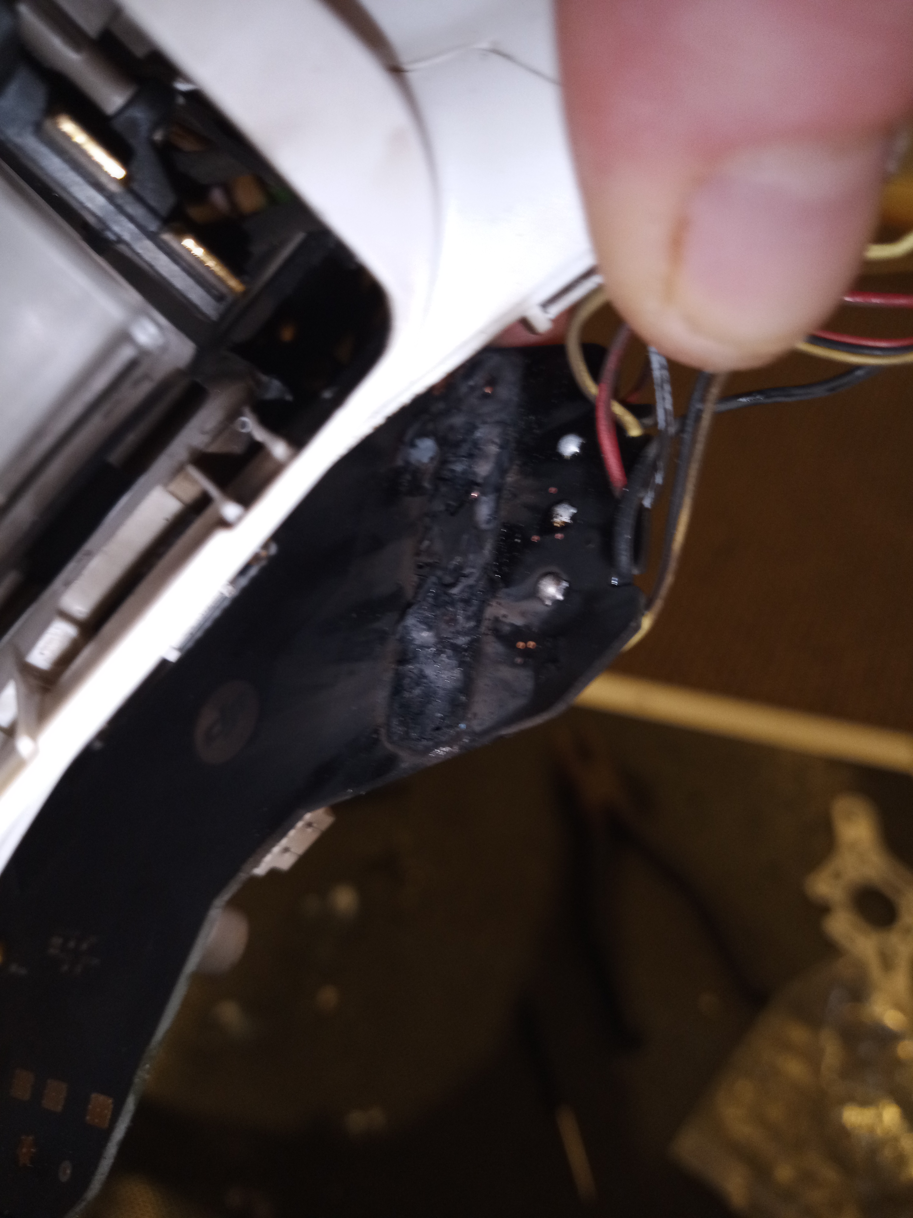

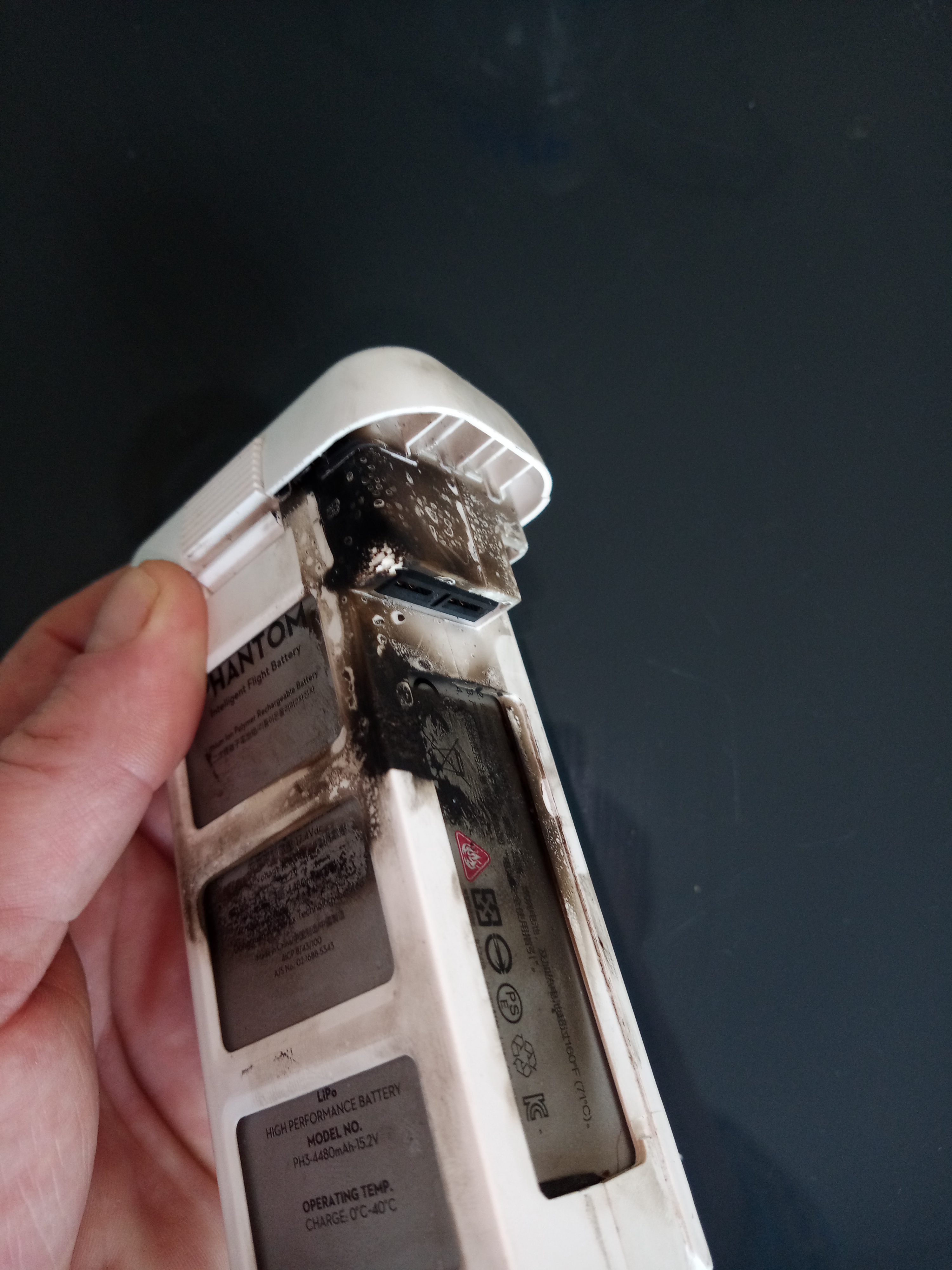

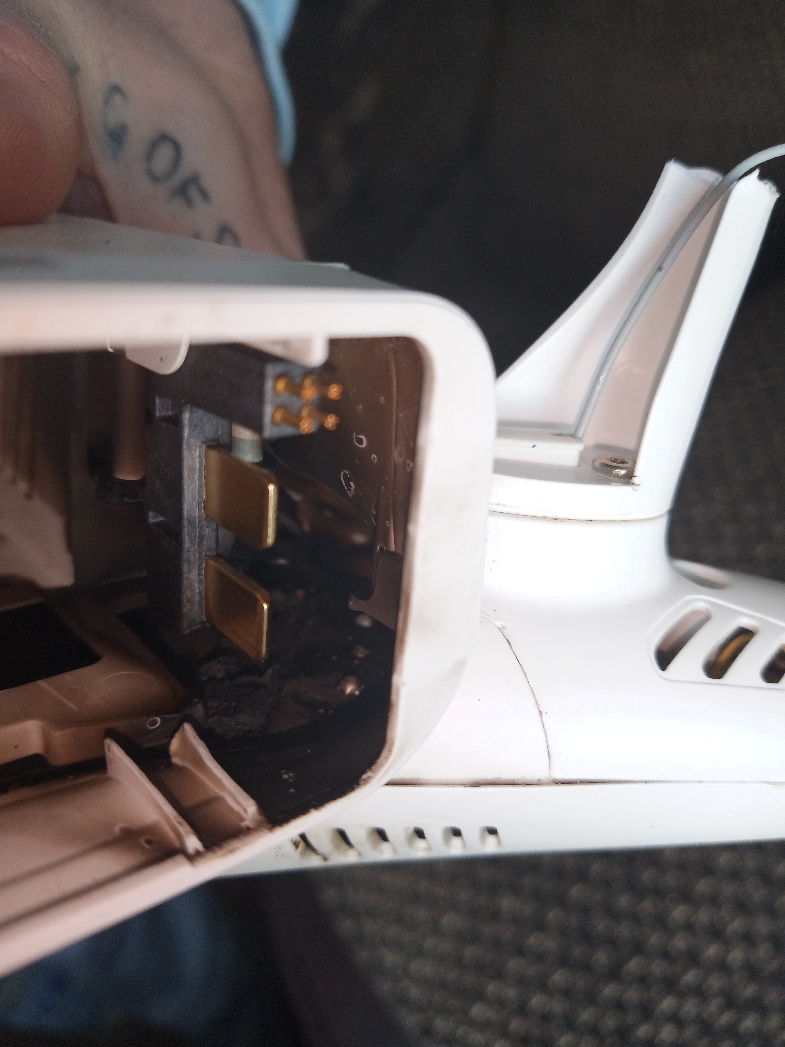

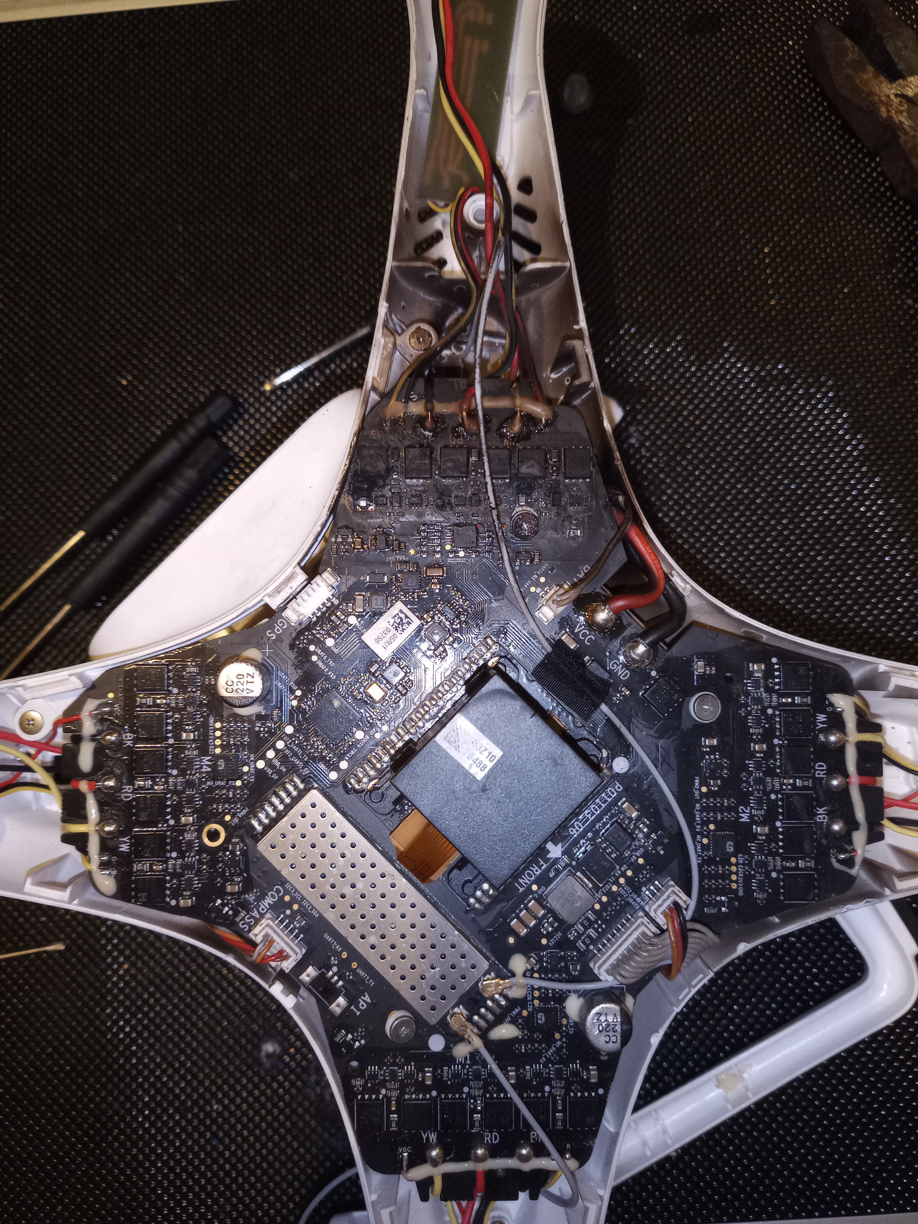

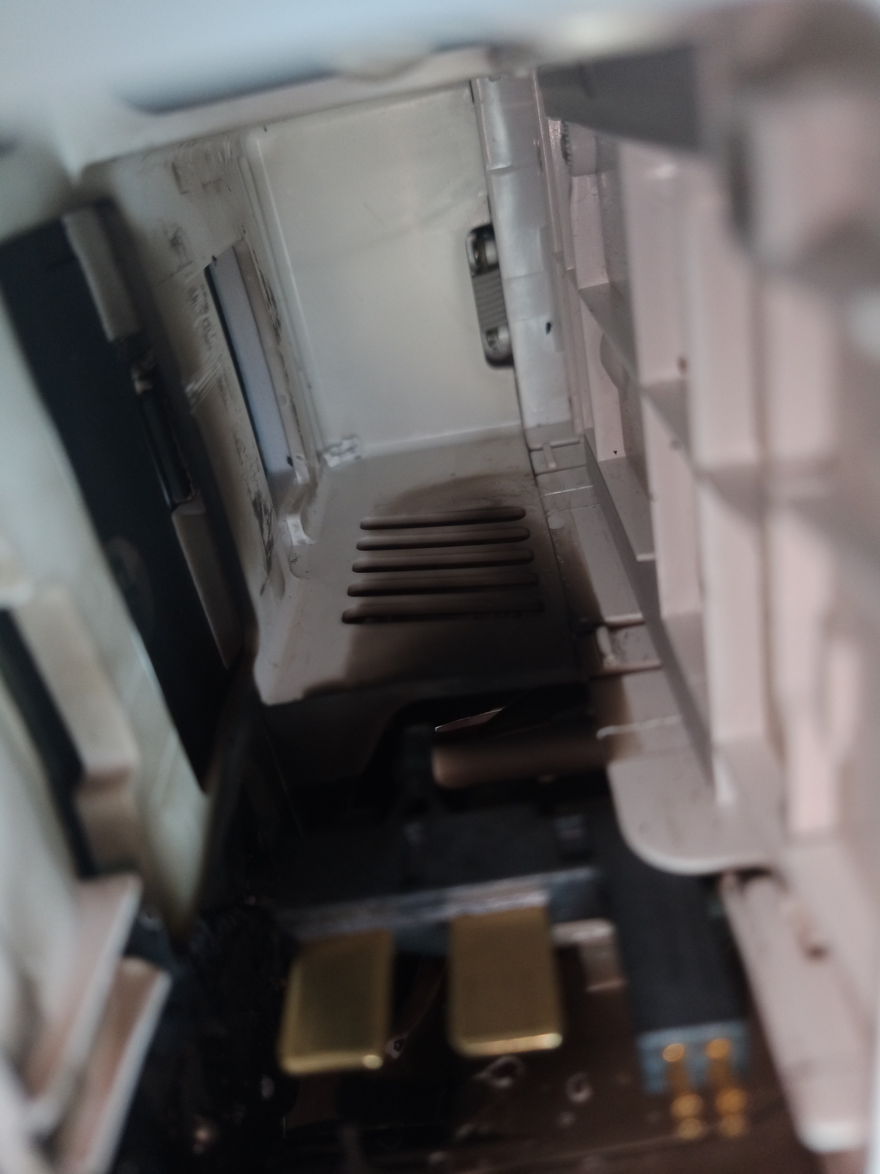

The battery is burnt but it doesn't look like the battery was the problem I'm thinkin it was the board as the damage is more inside the drone than the battery if that makes sense the battery looks like it's just got surface damage because of this I will attach pic when I am home cheers
Was the back left motor that was damaged

That's on the motor that broke the propeller!! could that have done that thanks

Could have been because that motor was damage ? And wud that destroy my new phantom if I use it in it cheers
The battery I mean sore
I think it’s unlikely that you’ll find the exact cause of the catastrophe. It’s sad to see the extent of the damage.
I've tryed the battery hold for 5 second an 3 lights are stayin on and 1 is flashing which indicates a broken cell am sure . So would that make the battery unsafe it's my 2nd battery just sad the price of them ?
The 5 second hold on the battery switch tells you the percentage of battery health. 3 lights staying on means the battery has approximately 75% life.
I think because of the damaged motor the esc mosfets burned and short the battery.
