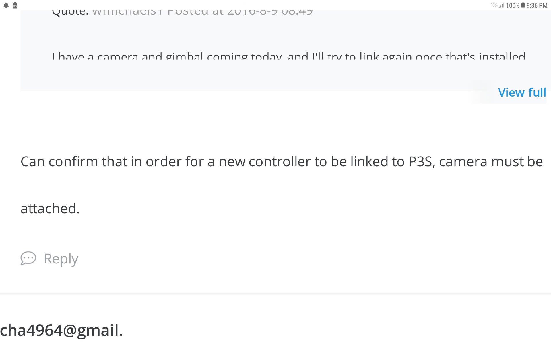

Ribbon sets are cheap and gimble parts on Ebay cheap too unless someone here got some spares,,I did just find this post,,,,best of luck and sorry couldn't help but keep updates coming,,,,,,,just add it says new remote but since old remote not linked ,,it wont because cam assembly not there which is pretty stupid really
