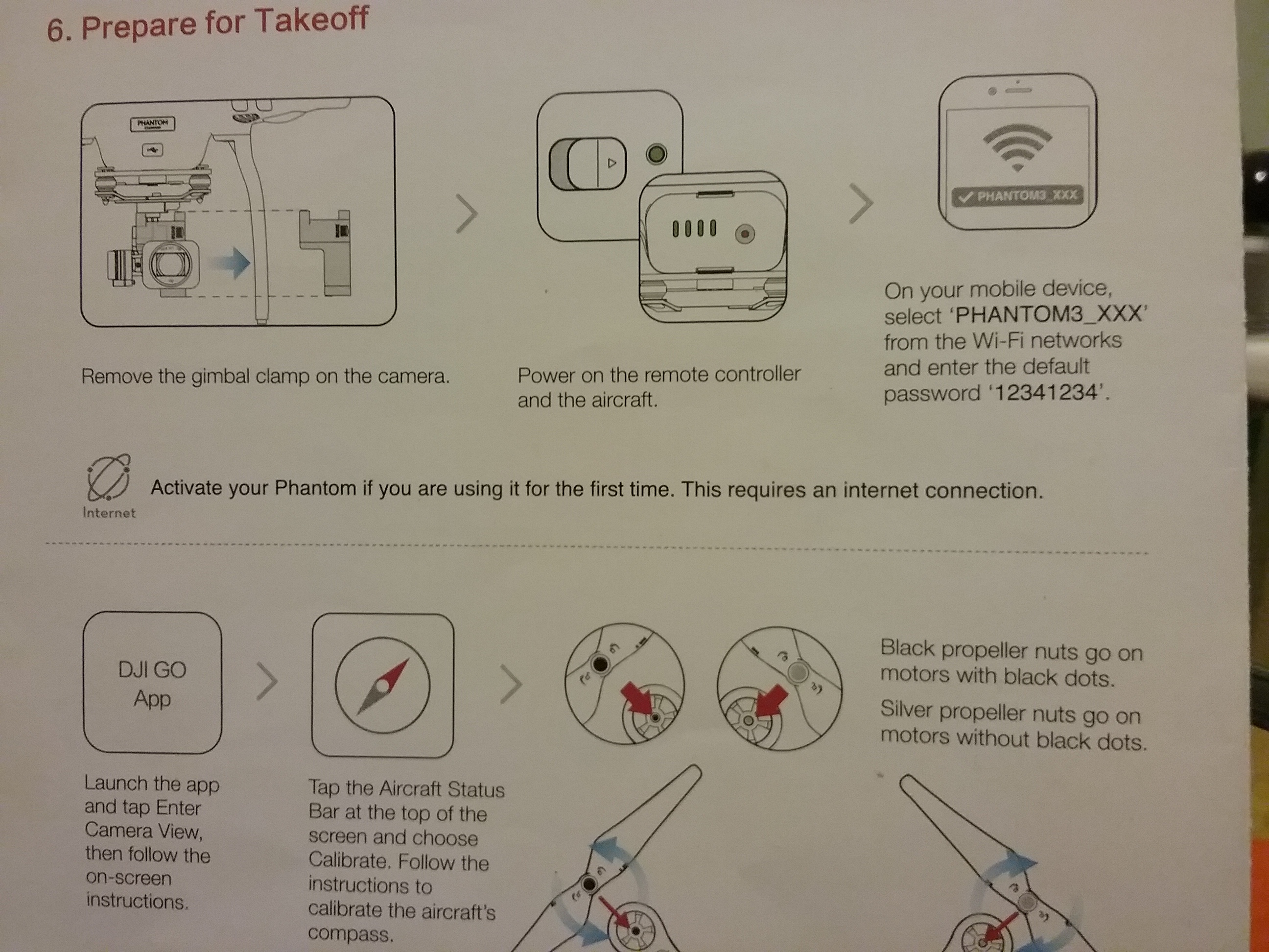

Wow ,,is it conected in wifi,the password (phantomxxx12341234) ??, are all lights on remote red or just one???

Hey i been thinkin if got second hand you will have to enter phanton password to your wifi device the it shoud conect with drone,,good luck:)
I've tried just about everything. I can't get it to work. I've tried through the Go App. Link RC.. Fails. I've tried linking using controller and Drone, Fails.
U needto do this on your device for phantom to conect
U needto do this on your device for phantom to conectView attachment 78602
Ianzone, Thank you for step 1 basics... but I already tried that with no success. I use and iPhone 6s and the Wifi is connected. The Go App connects to the RC but not the Drone. I've spoken to DJI they can't assist me in my problem either. It also won't update firmware via SD card and the Go App won't connect to the Drone.
