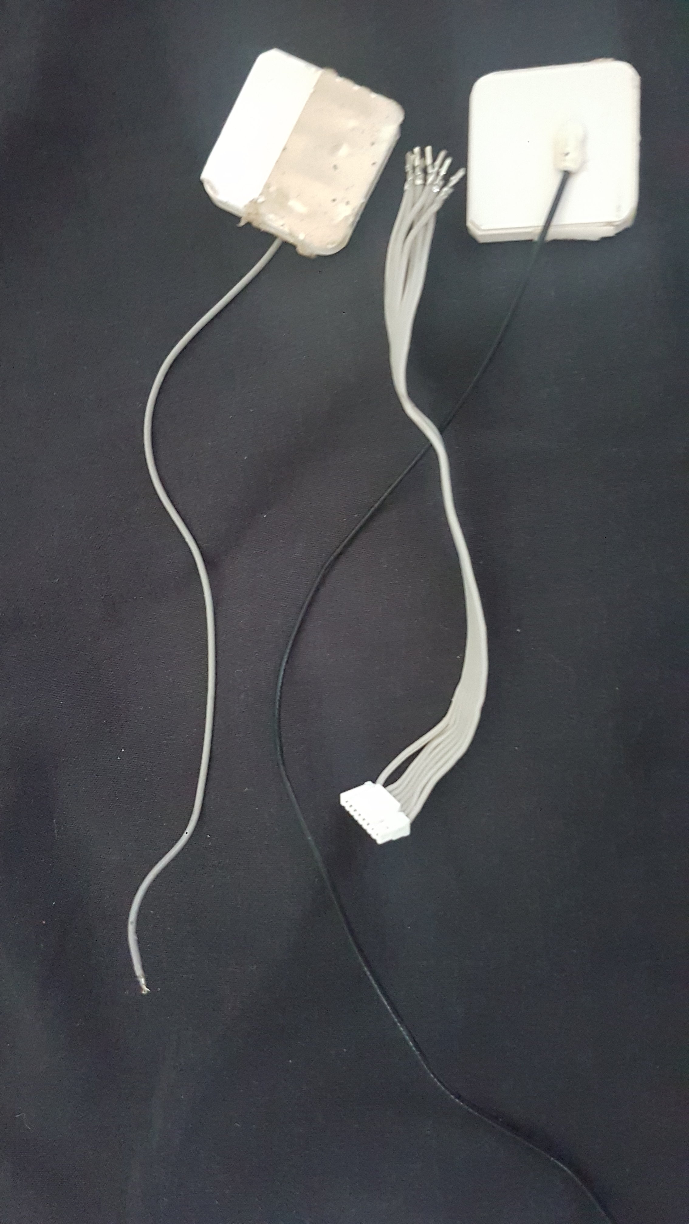

There are 3 wires connected to the gimbal, all of which i replaced. 1 is a ribbon cable and the other 2 which assumed were antennas are connected to a rectangle foam piece which sits inside the aircraft. I havent replaced the wires which run down the inside of the legs. Are these the FPV antennas?
Thanks
Ps i figured how to attach a pic of the parts replaced

You did it right.. but i dont seem to understand why the decrease in controller signal
