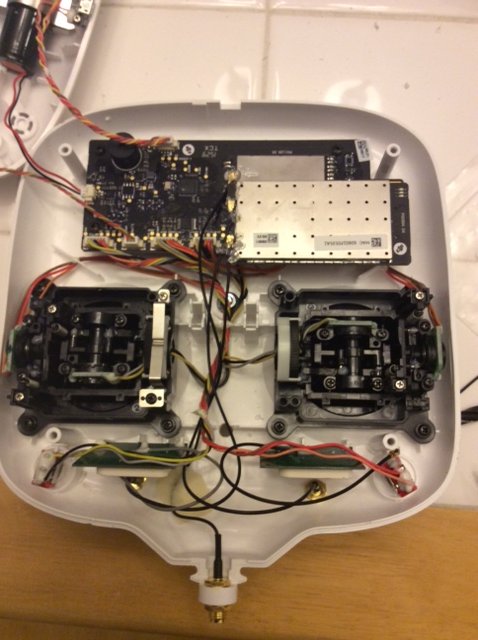

This image shows all three UFL to RP-SMA pigtails installed.
You can see the two 2.4GHz UFL connectors running to the RP-SMA on either side of the controller top. You can also see the 5.8GHz UFL connector by the heat shield arrow run to the RP-SMA connector that uses the OEM antenna port.
There is a lot of work not shown here, like the trim and relief work I did on the antenna port opening. Again... see the videos. Much better than writing. Or even better, think. Trust your own mind.
I used small dabs of clear low-temp glue gun glue to secure the 3 UFL connections, but NOT at the gold-plated connectors. Instead glue the line to a nearby shield or board to stabilize, keep the clean coax connector clean.
I used that dab of masking tape at bottom to temporarily hold the 5.8 tx line in place while the hot glue dried. You want to be REAL careful not to use any sharp bends or allow the pigtails to kink when you run them through the case.
