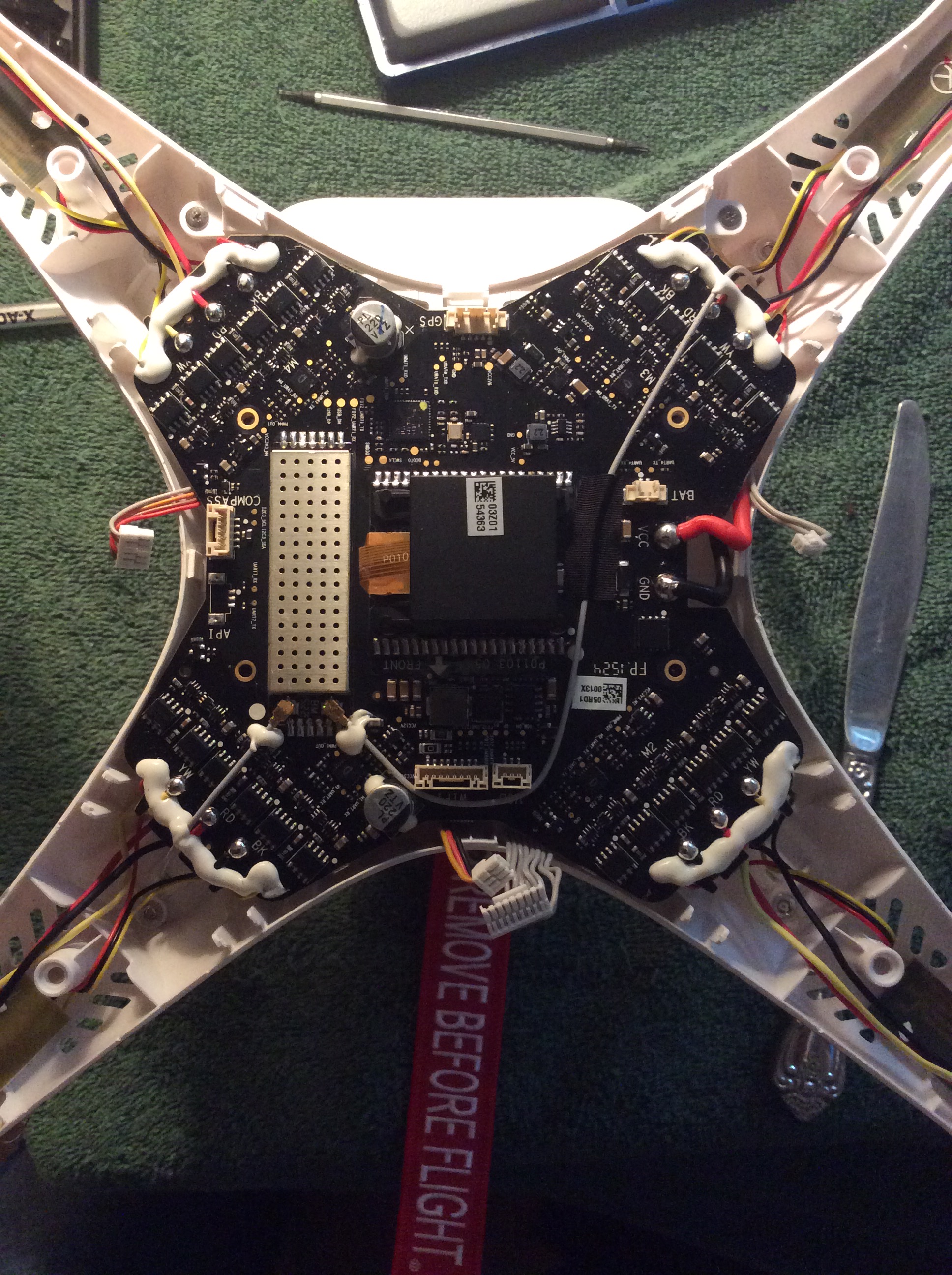

Tony, I'm only interested in repairing or replacing the antennas connected to the camera and board. Is it necessary to replace the control antennas when replacing antennas that are connected to the camera and board?
The cables above are the ones that i need to repair or replace. Looking for a way to avoid opening up the shell and desoldering.
Both of those cables go to antenna patch's you can see if you look in your battery box on the sides .
I just took the screws out of my board and lifted it a little bit and then wiggled them out with tweezers .I didn't de solder nothing .
If you wanted to put them back in it might be tight but there's only 2 solders you would have to do .
OMG.JPG You would also have to disconnect your 5.8 antenna cables.
View attachment 52390 You would also have to disconnect your 5.8 antenna cables.
Do you think stripping the end of the wire and placing it back into the connector would work? Is the antenna just one single wire? Thanks again for all the info.
Is no problem but I have never done that or even tried as I have never needed to . Maybe someone that has can tell ya but I am no help there .
Not saying it can't be done I just never have .
The antenna wire has the shield wire and a center wire..you cant just stick the wire into the connector..looks like this..i cut this one so you can see what the inside of the wire looks like..the silver wire is like a jacket covering the center..hope this helps..im not even sure if this is what you were asking lol
