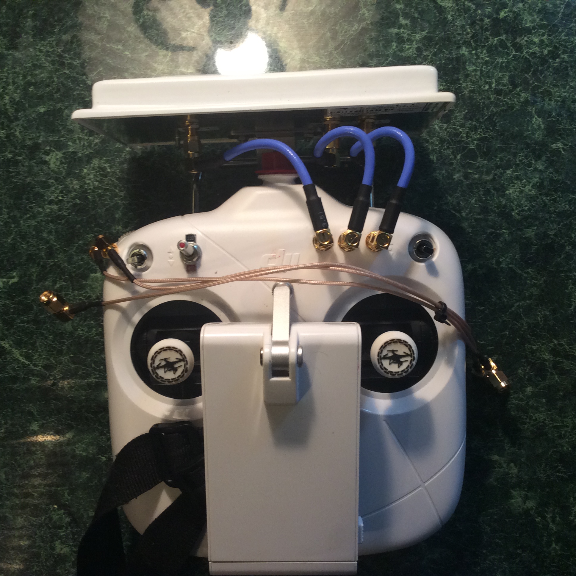

Phantom 3 STANDARD antenna upgrade
Looks great and ya did a great job Tom .
The hardest part I found doing these was getting the shell out of that circle at the top .
Now I've added the dipoles to my bird and gonna have to tweak them but gonna have to wait :(
Can't wait till ya try it and see what ya get .
^^^^ haha. Yeah, my weather is crappy too. Bout broke the dam circle thing. No-one said anything about that locking device. Silicone wasn't friendly either.
2.4 cables came out fine, but the 5.8 broke right off the snap connector?? If it was attached, it wasn't attached very well.
Was very happy I don't have to remove to install in my backpack,,, that's a huge bonus.

Mine lifted right off like that too and think that's why lots are not getting good distance's stock .
It is very compact and do like that way more the coil FPVLR stage 2 I have on my P2 .
Looks like hot glue ryback . We've been using that just to help hold the connecters down but is easy to remove if needed . Way easier than the white stuff DJI use's . Some use silicone but that looks like hot glue
thanks :) I'm definitely thinking about doing that mod ^_^
It's really not that hard . You do have to have a little patience though . Best 130.00 mod I've ever done . The other is when we started putting P2V+ extender on P2V's for that much and didn't get near as much distance .
All done, very simple.
Thanks again Dirkclod, cables look great.
Even fits in my backpack with the added hacksaw MOD.
Looks nice and clean. Those blue cables are so stiff, I feel like I might stress them twisting them around so much. Is that what that screw on top of the connector is for - to rotate it?
but I think it's for assembly. I didn't try removing it
It is Tim and I wouldn't mess with it . And the cables are tougher than you think Santiego .

Good to know. I was a little worried by the amount of force I had to use to twist and bend them. Thanks!

Just be easy but ya see how I did mine and was no problem .
