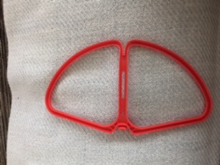

I bought these 4X prop guards asking for and received confirmation- specifically for P3S guards. This is what I received and can’t find a way to fit them. Does anybody know anything about these, before I toss them and look again.

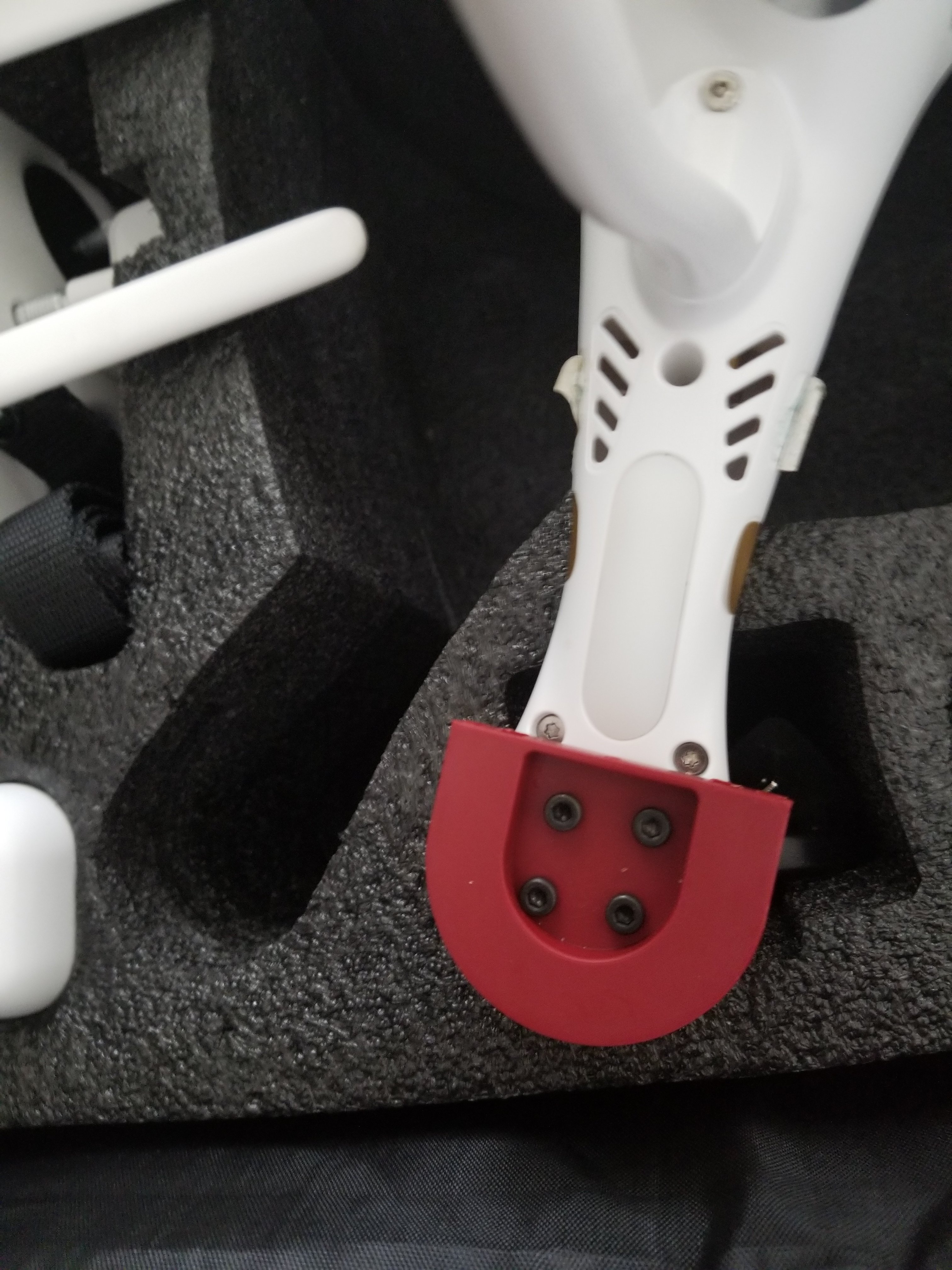

I have the same guards, They have 4 screws on each guard. They are meant to prevent tree leaves/branches from breaking the props.

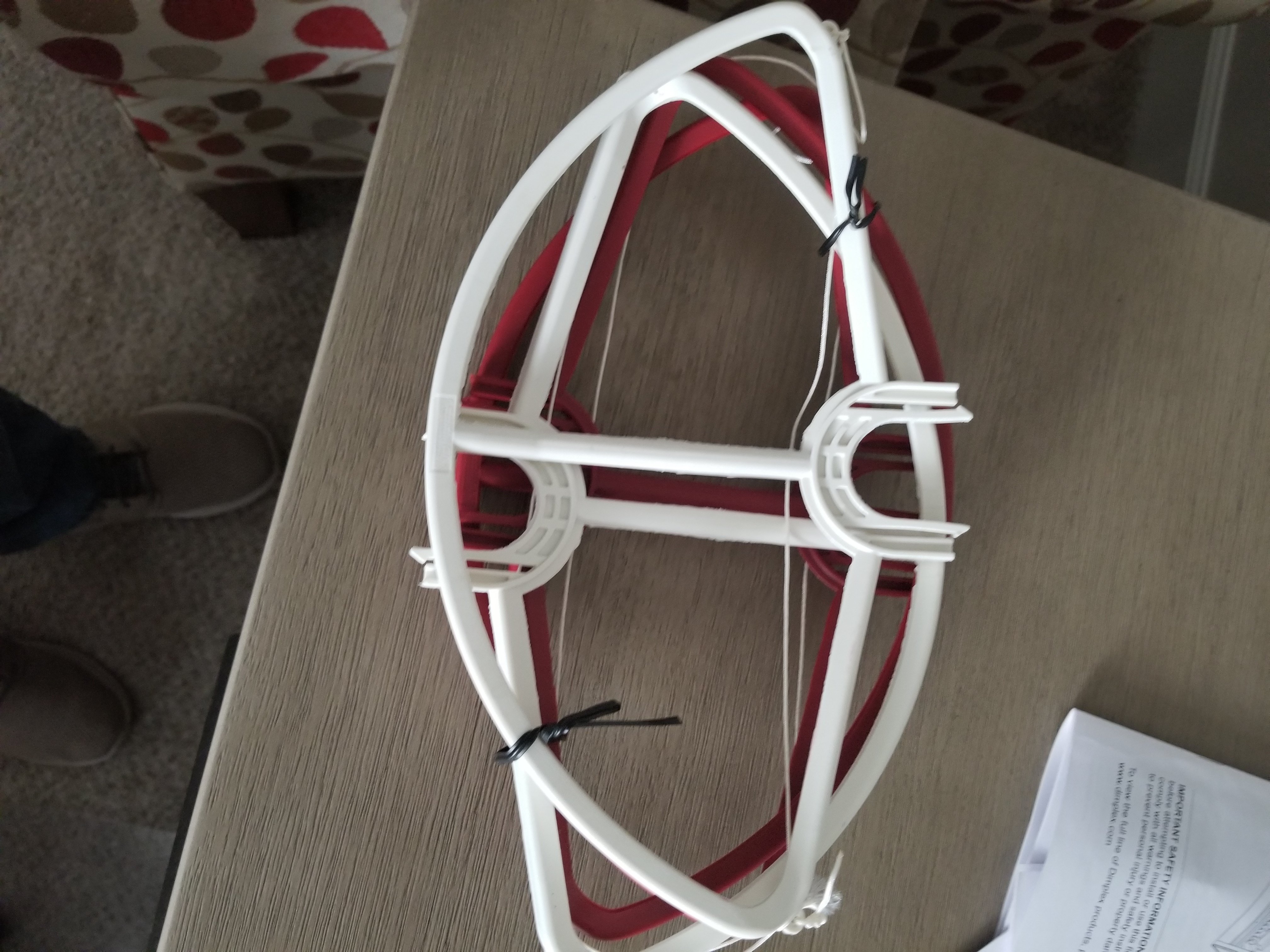

JerryA has the correct phantom 3 prop guards they have a notch and a clip that slide and clips into place. I never use my prop guards has I have juniper trees in my area and they average 30 to 40 feet tall. I on average fly 90 to 110 feet high never had a crash or run in

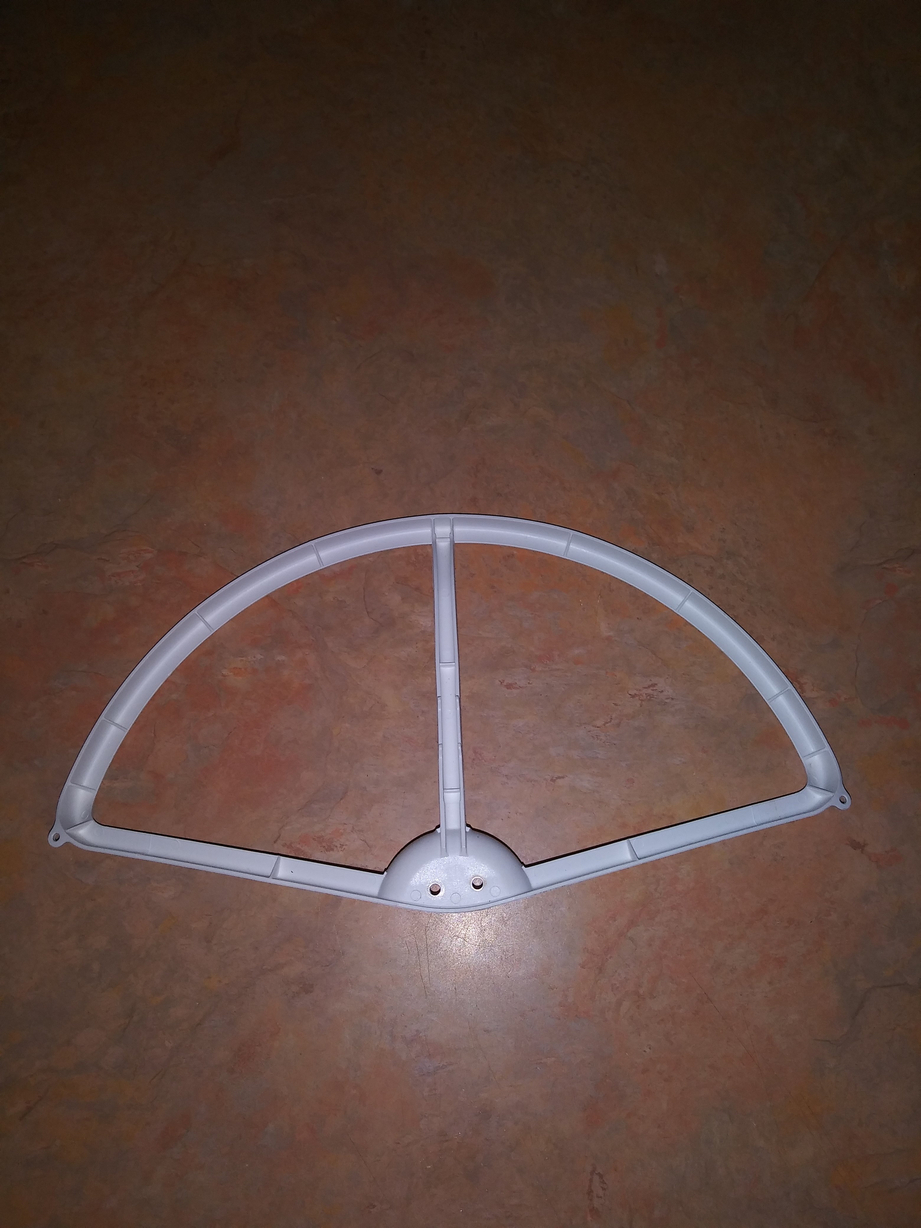

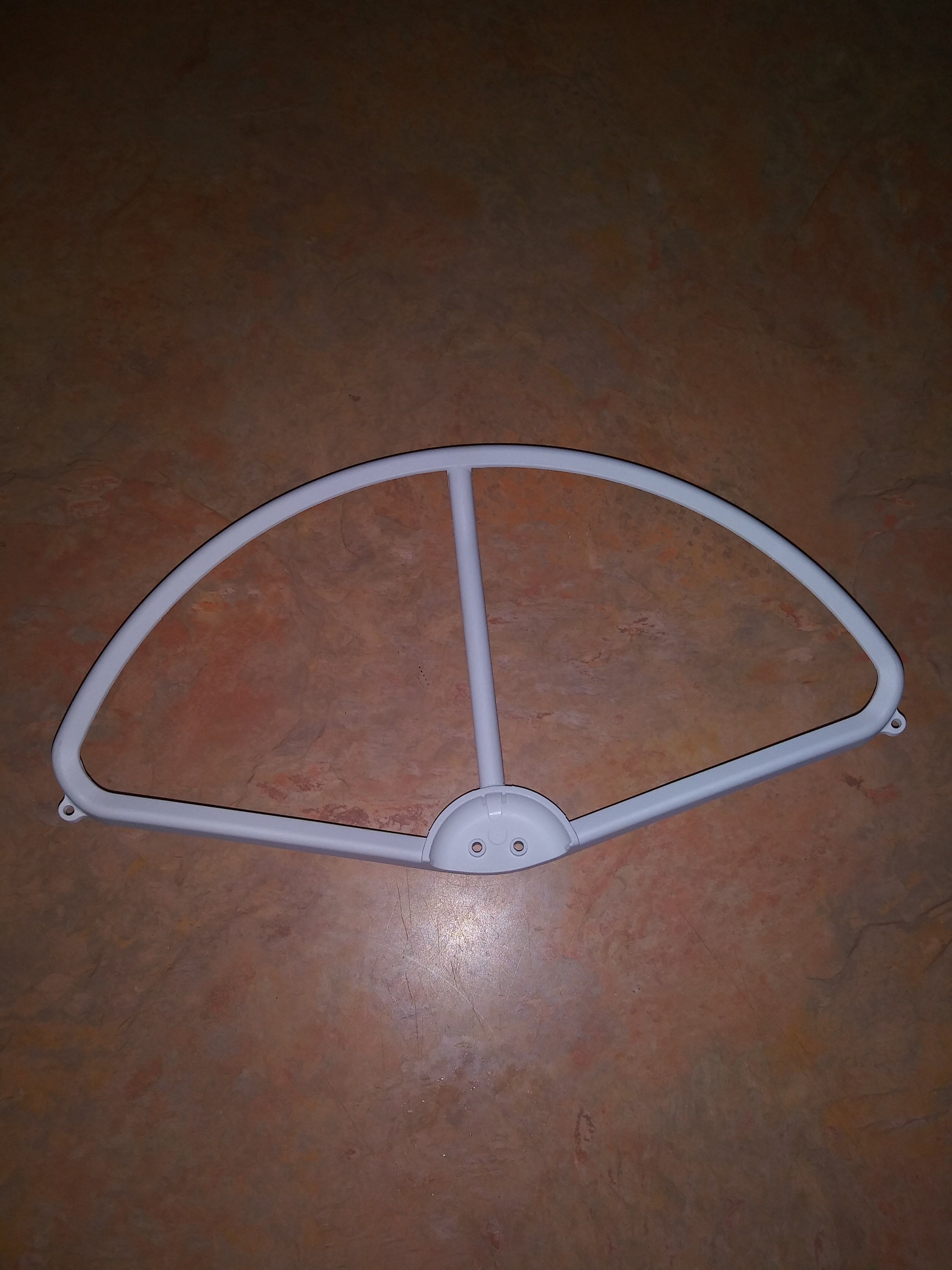

No. Jerry has aftermarket guards. The OP guards are also incorrect. The factory guards for the P3S only has 2 mounting holes. Uses the existing screws already holding the motors to the arms. They do come with slightly longer screws. CAUTION when removing guards to use the ORIGINAL SCREWS or the longer ones will protrude into the motor cavity, destroying the motor. They are, for all intents and purposes, a real PITA to use. This is the correct P3S guard.
