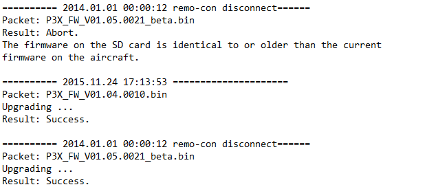

And back to the test version
You need to know that your beta version is considered 1.04.0010.
You need to load the published version 1.05.0030 and then attempt to roll back. Personally, I feel like 1.05.0030 will be the new roll back to version. Meaning it would be the cut-off/low-limit firmware.
Im not getting what you are saying here.
I can try that as well. But was planning to wait till it is actually republished to ensure that I am actually using the what everyone else will be. Just in case they actually do try to slip in a change and not change version numbers. Trying to make it as honest a test as I could.

Listen up everybody! I just done an extensive test with the firmwares. While you can downgrade from 1.5.3 to 1.4.1, you CANNOT downgrade from 1.4.1 to 1.3.2. I don't know if you can downgrade from 1.4 to 1.3.2 if you didn't upgrade to 1.5 first, I wish I had tried that. DO NOT UPGRADE from 1.3.2 if you like it, YOU WILL NOT BE ABLE TO GO BACK!!!!!

Just letting you know from past experience that 1.05.0021 is not a version you should use for the ability to rollback firmware. When we did the beta 1.04.0008 it was the very last version were given to beta test. And both the android and iOS teams had finished with the 1.04.0008 being super rock solid. That version was tweaked to perfection, and the beta project stopped. I personally was so proud of what we had accomplished considering how messed up 1.04.0002 we started with was prior to. Then the day after they published 1.04.0010 firmware which was untested, and the android and iOS users both were having video reception issues as well as other stuff. That for me was a sad day. I loaded the 1.04.0010 because it included something to do with the app displaying one of the new features. In doing that, I then also had the **** video issues. I then tried rolling back to 1.04.0008 and it said I was trying to load the same version. Prior to all this I use to be able to load 1.1.9 FW but was no longer able to. To make a long story short, eventually the 32 channel mod saved me. This all took place with my Nexus 7 2013 version.

My app 2.4.1 iOS. And downgrade from 1.4 to 1.3.2.0. After downgrading when i open the app and connect with drone is says " camera required update and aircraft required update. ". So i didnt want to fly Before ask u.
