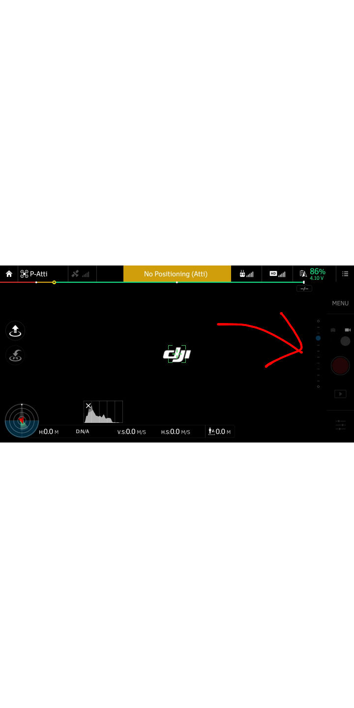

Phantom 3 Pro - Intermittent no video feed problem

So my question is this a hardware or a firmware problem? Will reflashing my gimbal top board or force re install firmware solve my problem? Note that my video feed problem is INTERMITTENT meaning sometimes I get the video feed completely fine and sometimes I don't. On the other hand, there is no AB Log file in my P3P SD card, would appreciate if anyone can share an old enough firmware so that I can use it to copy a new log file from my AC. Your suggestions and advice are very much appreciated

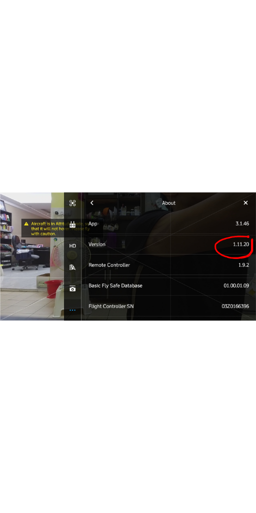

Oso, I powered up my AC this morning and guess what, the AC version shows 1.11.20. Remembered that I took a snapshot of the AC version it was 1.3.20+ I had done absolutely nothing to it somehow it 'changed' to the latest AC version?? I'm confused [emoji53] Should I try to reflash or leave it alone?
