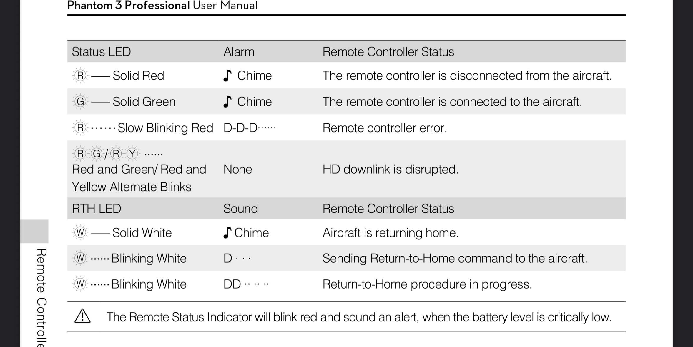

AC has an aircraft status diode, and Radio Link status diode.
RC has a diode which tells link status as well.
Status diodes are identified and explained, of course, in the manual.

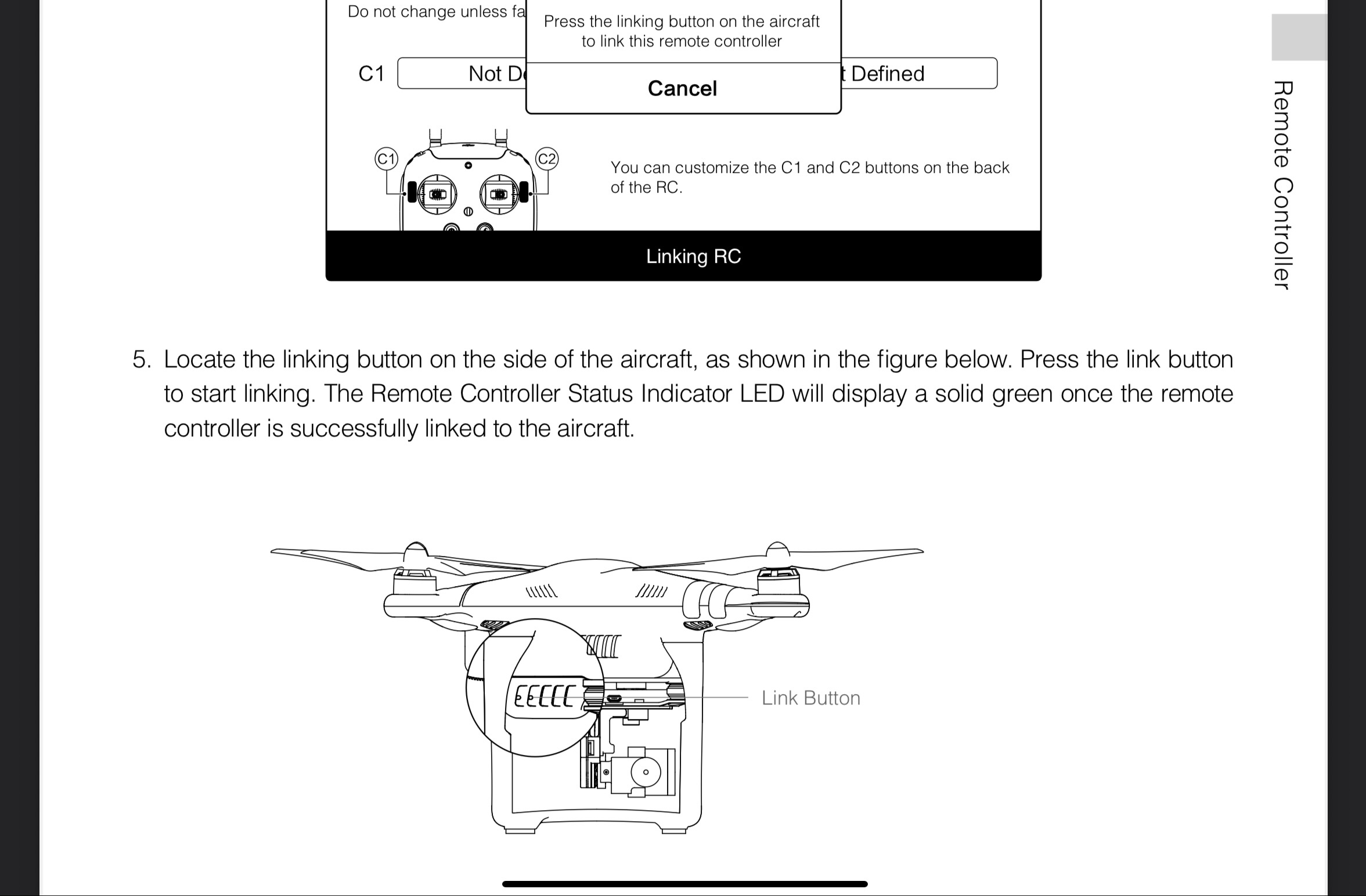

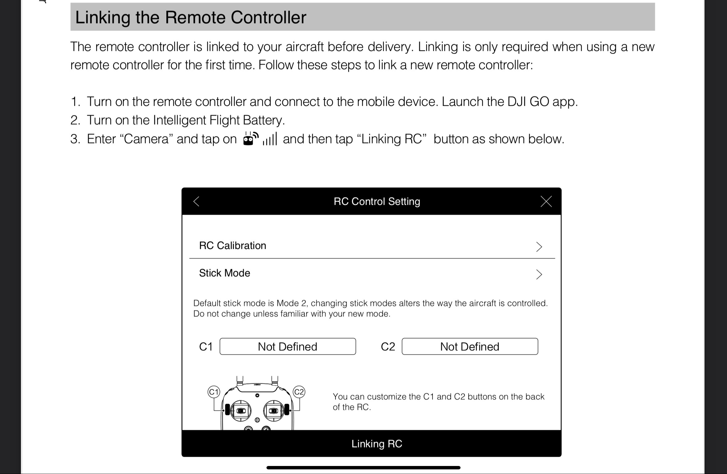

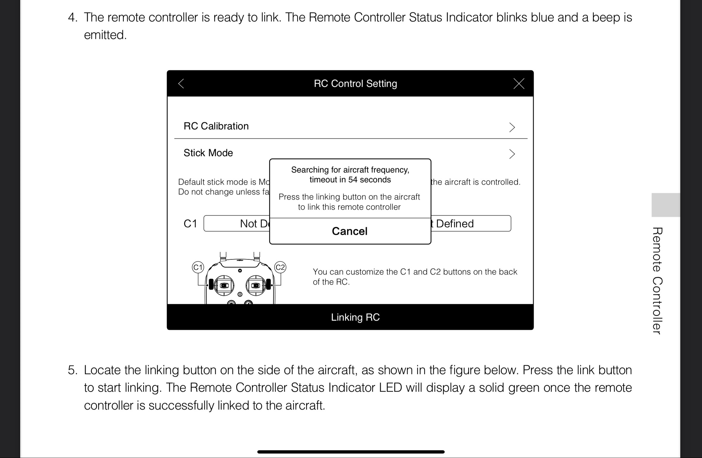

Linking R/C and Aircraft :
*****You can download the manual @quaddamage referred to from 'Phantomhelp.com'. It is free to download. Just be sure to select the correct Drone model from the dropdown menu.
